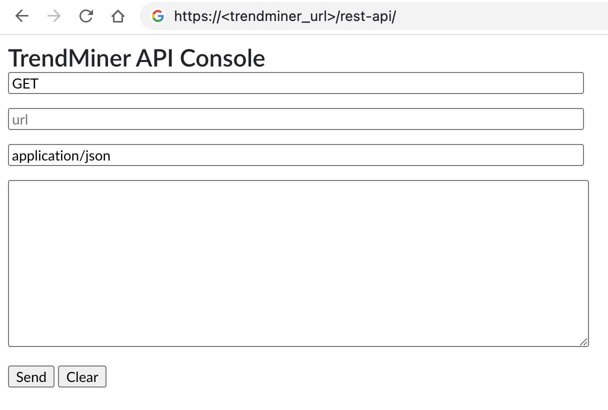

Browse to
https://<trendminer_url>/rest-api

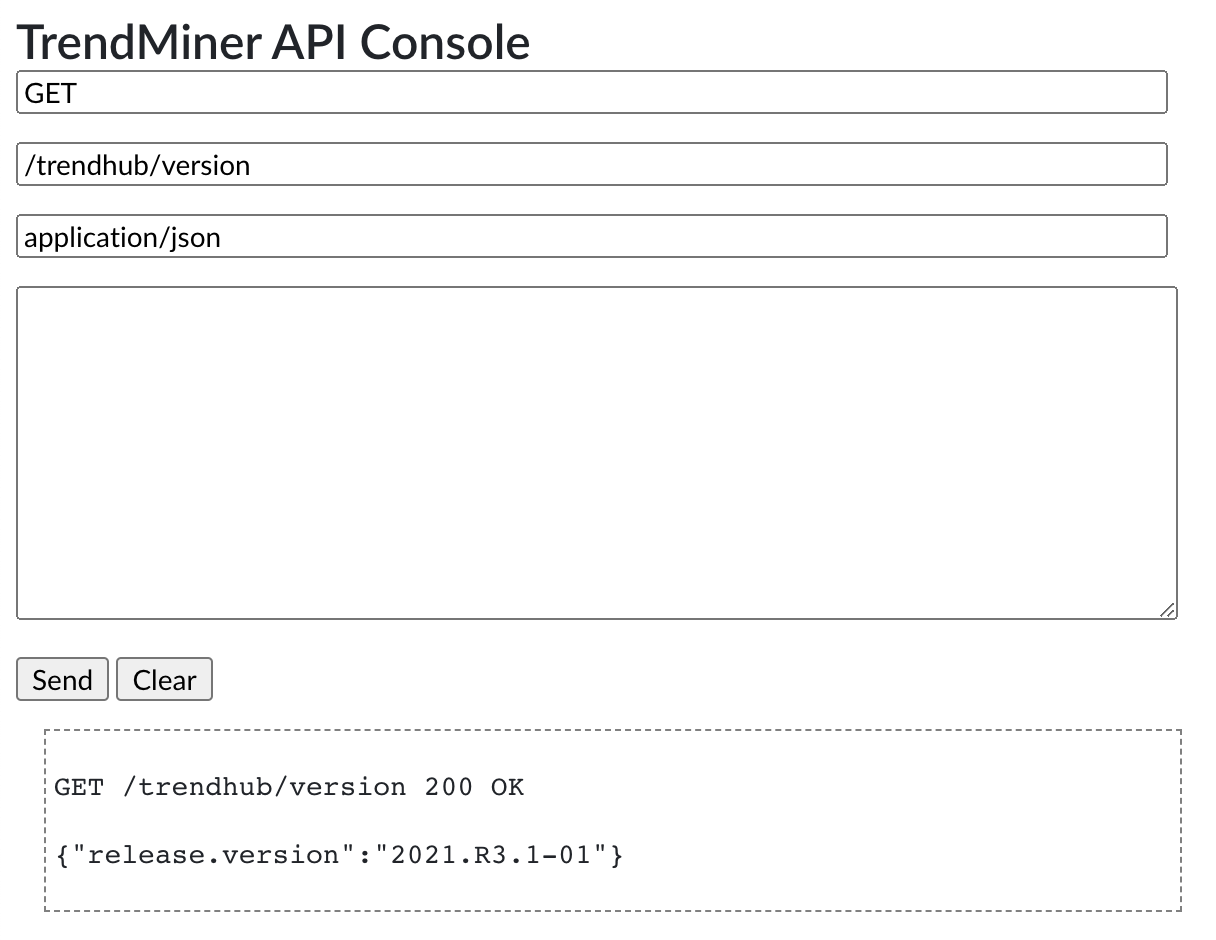

The first input field needs to contain the method: "GET", "PUT", "DELETE", "POST".
The second input field should contain the API endpoint. For example /trendhub/version
The third input field specifies the content type of the calls, in most cases "application/json"
The fourth input field is a multiline input and is only needed for "POST" and "PUT" calls. For POST and PUT calls this field contains the data to send along as input (in json format). For more details we refer to individual articles or the developer api documentation.
