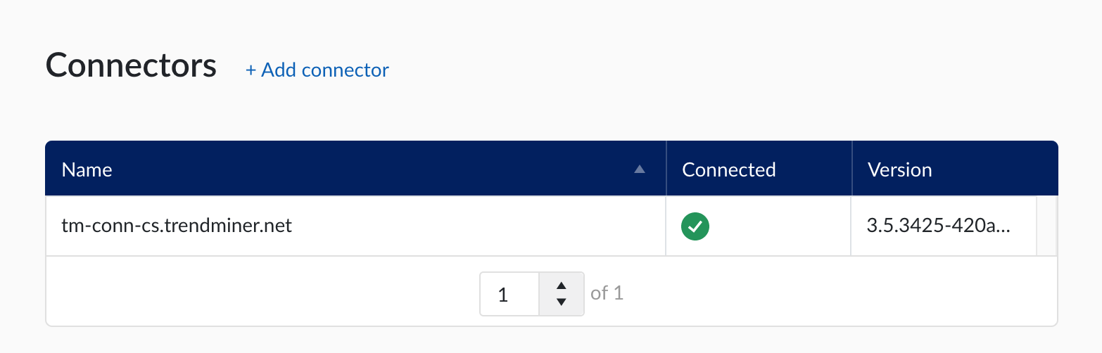

Which version your connector returns is up to you. You can use the versioning to keep track of your connector updates. TrendMiner only uses this information to display in ConfigHub. After this endpoint is implemented you can add your connector to TrendMiner via ConfigHub (check the user documentation to find out how).
If your connector is added successfully, the version will be shown in ConfigHub and you are ready for the next step.

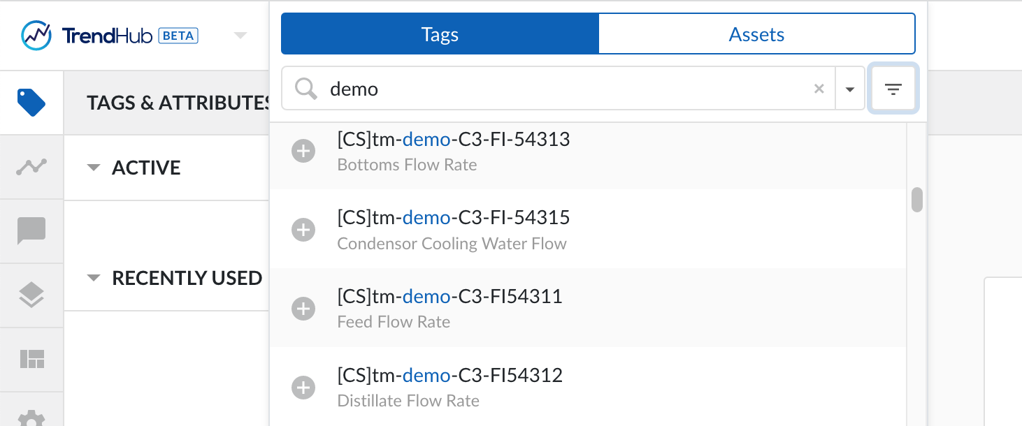

When this endpoint is implemented, you'll need to make sure your user has access to this data source before you can find the tags from the data source in TrendMiner. This article describes how you can assign the right permissions.
Also make sure to sync the data source to TrendMiner to make sure the tag list is updated.
Once the right permissions are assigned, log in to TrendHub and you should be able to search your tag names and descriptions in the tag browser. If this looks ok, you're ready for the next step.
