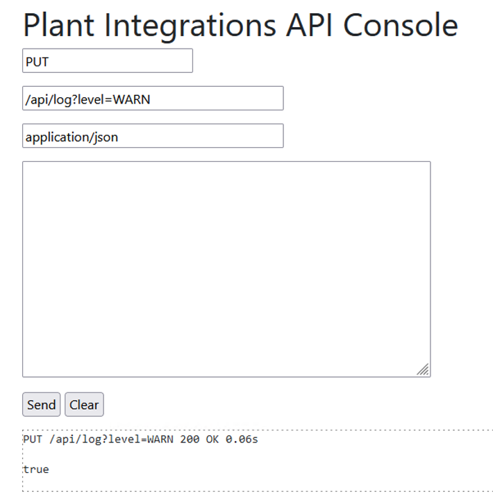

Changing the log level can be done by doing a PUT on the connector API console at the /api/log endpoint.
e.g: PUT /api/log?level=WARN

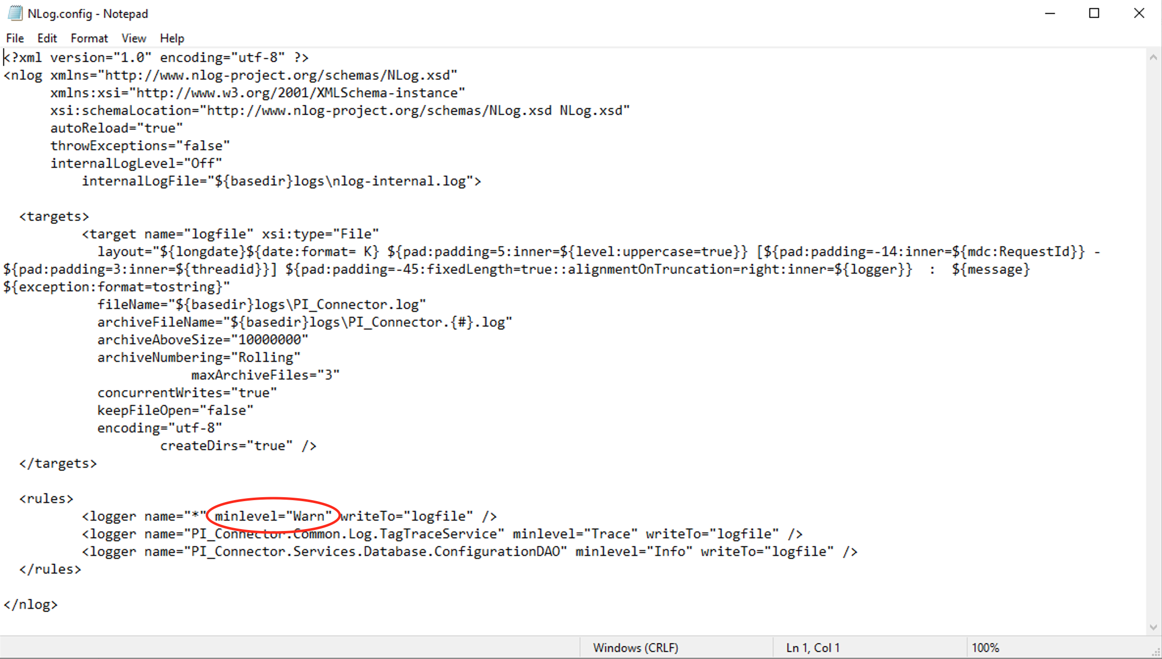

Whenever the connection pool is restarted the default log level is restored. The default log level can be changed by updating the NLog.config file which you can find in the connector directory (e.g. C:\inetpub\<your-connector-directory>)
