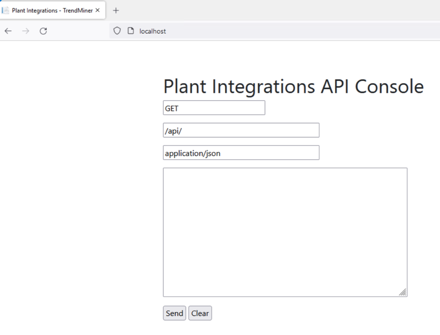

The connector API console is the user interface for the TrendMiner connector. A number of queries can be run here to retrieve or set specific information related to the connector and datasource settings. We will go deeper into this via below topics.
How to reach the API console?
  • Option 1: On the Windows IIS server (the connector server), browse to http://localhost:portnumber or just http://localhost in case the connector is running on default port 80.

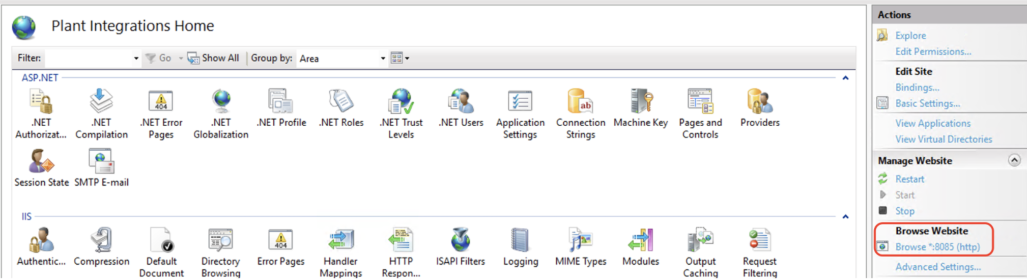

  • Option 2: In the IIS manager, by clicking on the Plant Integrations site and browsing website
