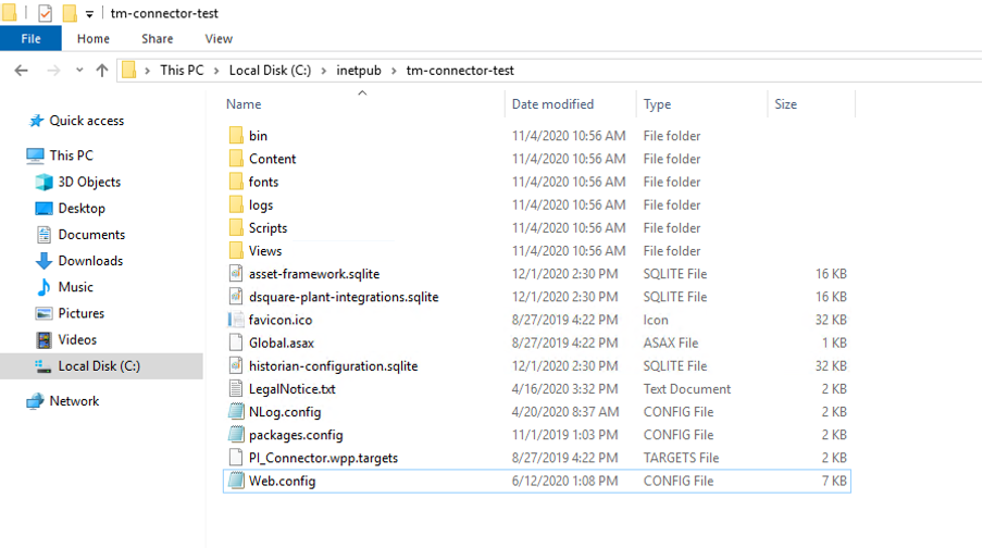

  2. Before starting the upgrade, make a copy of your Plant Integration folder as a backup. This folder is usually located at C:\inetpub\PlantIntegrations.
    When a connector backup needs to be restored, only copy the files within the main directory (e.g. "PlantIntegrations"). Never overwrite the directory itself. Overwriting the directory will clear all configured permissions on the directory which will prevent you from updating data sources or making changes to configuration from the TrendMiner application.

  11. Restore the old connector configuration by opening the new Web.config and the old Web.config from the backup folder with a text editor and comparing the settings. Any overridden settings should be manually updated in the new Web.config.
