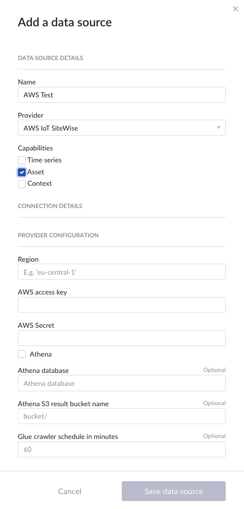

Asset capability
With this capability enabled the datasource can pull assets from AWS IoT SiteWise to be synced into a TrendMiner asset structure.
Following properties need to be populated:
  • “Provider” - select the option AWS IoT SiteWise from the dropdown.
  • “Capabilities” - the AWS IoT SiteWise provider supports the Asset, Time series and Context capabilities.
  • "Region" – enter the availability zone region within AWS cloud in which the AWS IoT SiteWise instance is configured. For more information, please consult the AWS documentation.
  • "AWS access key" – enter the access key to authenticate. The AWS access key as generated in AWS IAM. For more information, please consult the AWS documentation.
  • "AWS Secret" – enter the secret to authenticate. The AWS secret as generated in AWS IAM. For more information, please consult the AWS documentation.
  • “Athena”
    • if the Athena option is not enabled, the provider will ingest hot tier data only, using the AWS IoT SiteWise REST API.
    • if the Athena option is enabled the provider will ingest also cold tier data using Athena queries.
  • “Athena database” - the name of the Athena database. For more information, please consult the AWS documentation.
  • “Athena S3 result bucket name” - Athena query results are stored after execution in a S3 result bucket. Specify here the name of the bucket. For more information, please consult the AWS documentation.
  • “Glue crawler schedule in minutes” - value of Glue crawler interval in minutes. For more information, please consult AWS documentation.

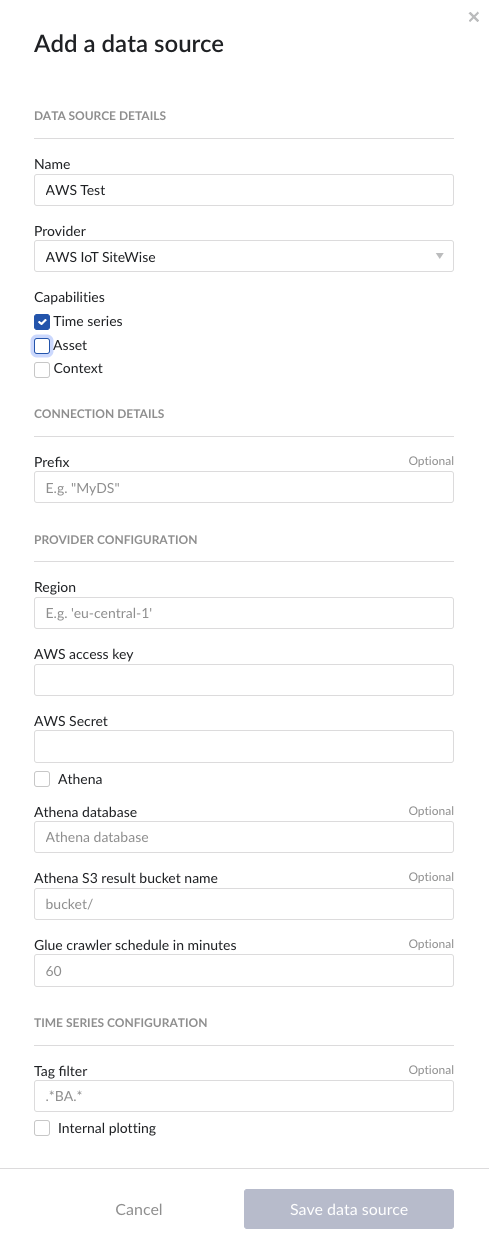

Time series capability
With this capability enabled the datasource can sync Metrics, Transforms and Measurements from AWS IoT SiteWise into TrendMiner tags.
  • “Athena”

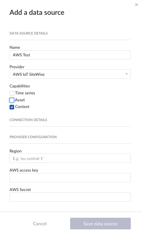

Context capability
With this capability enabled the datasource can sync Alarms from IoT SiteWise into TrendMiner context items.

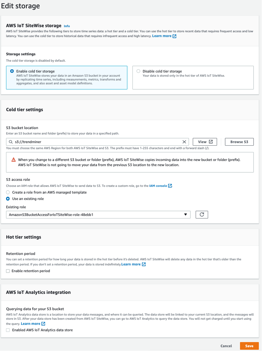

  2. To be able to read data from S3, the AWS IoT SiteWise storage needs to be enabled with the following configuration:
    • Left menu → Settings → Storage → Edit storage.

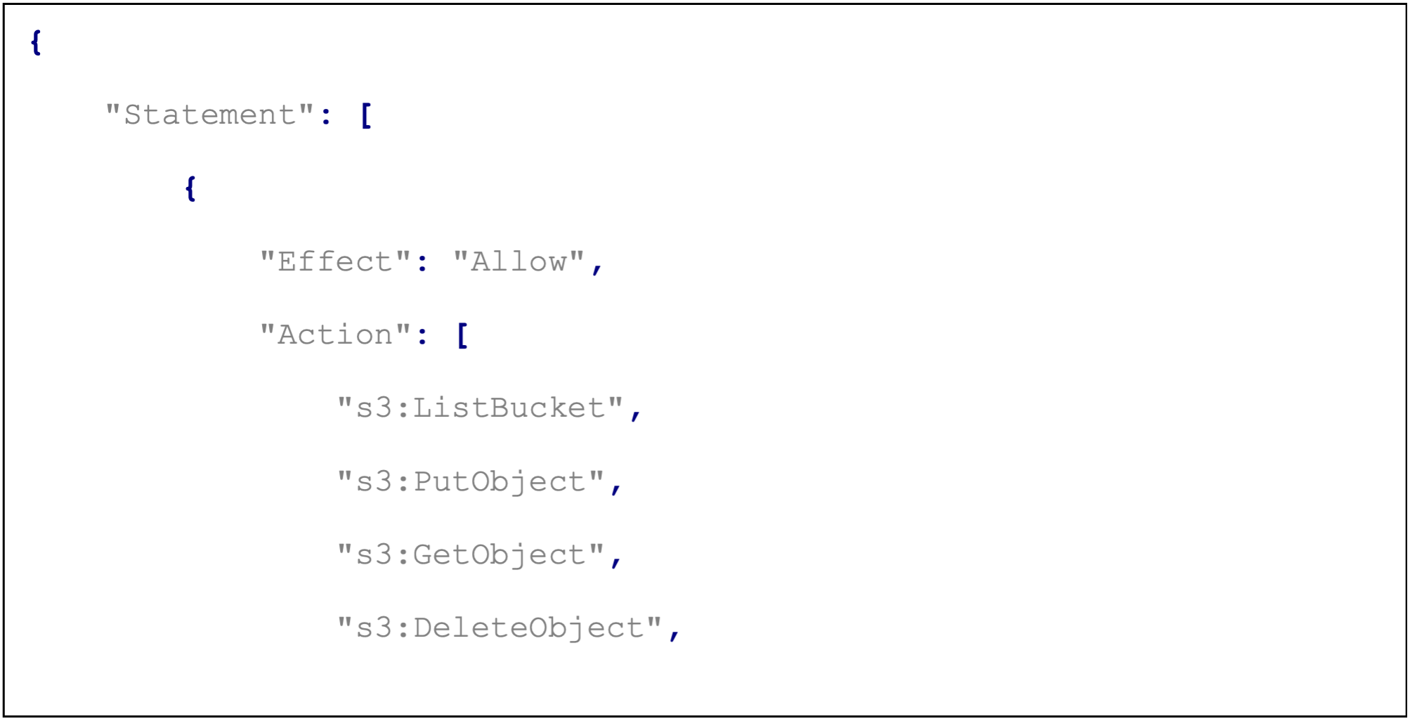

    • The creation of the role needs the following policies. Pay attention at the bucket name: "arn:aws:s3:::trendminer"
    • Refer to the AWS documentation on configuring storage settings.

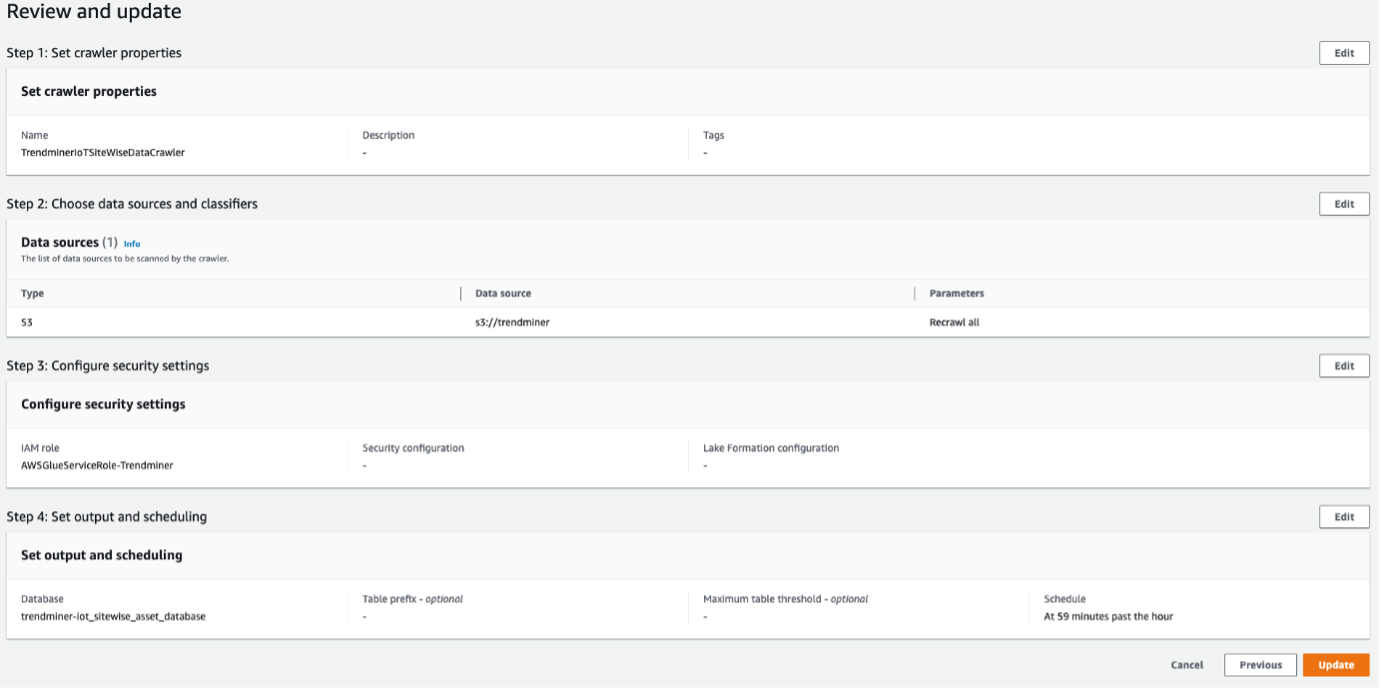

  4. Configuring a crawler:
    • Example configuration.
    • Once the configuration is done, you need to manually Run the crawler. This process might take several minutes, so you should wait until the state becomes Ready.
    • You can refer to the AWS Documentation on creating a Glue crawler.

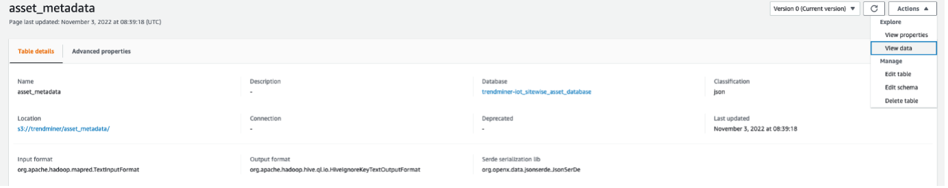

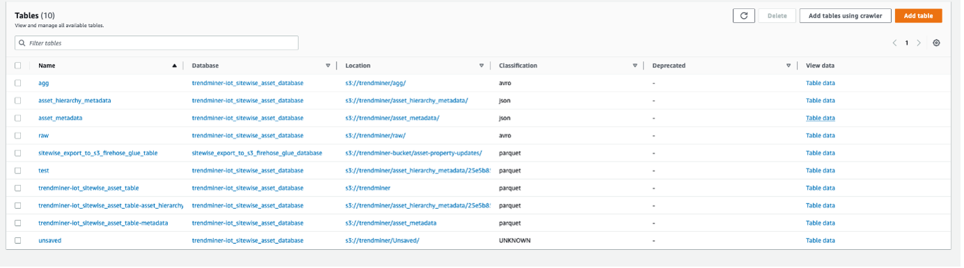

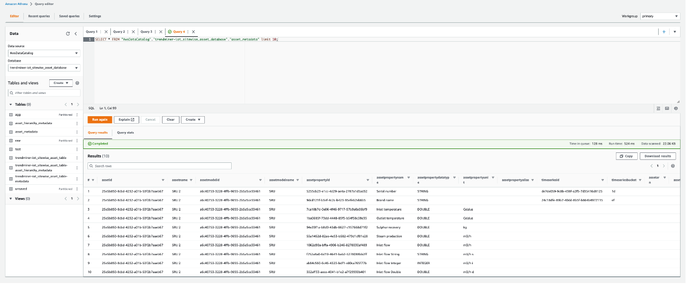

  5. Once your crawler status is Ready, you can query your data:
    • In the navigation pane Data Catalog → Databases → Tables → asset_metadata table of your database and click on the Table data link (more information on how crawlers work - here).
    • Select the table and continue.
    • A confirmation pop-up appears. By clicking Proceed you will be automatically redirected to AWS Athena.

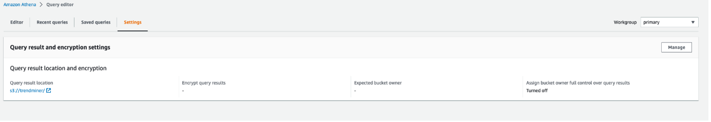

  6. Once your crawler runs successfully, you are redirected to AWS Athena:
    • Provide a configuration about the Query result location.
    • Provide your S3 bucket location.
    • A query can be executed now.
    • Refer to the AWS Documentation on how to query data with Athena.
