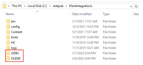

  1. First step is to browse to the Plant Integration folder you have created during installation. This folder will most likely reside inside the inetpub folder on the c drive of your connector server, which is the default location:
    c:/inetpub/PlantIntegrations

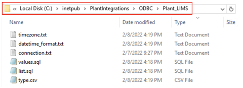

  2. Create a folder (not case sensitive) that will host all your ODBC/OLEDB/SQLite configuration files. All configuration files for ODBC connections will go into the ODBC folder, for OLEDB connections into the OLEDB folder and so on.
  3. Create a subfolder for each data source you want to configure inside the correct ODBC/OLEDB/SQLite folder, depending on which connection type you are using. In the following example we will configure an ODBC data source called “Plant_LIMS”, so we create the "Plant_LIMS" subfolder in the recently created "ODBC" folder.
Create Configuration files
  • Create the following configuration files needed to configure the generic data sources.

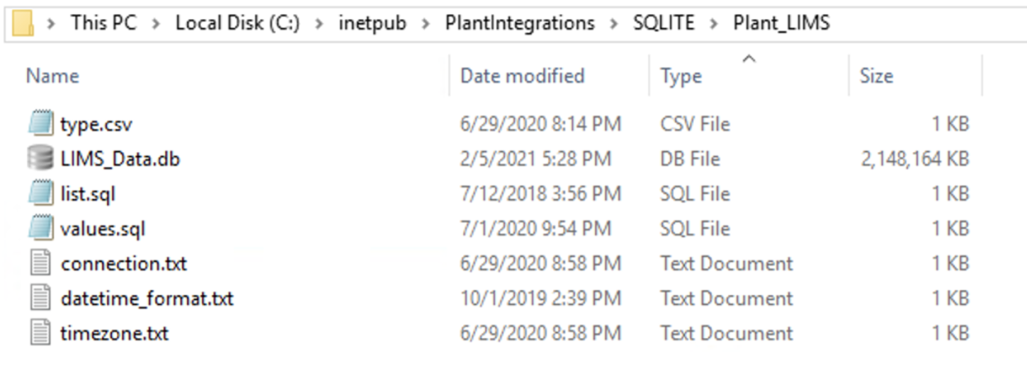

    sqlite.db (only for SQLite)
    Required
    connection.txt
    Required
    list.sql
    Required
    values.sql
    Required
    values-STRING.sql
    Query select statement that returns the timestamps and values for a given string tag. Only include if necessary. If any string tags aren’t in the same database you could use the query here or decide to join with your values.sql query.
    Optional
    type.csv
    Required
    datetime_format.txt
    Optional
    timezone.txt
    Optional

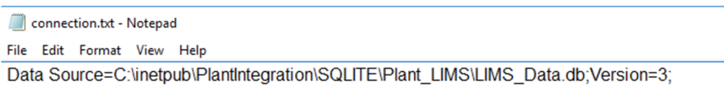

Connection.txt file
ODBC example:
OLEDB example:
SQLite example:

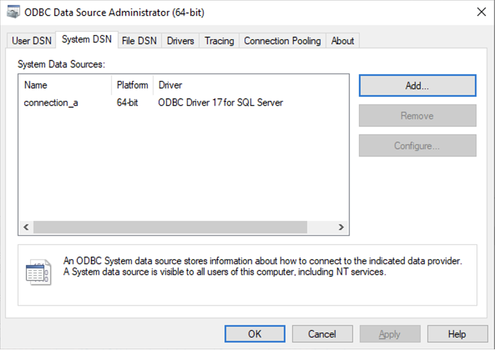

  1. Set up a new System Data Source using the corresponding SQL Server driver.
  2. Once the System Data Source is configured, create a “connection.txt” file and make reference to the System Data Source as shown below.
https://docs.microsoft.com/en-us/sql/integration-services/import-export-data/connect-to-an-odbc-data-source-sql-server-import-and-export-wizard?view=sql-server-ver15#odbc_connstring

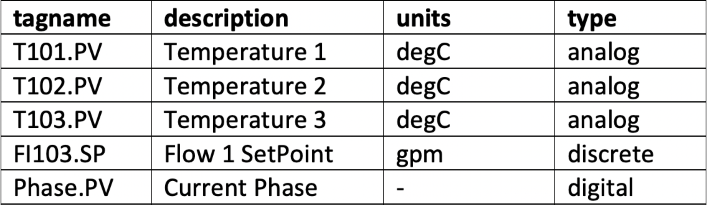

  1. The first step is a query that will return unique tagnames (to identify the time series), its datatype, and optional metadata such as description and units. This query goes into the list.sql file.

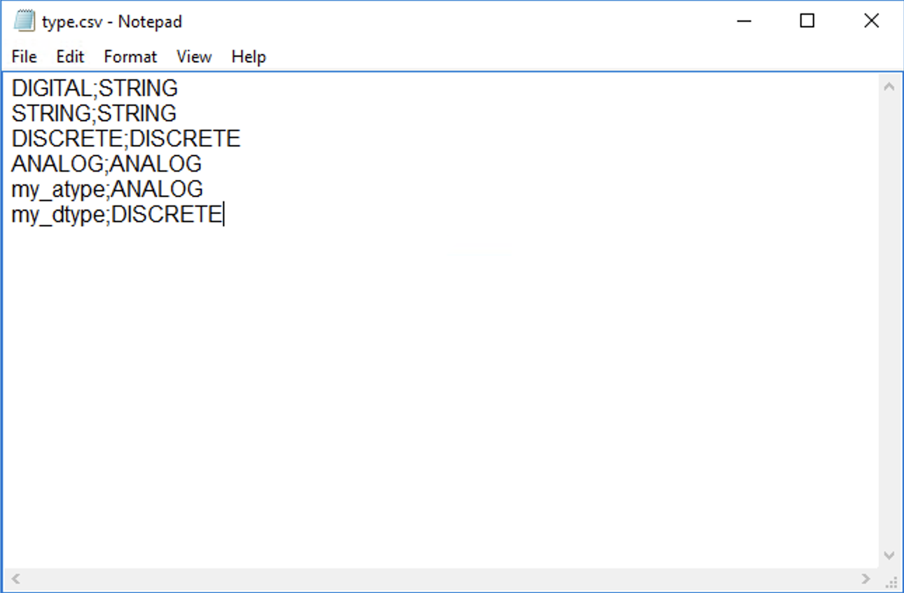

  3. The third step is to map any custom datatypes to the TrendMiner datatypes. This mapping goes into the type.csv file.

SELECT
    tagname, description, units, "analog" as type
FROM Table_1

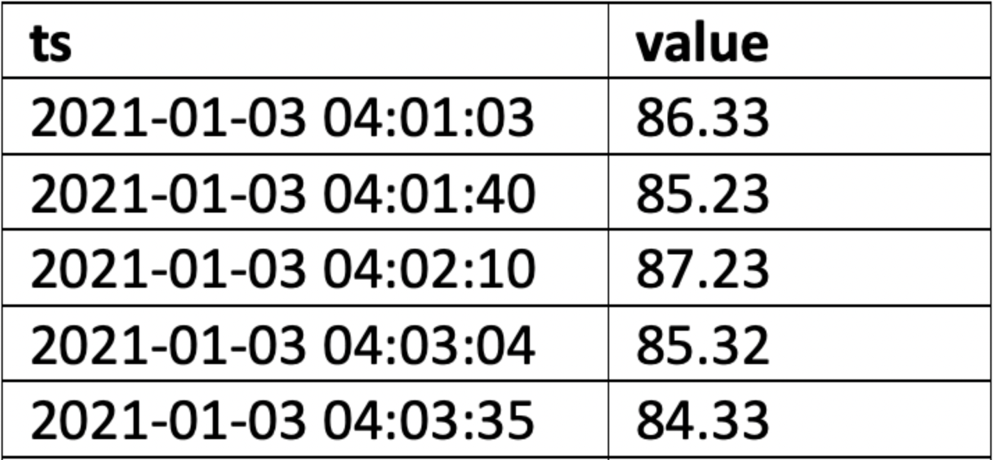

values.sql query
  • The columns returned should be named "ts" (for the timestamp) and "value". Timestamps should be in ascending chronological order, meaning oldest first, newest last.
  • All timestamps that are returned should fall inside the requested time interval. If they don't, then indexing will fail later on.
  • The complete response should be returned within a reasonable timeframe. Typically recommended is +- 1 second per month of data, with user experience noticeably dropping off when response time exceeds 5 seconds per month of data. The response time can be influenced somewhat by tweaking settings such as the index granularity in ConfigHub, although a slow datasource will always lead to bottlenecks, no matter the settings. Check the user documentation for more info.
  • An acceptable amount of data points within the given timeframe. The number of data points returned can be influenced by tweaking the query, or by tweaking settings such as the index granularity setting in ConfigHub. Check the user documentation for more info.
SELECT
    ts, value
FROM Table_1  
WHERE tagname = ? AND ts IS BETWEEN ? AND ? ORDER BY ts ASC

In the type.csv file, create one line per data type, with the output of the list.sql types as the first value, followed by a semicolon (";"), followed by one of the supported datatypes in TrendMiner. The example below ensures the results are returned in the right case, and a string result is explicitly returned as a DIGITAL result.

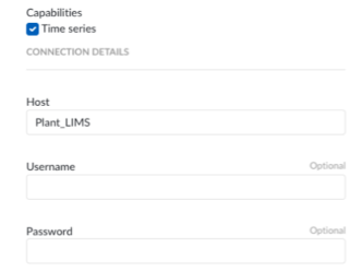

  • The “Host” name shall be the name of the folder previously created containing all the configuration files as in the example below. The data source name is free to choose.
  • TrendMiner will consider the username and password provided in the “connection.txt” file and not the one provided through the interface. You do not need to provide the username and password here.
