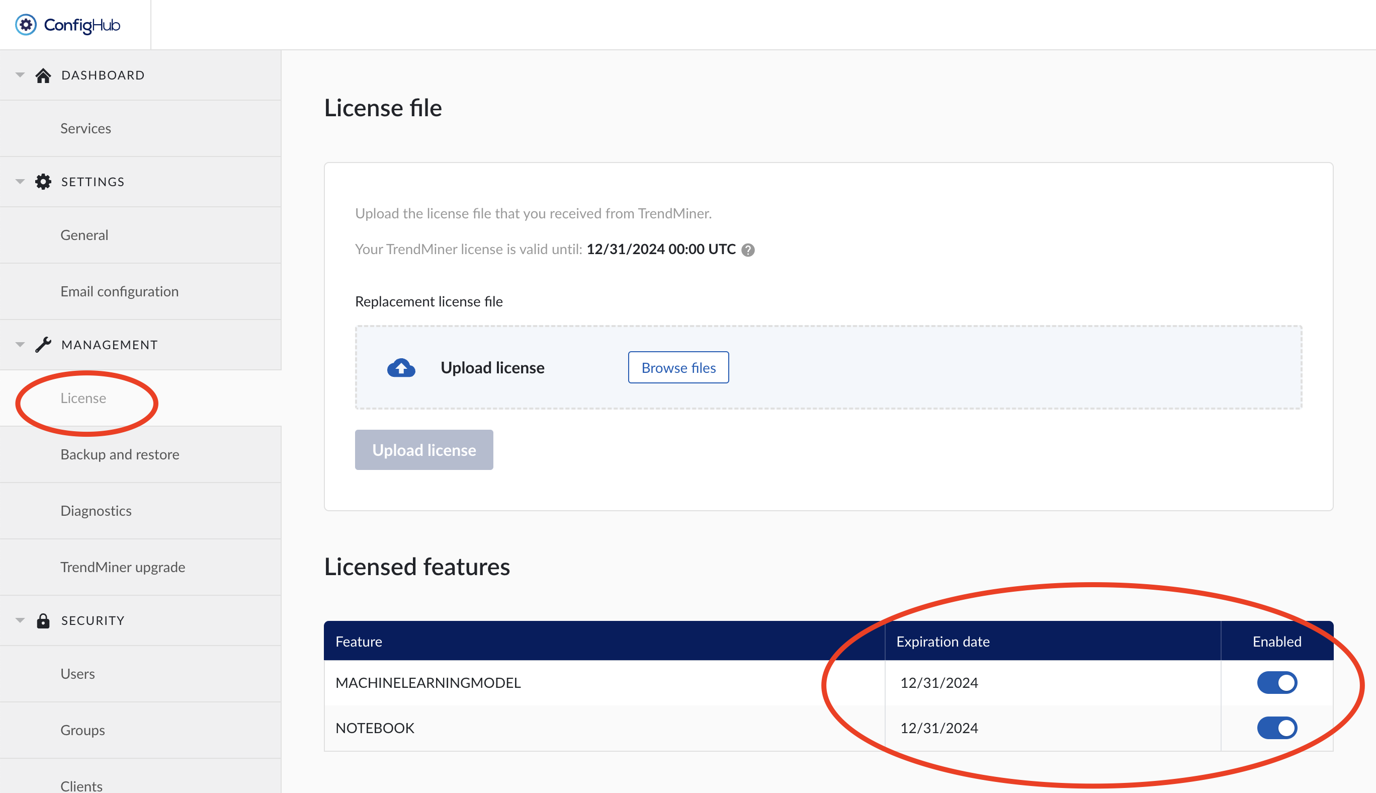

The following prerequisites only apply to customers who are using notebooks or used notebooks in the past and wish to keep their notebooks after the upgrade:
  • I have a valid notebook and machine learning model licenses and the respective services are enabled.
    To verify this please open the ConfigHub -> License menu.
