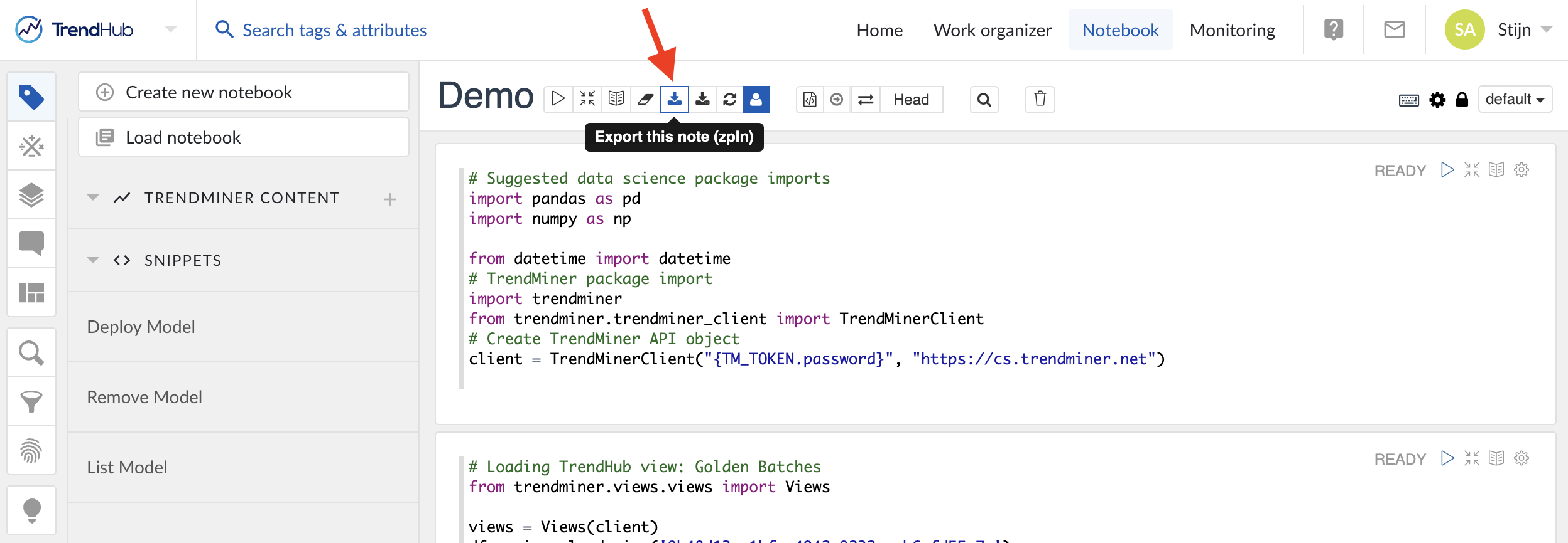

  • Download all the Zeppelin notebooks which you would want to migrate and save them locally. Note that all notebooks need to be exported one by one. There is no bulk export available.
