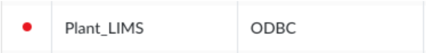

Unable to establish connection with data source
Issue: the connection status of the ODBC data source shows a red dot
Solution:
