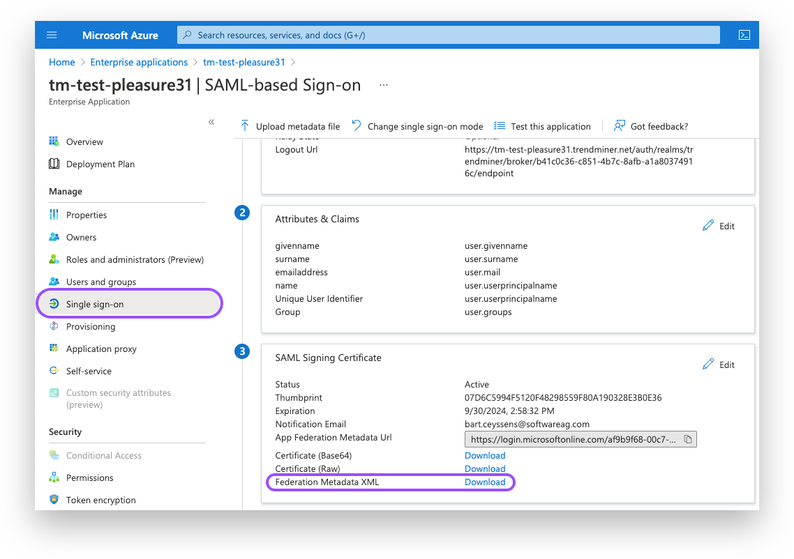

  1. Navigate in Azure AD to your SAML application, and open the Single Sign-on section.
  2. In the upper section, "Basic SAML Configuration", leave placeholders for the required fields like Entity ID. These values will be overwritten in later steps when the metadata file from TrendMiner is imported back into Azure AD.
  3. Download the Federation Metadata XML. This file will be used to upload in TrendMiner ConfigHub in later steps.

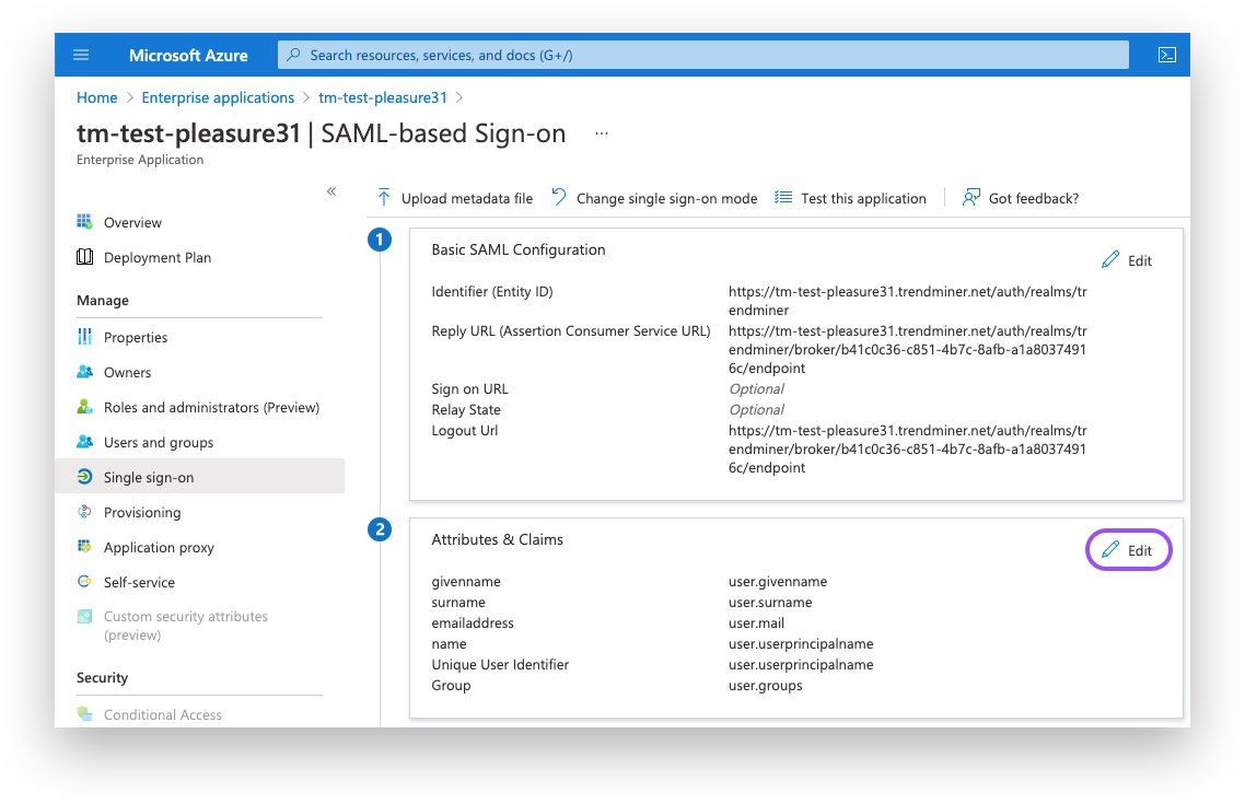

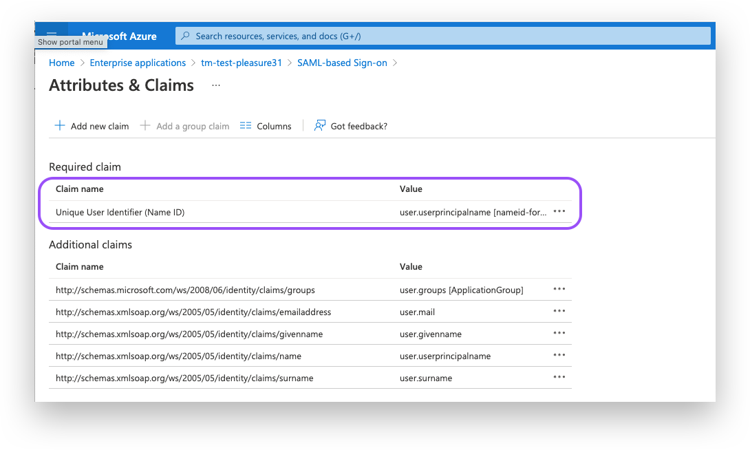

  4. Configure user attributes & claims. This enables the automatic creation of user profiles, including the user name they will be identified with in TrendMiner.
    1. Click the "Edit"-button under "User Attributes & Claims"

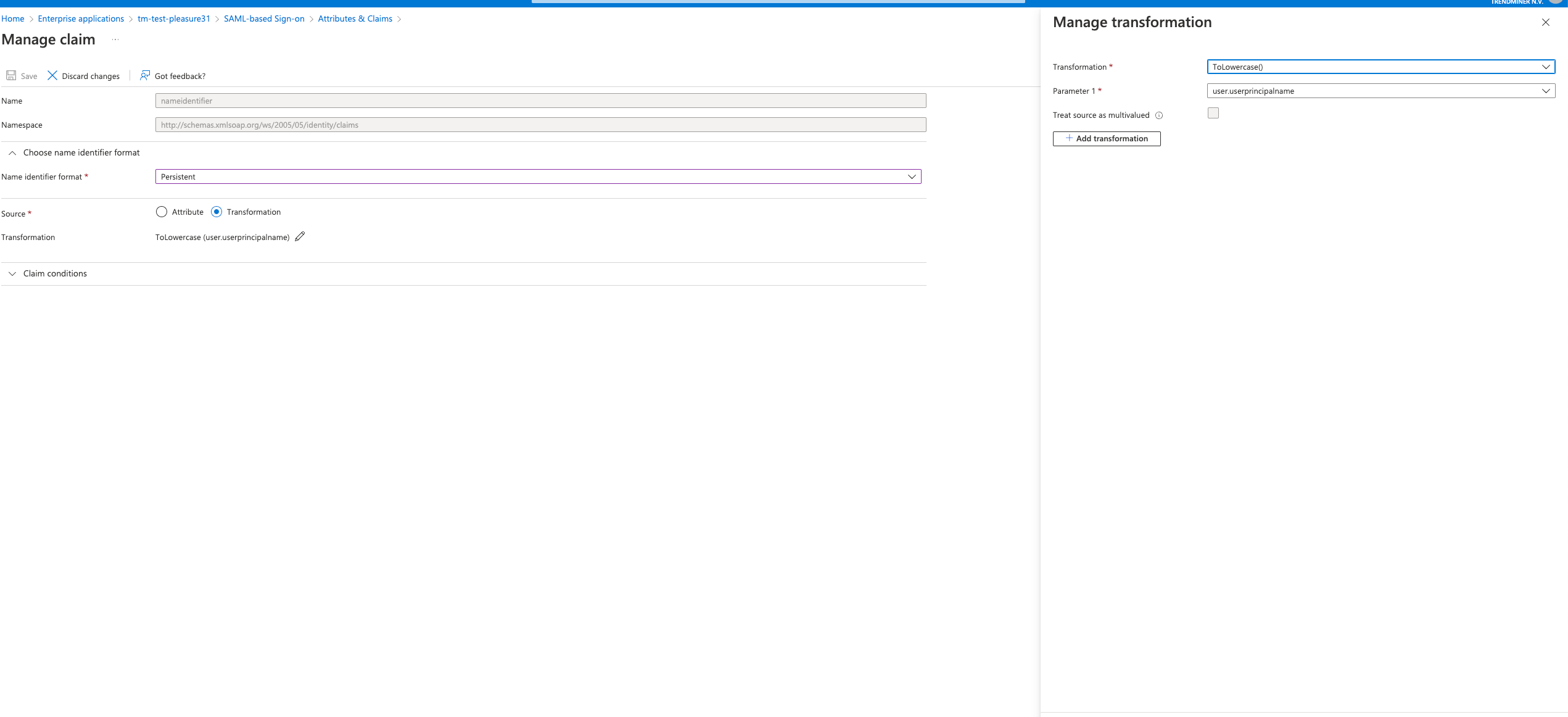

    2. Click on the "Unique User Identifier (Name ID)" option.
    3. Ensure the “Name identifier format” is set to a format of your choice. Note that the source attribute "user.userprincipalname" refers to the email in Azure. Under "Source" select ''Transformation" and add the "ToLowercase()" transformation for the "user.userprincipalname" as shown in the screenshot below.
      Azure AD - Name Identifier Format

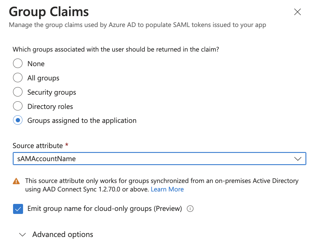

  5. Configure groups. This helps you leverage existing group memberships to set access rights to data sources automatically.

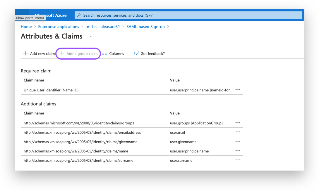

    2. Click the "Add a group claim"-option.
    3. Set the Group Claims as desired. An example is shown in the screenshot below; this needs to be adjusted to fit your preferences:
      • Associated groups to be returned in the claim: to avoid clutter, the recommendation is to select "Groups assigned to the application".
      • Source attribute: Select your preference according to the Azure AD documentation. In most cases, either sAMAccountName (for groups that are synchronized from an on-premise Active Directory setup into Azure AD) or Group names for cloud-only groups (for groups that were created directly in Azure AD) will be desired, as these return human-readable names that can be used in TrendMiner's ConfigHub.

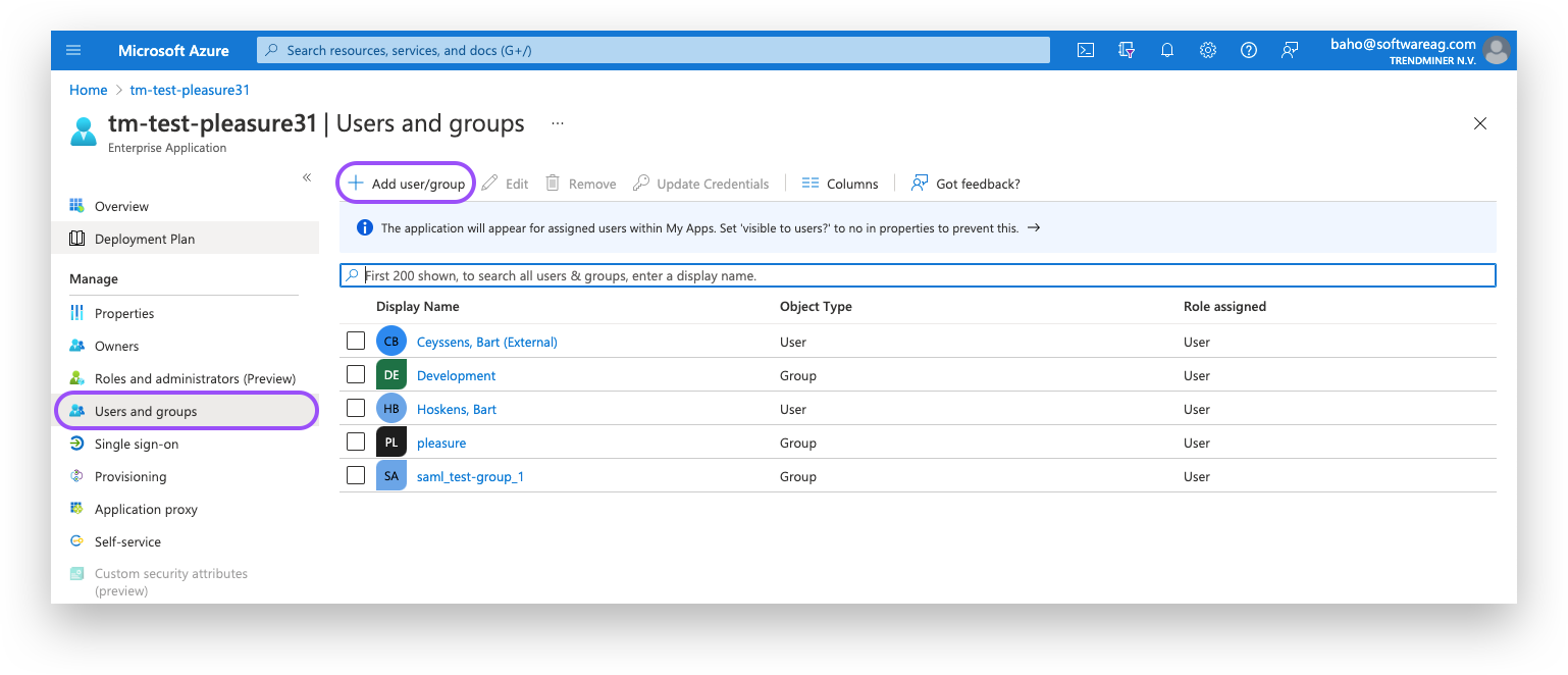

  6. Add users/groups to the application. This enables the admin to provide explicit access only to those users and groups that should be able to use TrendMiner, according to the provisioned license capacity for named users.
    1. Navigate to "the Users and Groups" tab.
    2. Click the Add "user/group" button and add users/groups.
  3. Select the SAML option.

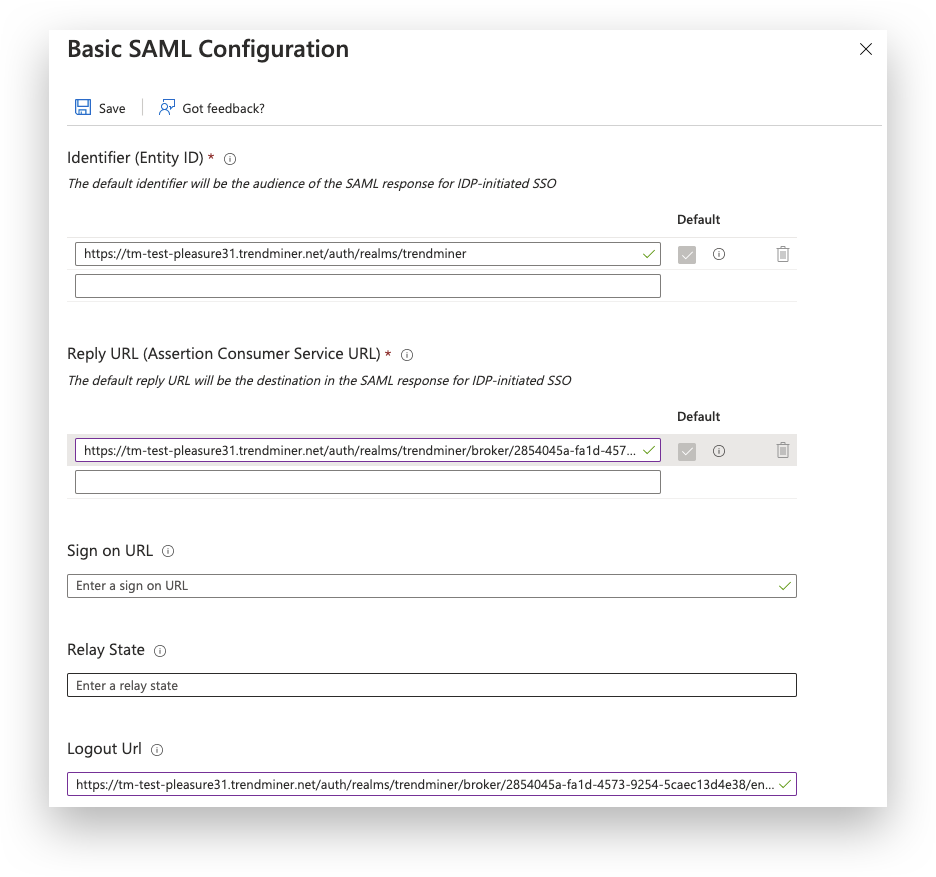

Now that we have the metadata file from TrendMiner (as generated in the previous step), we can proceed with finalizing the configuration on the IdP side.

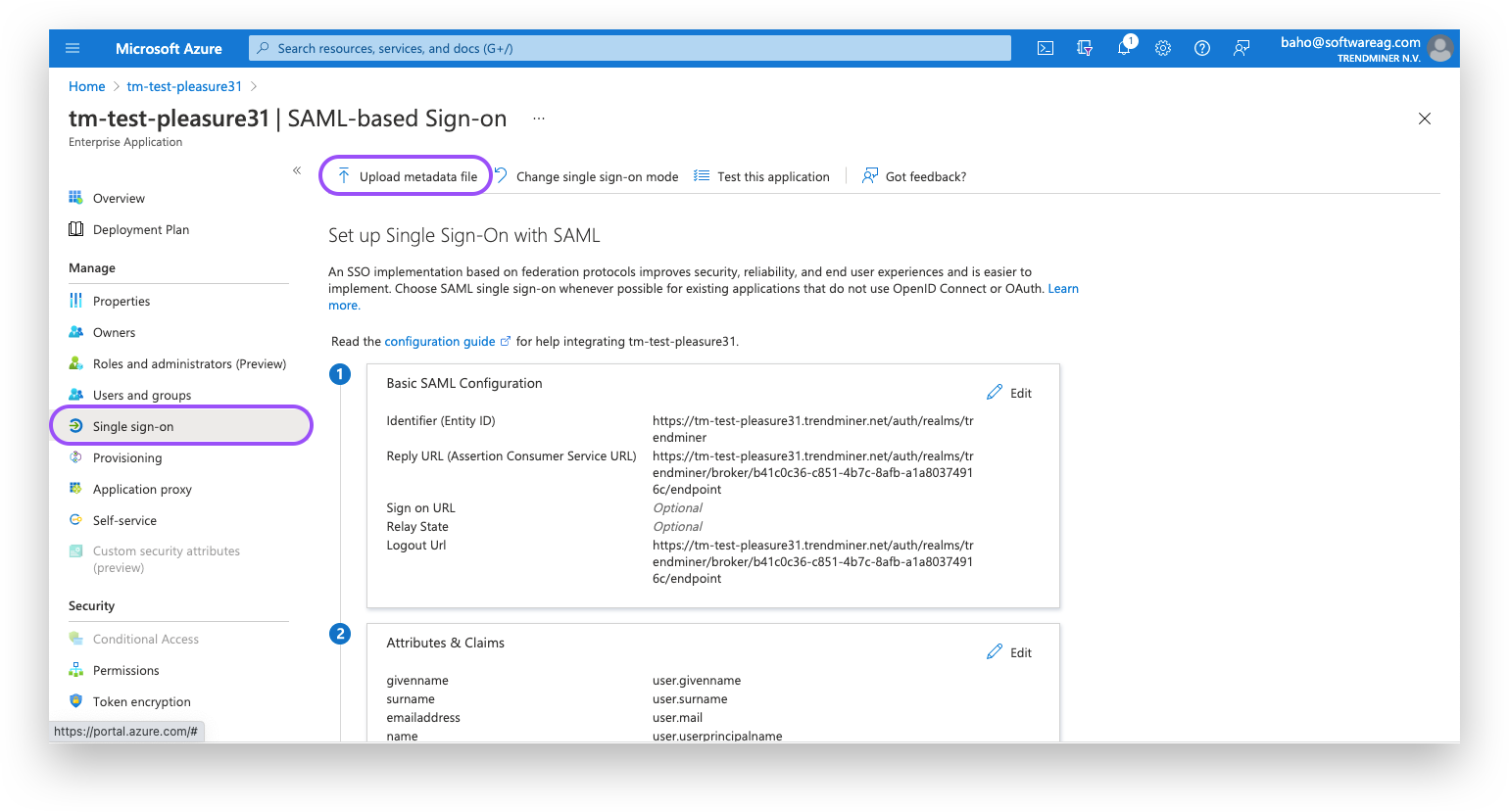

  1. Navigate in Azure AD to your SAML application and open the "Single sign-on"-tab.
  2. Click the "Upload metadata file" and upload the TrendMiner metadata file. This will fill out the required information where we placed placeholders in the first step.
  3. Check the entries - It might be necessary to fill in the Reply URL yourself. This is the same value as Logout URL.
  4. The SAML setup is complete and you should be able to login in TrendMiner. After logging in with a SAML user in TrendMiner the assigned groups should be synced and ACLs can be configured.
