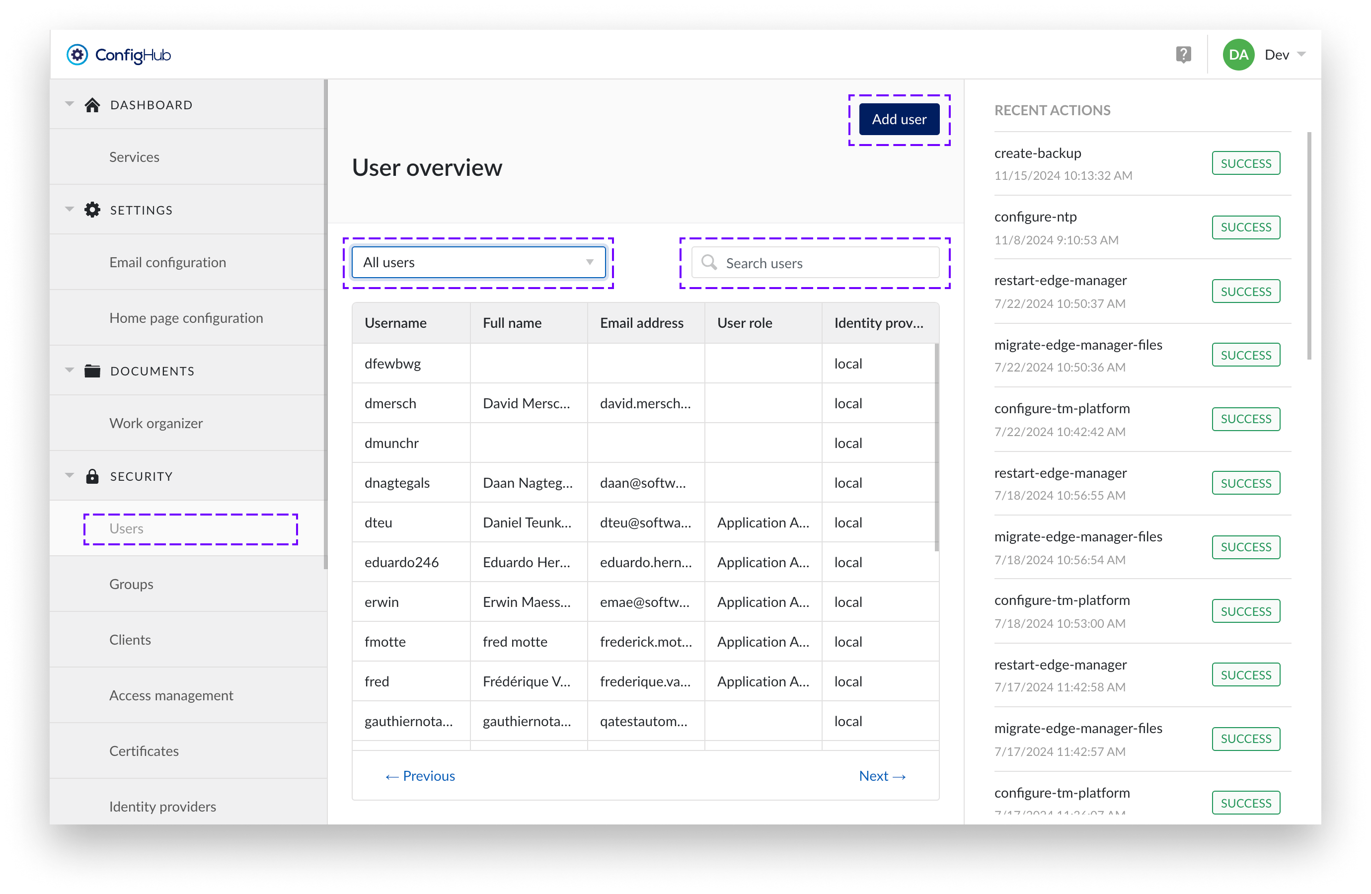

Users
TrendMiner users can either exist locally or via an external Identity Provider. An overview of all users can be found under the "Security" section in ConfigHub.
The user overview displays the username, full name, email address, and identity provider for each user. To find specific users, you can use the search bar. There is also a User Role dropdown filter for narrowing down the list based on roles. It is important to note that you cannot use the search bar and the dropdown filter at the same time.

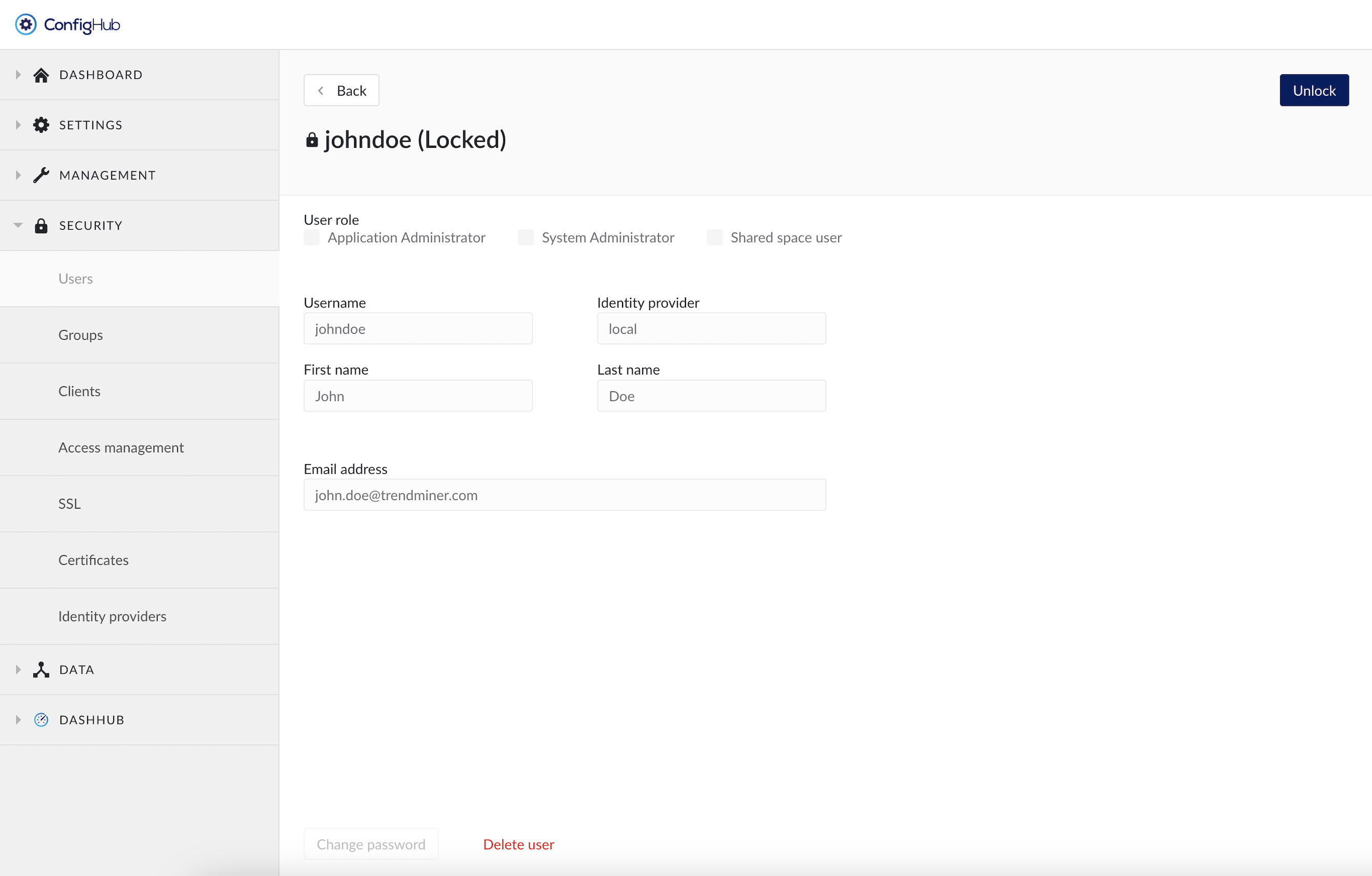

Unlock user account
A user account is automatically locked after 3 login attempts using the wrong password (both for local accounts as for LDAP accounts). The user itself will not be able to see the difference between entering a wrong password or the access being denied because of a locked account. In both cases a generic error message is shown on the login page: "Invalid username, password or locked account". This is by design for security reasons.
Only users with the system administrator role can access ConfigHub and look up the user account to check if the account is indeed locked. A locked account can be recognized as follows:
  • A little lock icon in front and the word "Locked" behind the username
  • An "Unlock" button in the top right
  • No option to edit the user details or change the password as long as the account is locked
confighub users user details locked 2024.R1.0
To unlock a user account simply click the "Unlock" button on the top right.
