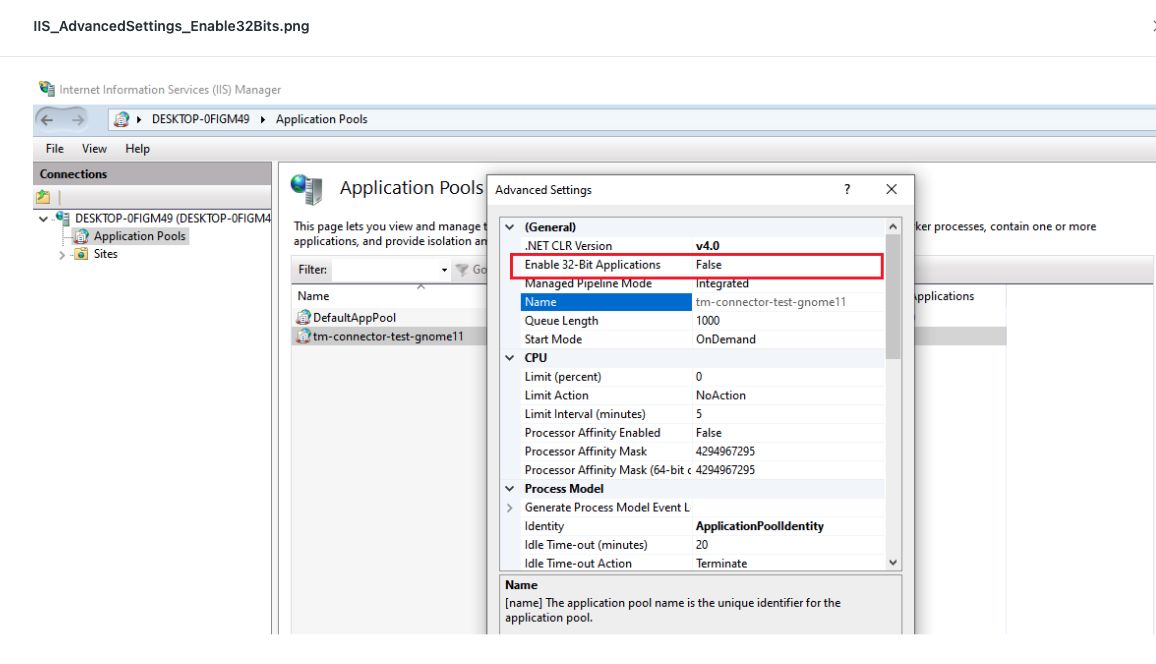

Figure 1. Enable 32-Bit Applications attribute
Change the property for "Enable 32-Bit Applications" to True and restart the application pool. The Plant Integrations will now run in 32-bit.
