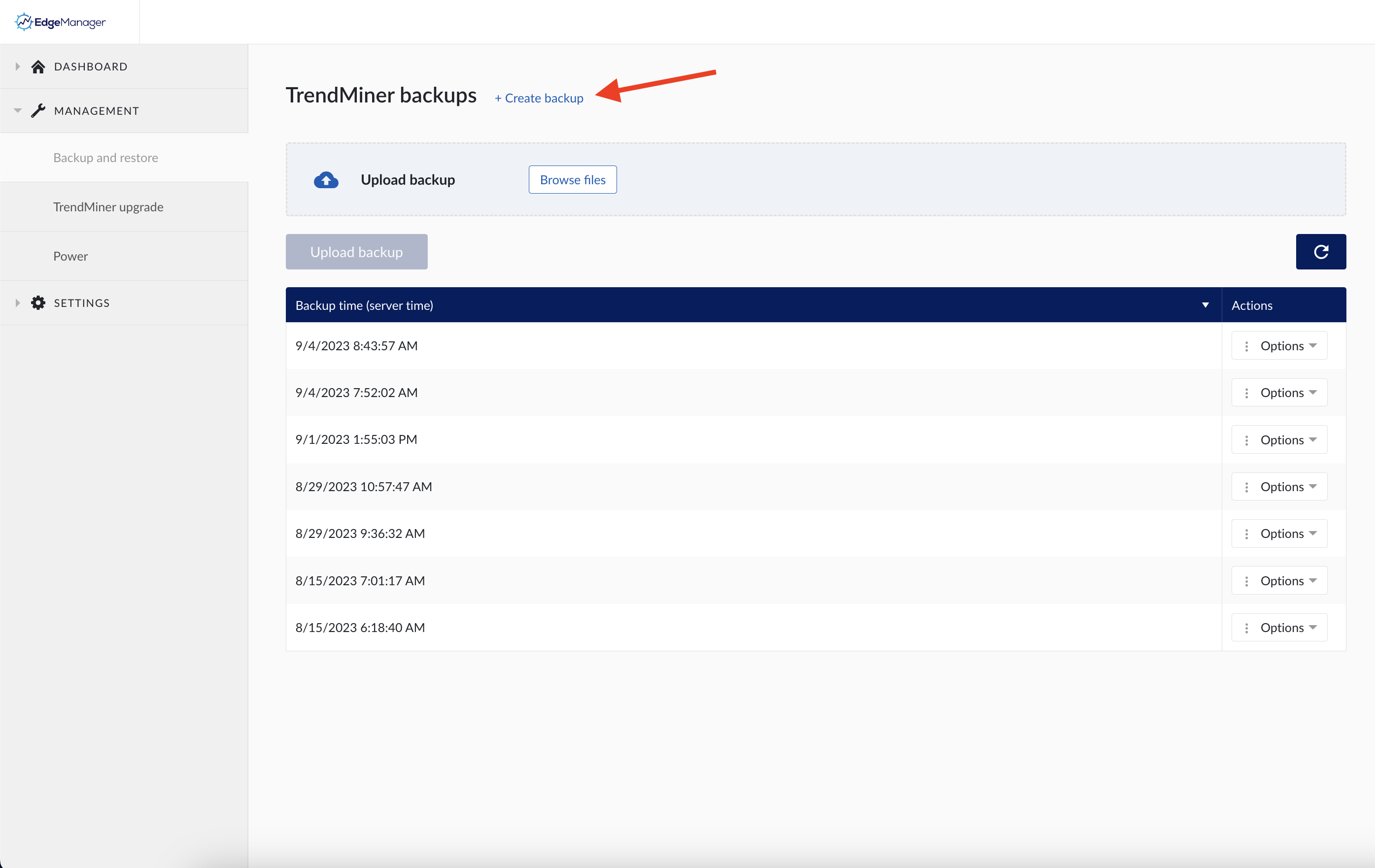

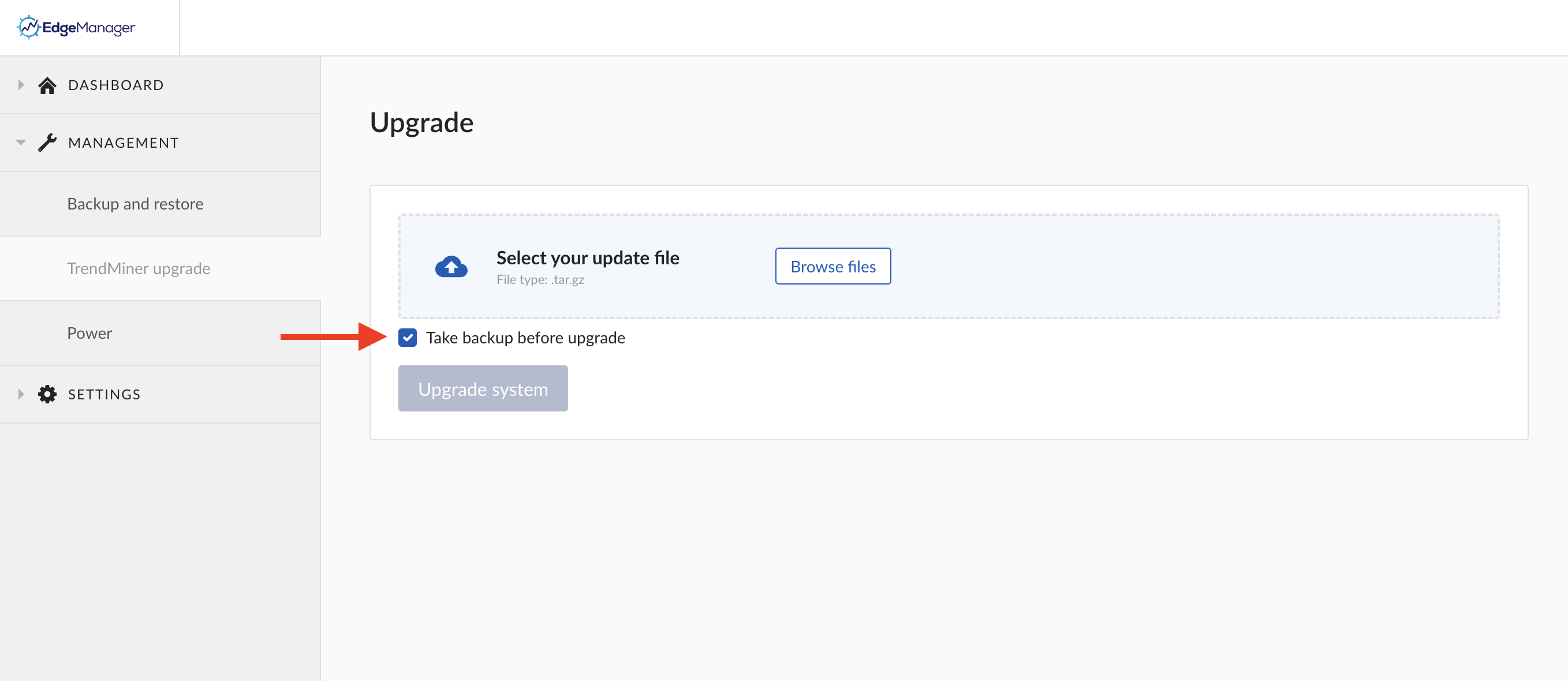

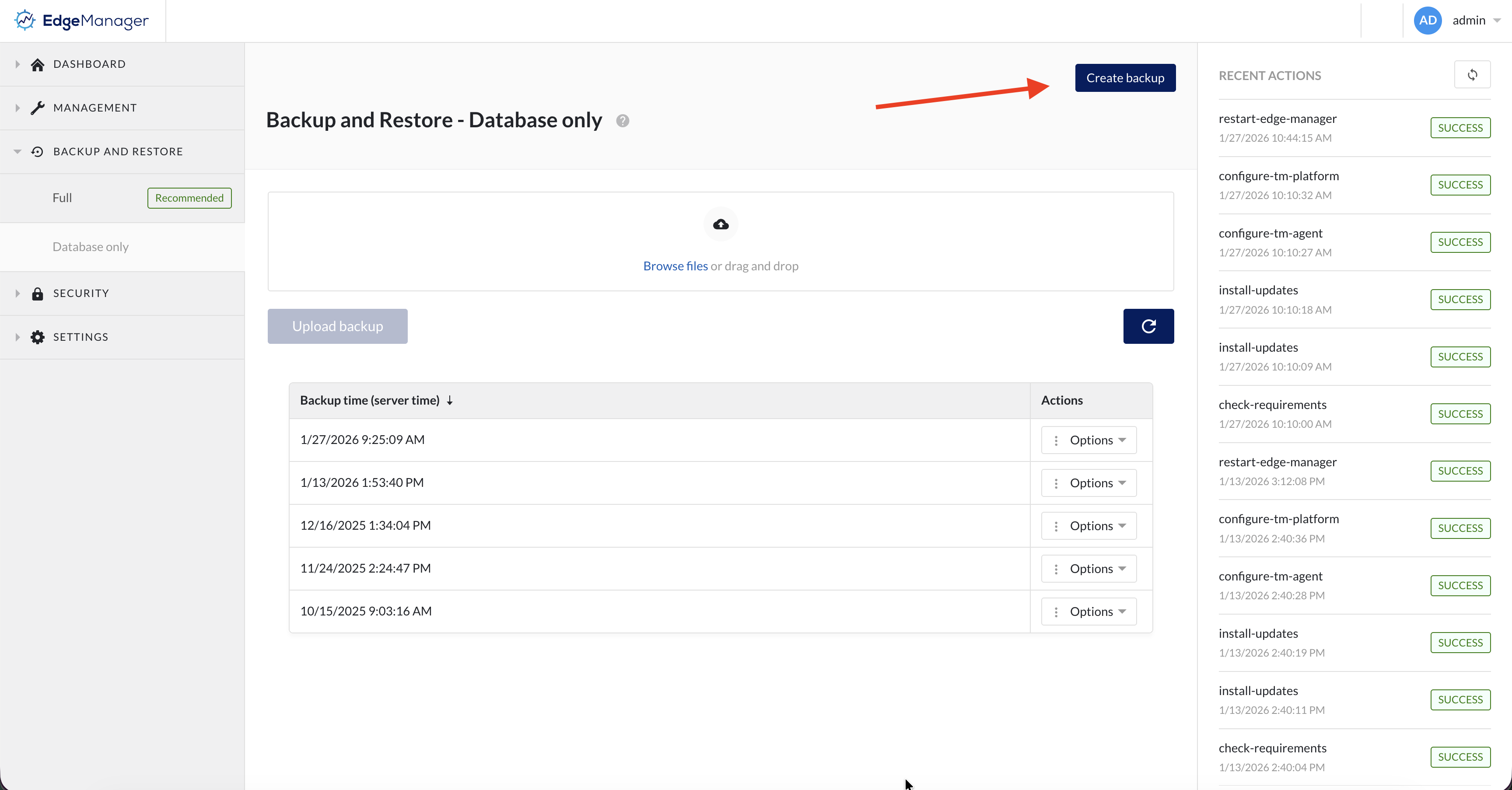

Before starting a TrendMiner upgrade you can choose to enable a backup creation. This backup process can take a significant amount of time that adds to the overall downtime. To reduce this, the admin can take a manual backup first before launching an upgrade and choose to disable the automatic backup creation during the upgrade.
We would advise to take a manual backup before the upgrade because:
  • It causes less downtime during the upgrade.
  • The upgrade will not fail because the hard disk is full.
  • The backup can be downloaded from the TrendMiner server to your local machine or a different server for extra safeguarding of the data.
