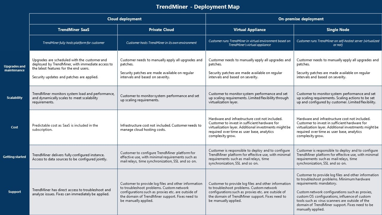

TrendMiner can be deployed in different ways. The first option is to run TrendMiner as a service. In this scenario, TrendMiner will run, maintain and update the platform as a SaaS instance. This is the preferred, future-proof deployment model. In the SaaS scenario, our teams will take care of the installation and reach out to discuss configuration and connectivity.
If you prefer to run TrendMiner as a self-hosted option, there are 2 different options:
  • TrendMiner can be installed on any AlmaLinux 9 or Red Hat Enterprise Linux 9 machine (self-managed Linux deployment, also known as a single node deployment).
  • A self-managed private cloud deployment based on a base AlmaLinux 9 or Red Hat 9 image is also possible.
Installation instructions for these self-hosted options are available in the following sections.
Caution
This documentation walks you through the steps required to set up a fully functioning TrendMiner environment. For self-hosted options, more initial configuration is needed and more maintenance will be required, such as certificate management, etc. Additional input may be required from your organisation's IT department, so it is advised to plan ahead accordingly.
TrendMiner will support issues, but will always point back to this documentation if steps were skipped or requirements are not met. If so desired, TrendMiner can also help with more hands-on support. Reach out to your contact to discuss pricing.
