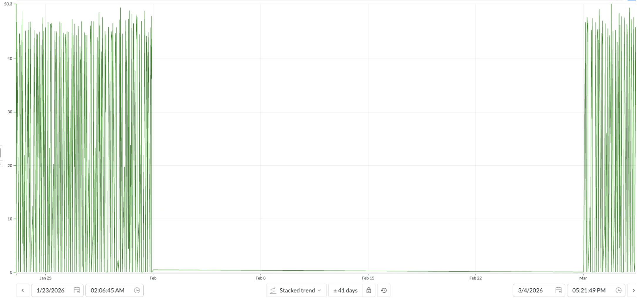

When you data source is having temporary issues it could be that data gaps occur in the TrendMiner index because the data source was not able to provide the data timely. When the data is backfilled in the data source TrendMiner will not re-sync this data if more recent data was already received.
Data gap

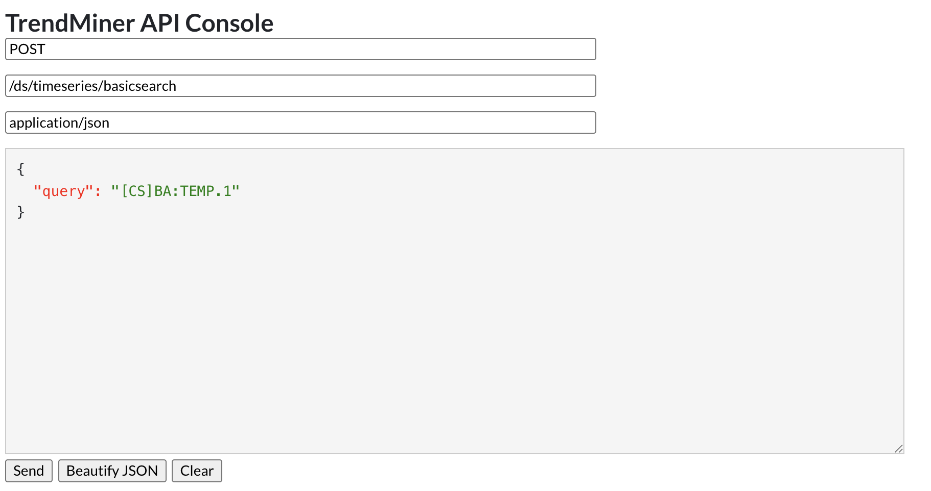

    • Browse to the API console: TrendMiner API Console
    • Search the tag uuid by its name:
      POST /ds/timeseries/basicsearch
      with body: { "query": "<tag name>" }
      Example:

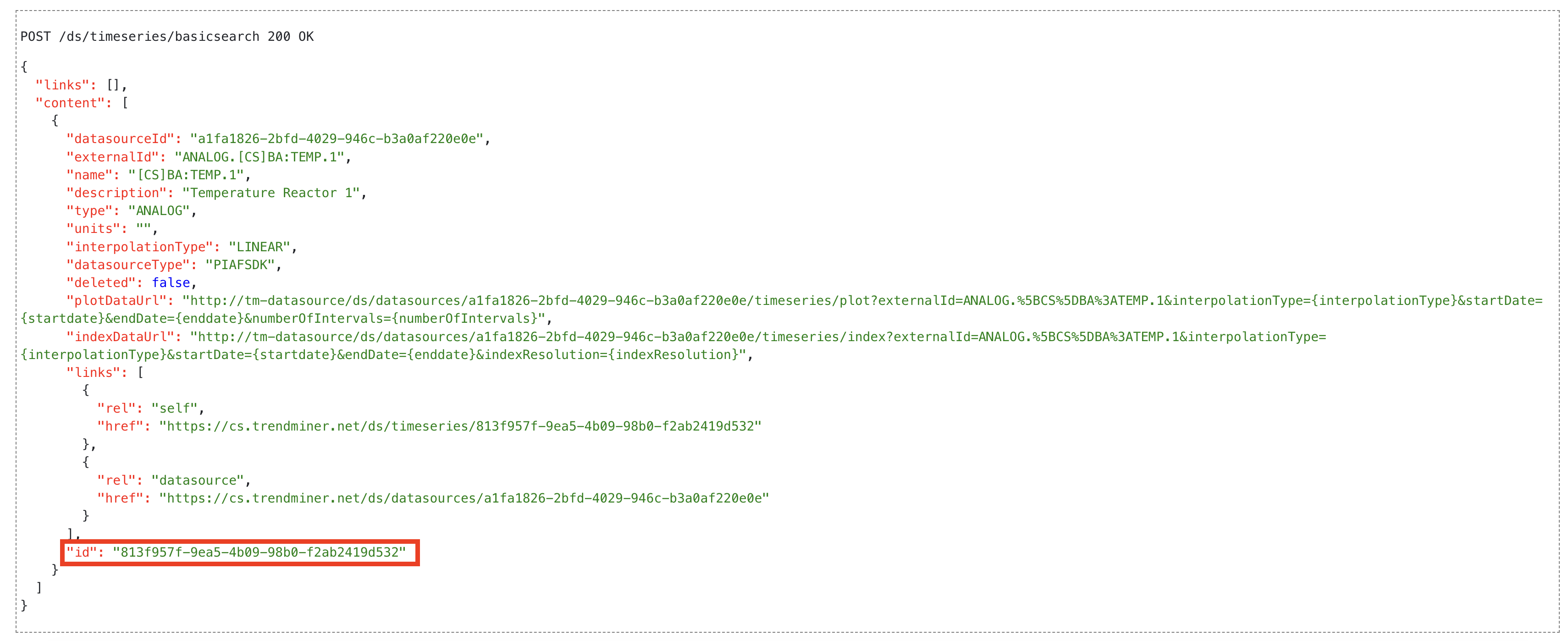

      Get the uuid (id) from the response.
      Example:

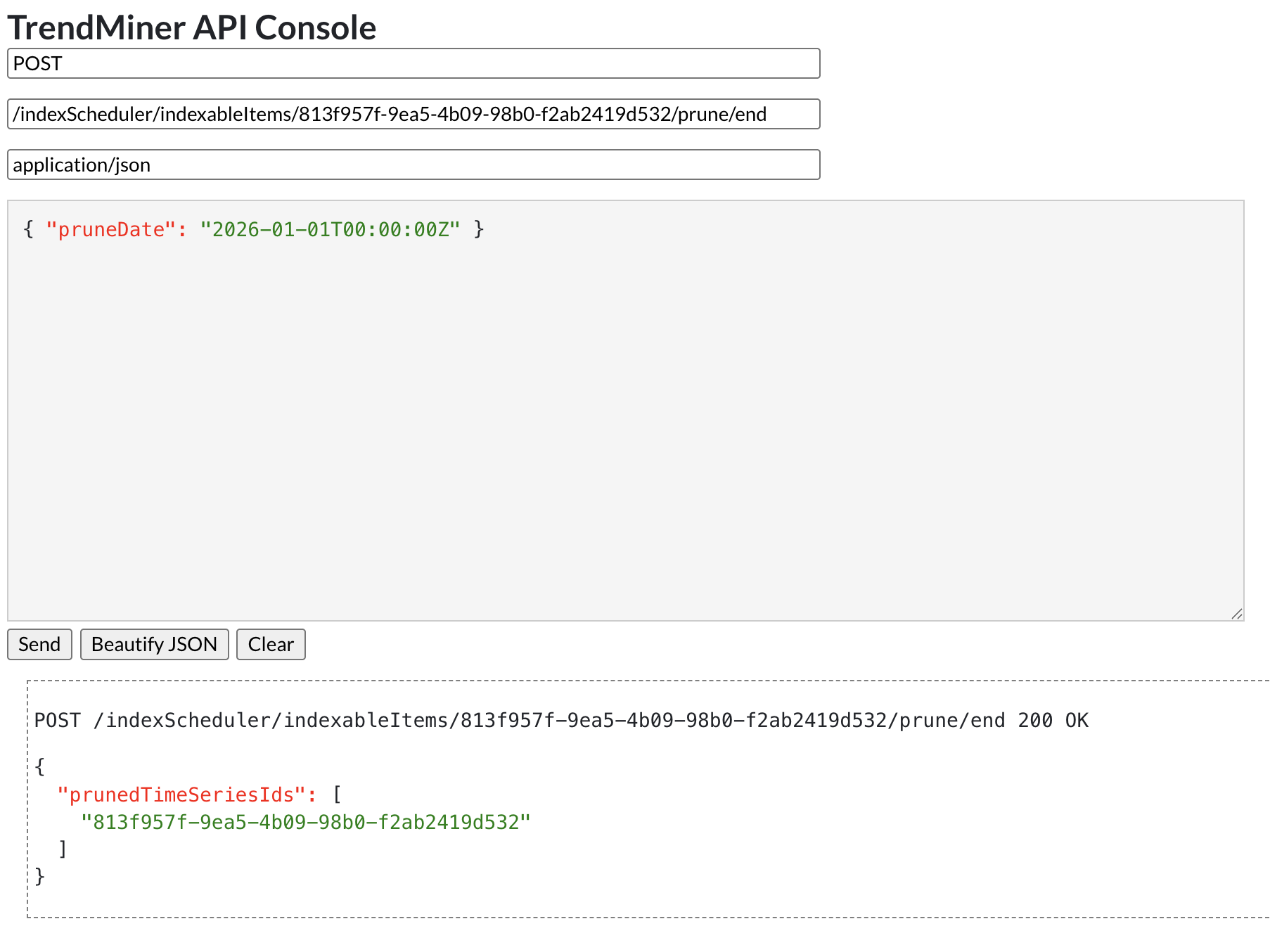

    • Use the prune endpoint from the indexScheduler API to prune index data:
      POST /indexScheduler/indexableItems/<tag_uuid>/prune/end
      with body: { "pruneDate": "2026-01-01T00:00:00Z" }
      Example:
    When data is pruned, the tag will not automatically re-index the deleted index data. The index data will be added again according to the tag's index policy or when the tag is used by a user (e.g. added to the chart).
