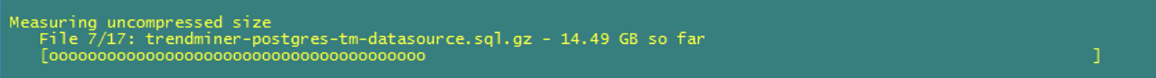

  5. Run the following Powershell command to get the total uncompressed disk size from all databases:
    & { $folder = (Read-Host 'Folder with .gz files').Trim('"', "'", ' ')
      $files = @(Get-ChildItem -LiteralPath $folder -File | Where-Object Extension -in '.gz','.tgz')
      $buf = New-Object byte[] (1MB); $total = [long]0; $sw = [Diagnostics.Stopwatch]::StartNew(); $last = 0
      for ($i = 0; $i -lt $files.Count; $i++) {
        $in = [IO.File]::OpenRead($files[$i].FullName)
        $gz = New-Object IO.Compression.GZipStream($in, [IO.Compression.CompressionMode]::Decompress)
        try { while (($n = $gz.Read($buf, 0, $buf.Length)) -gt 0) { $total += $n
          if ($sw.ElapsedMilliseconds - $last -ge 500) { $last = $sw.ElapsedMilliseconds
            Write-Progress -Activity "Measuring uncompressed size" -PercentComplete ([int](100 * ($i + $in.Position / $in.Length) / $files.Count)) `
              -Status ("File {0}/{1}: {2} - {3:N2} GB so far" -f ($i+1), $files.Count, $files[$i].Name, ($total/1GB)) } } }
        finally { $gz.Dispose(); $in.Dispose() } }
      Write-Progress -Activity "Measuring uncompressed size" -Completed
      "{0} files, {1:N2} GB uncompressed ({2:N0} seconds)" -f $files.Count, ($total/1GB), $sw.Elapsed.TotalSeconds }
    When requested, enter the full path name for the trendminer-<datetime> folder.
    The result shows the total uncompressed disk space used by TrendMiner databases.
