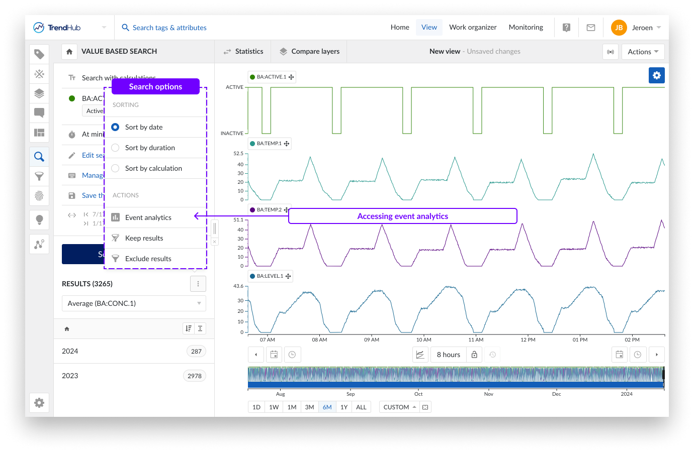

The event analytics pane can be accessed through the search result option menu.
When the event analytics pane is opened, the search result list is disabled. The event analytics pane can be closed by using the Close button or the Refine button. Switching menus will also automatically close the event analytics pane. On re-opening the event analytics pane, selections will be re-applied based on the active refinements. Ad hoc selections will not be remembered when closing the event analytics pane.

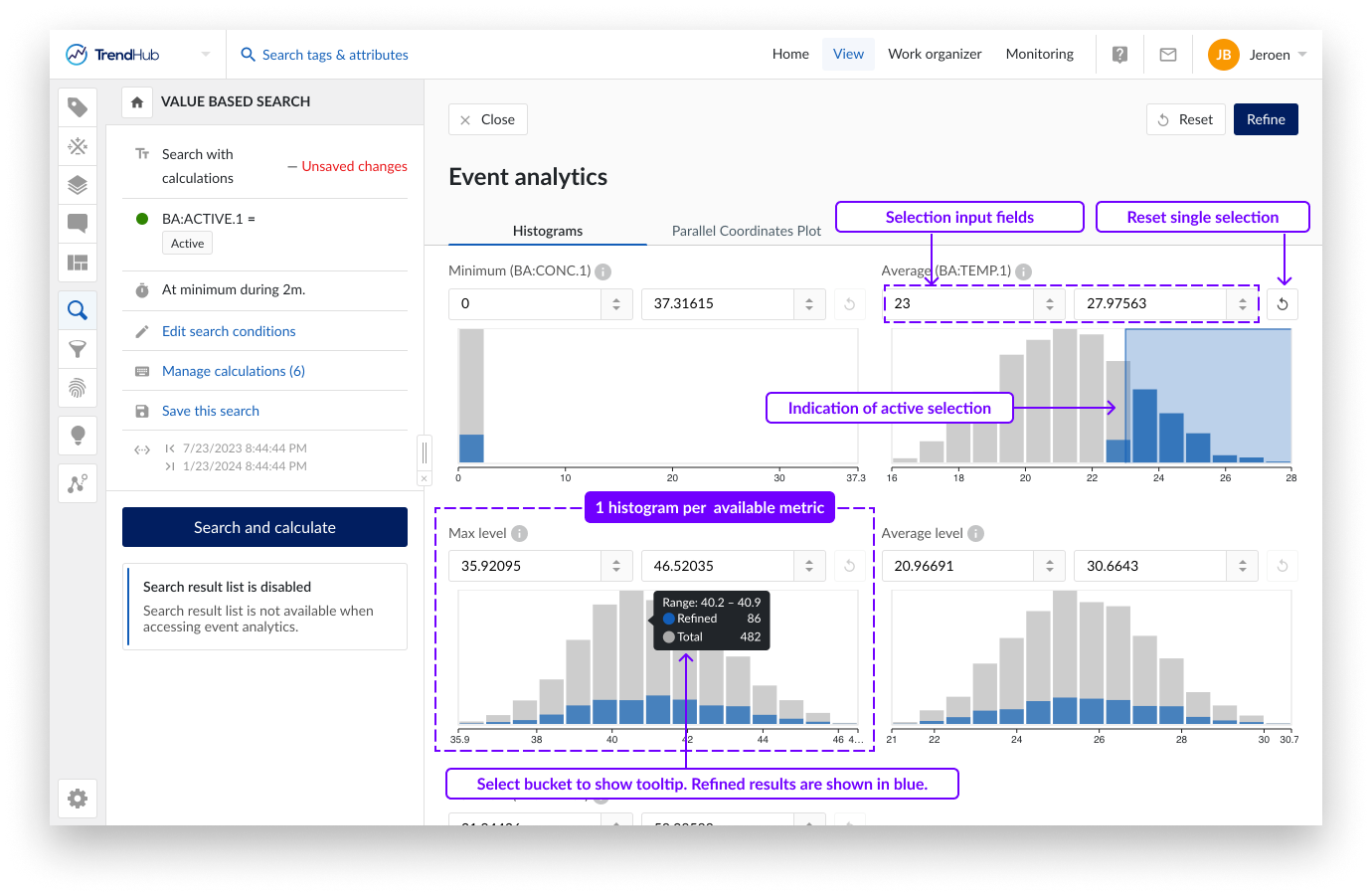

The histogram tab provides a visual representation of the data distribution for all calculations on analog or discrete tags as well as the duration of search results or the similarity score. Hovering over a single bucket provides information of the ranges of each bucket, as well as the total number of results residing within this bucket.
A subset of the data can be selected by making selections on histograms or by setting the ranges manually in the numeric input fields. Histograms with active selections can be identified by the blue shaded area. When selecting subsets, the remaining results are indicated in blue and reflected on all histograms. The number of refined results are also indicated in the tooltips.

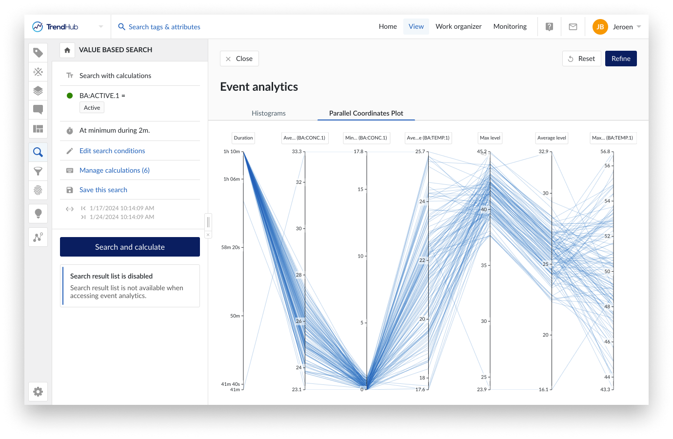

Parallel coordinates plot
A parallel coordinates plot is a graphical method used for visualizing multivariate data. In contrast to the histogram visualization, the parallel coordinates plot shows every single search result. It consists of parallel axes, one for each metric (duration, similarity score and calculations on analog or discrete tag, and lines connecting the different axes. One blue, continuous line represents one search result. This type of plot is particularly useful for understanding the relationships and trends within the search results. Look for patterns such as convergence, divergence, or parallelism of lines. These patterns can reveal correlations, clusters, or outliers in your data.
Caution
A search result is only visualized on the parallel coordinate plot if all calculations have values. In case 1 of the calculations does not have a value (e.g. due to missing indexed data or infinite values), the complete search result will be omitted from the plot. This is a big difference compared to the histogram visualization.

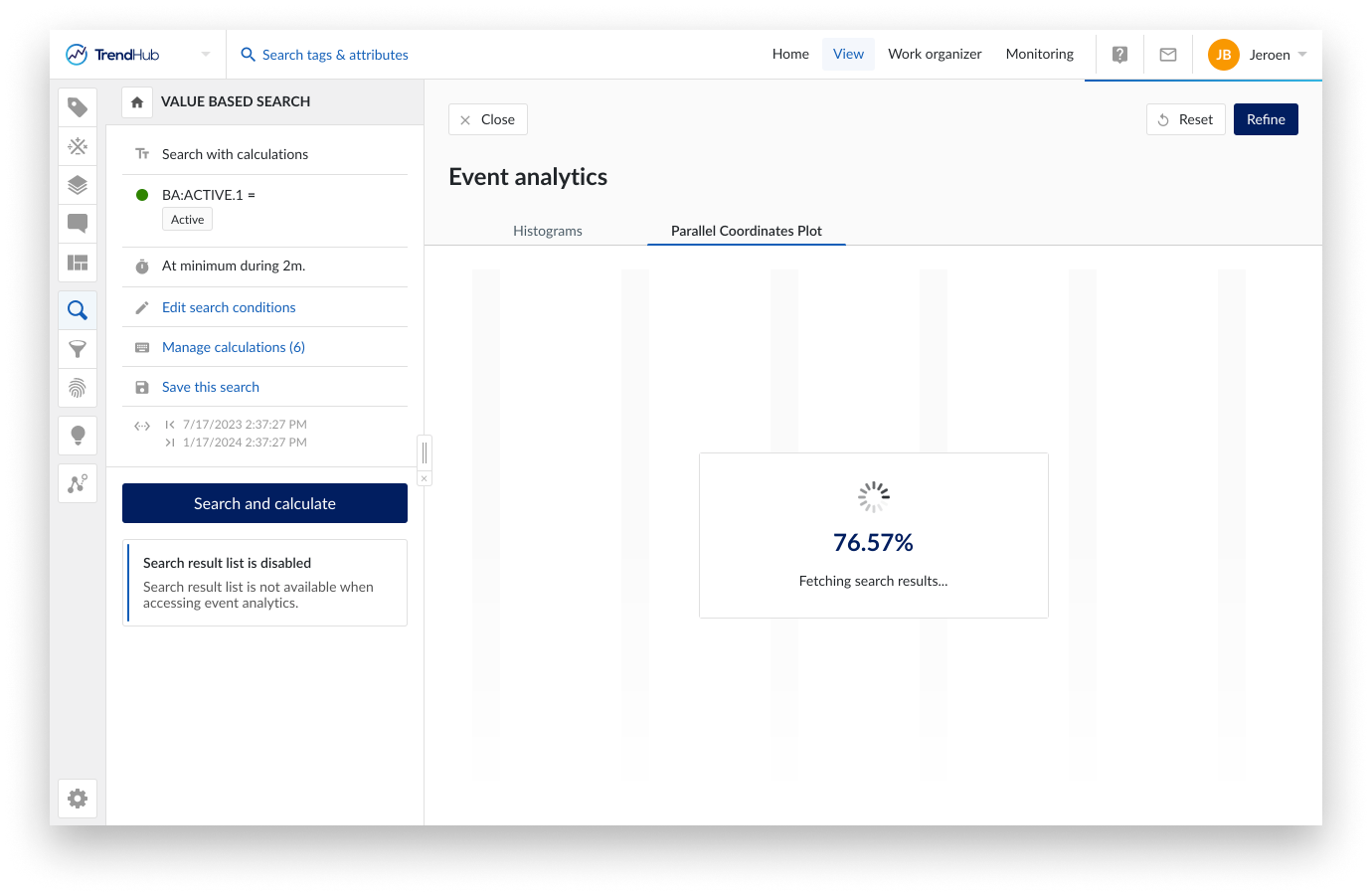

Since all results will be shown as single data points, the initial rendering of the plot can take up a bit of time. A loading screen will be shown while fetching all the data. As soon as this is completed, the graph will be shown. Afterwards you can seamlessly switch between the histogram and parallel coordinates plot tab.

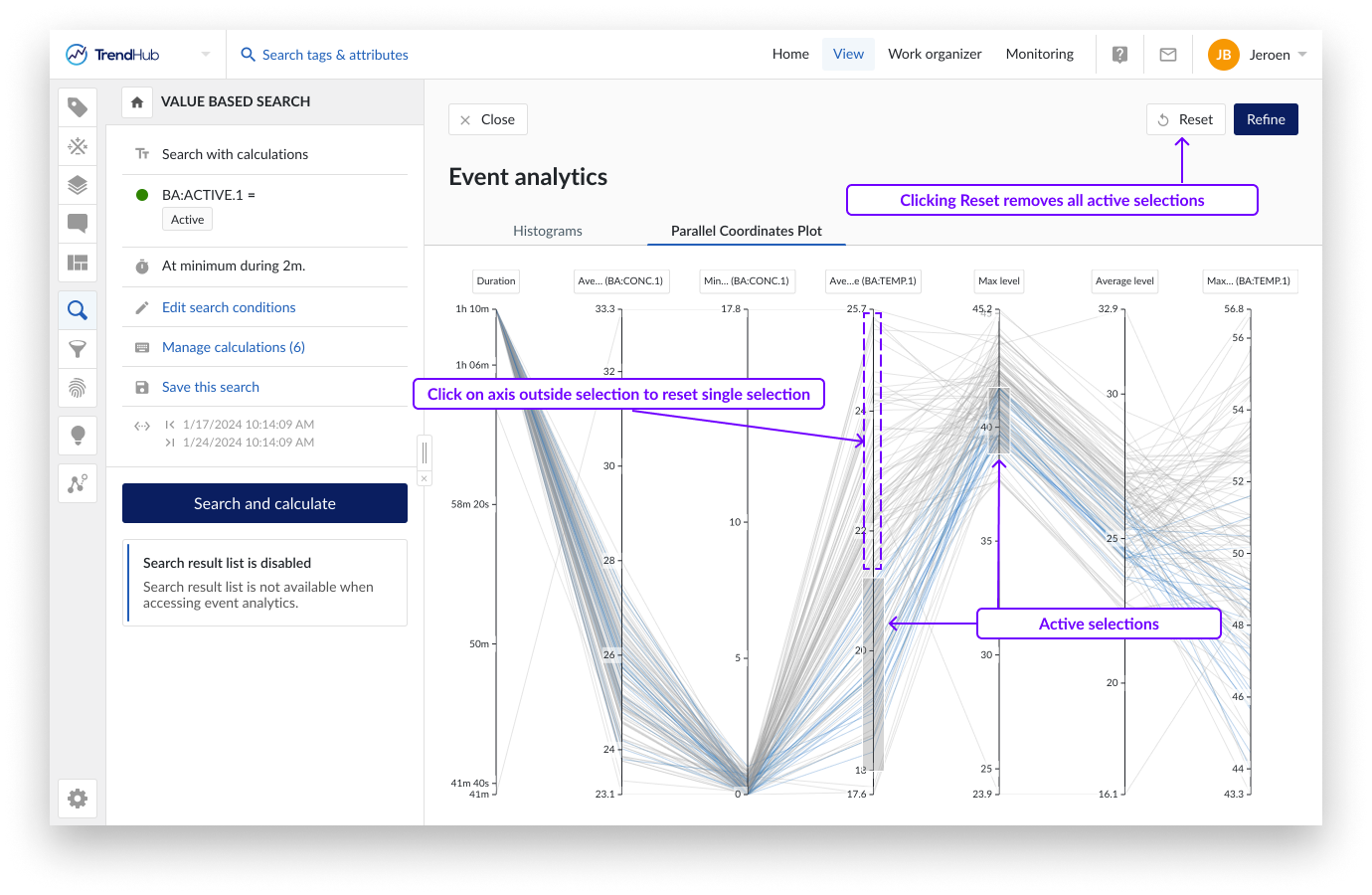

A subset of the data can be selected by making a selection on an axis (also called “brushing”). Remaining results are visualized in blue. Selections can be made on different axis to combine different criteria. By clicking on the axis outside of the selected region, the selection is removed. Clicking the Reset button at the top right, removes all selections at once.

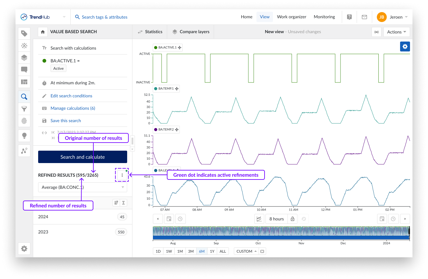

The event analytics visualization can be used for ad hoc analysis or to further refine the search result list. Click Refine in the top right corner, to transfer the ad hoc selections to the search result list. The search result list header will update to indicate both the number of refined results as well as the original total results. A green dot appears on the search options, indicating that the search result list has been refined. The set of refined results can now be used to continue your analysis in the time-series universe. The search result options, like filtering, creating context items, and exporting, will now only be applied on the refined results. See this article for more information on how to work with the search result list.
