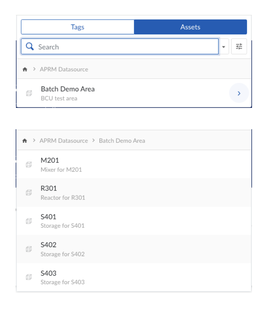

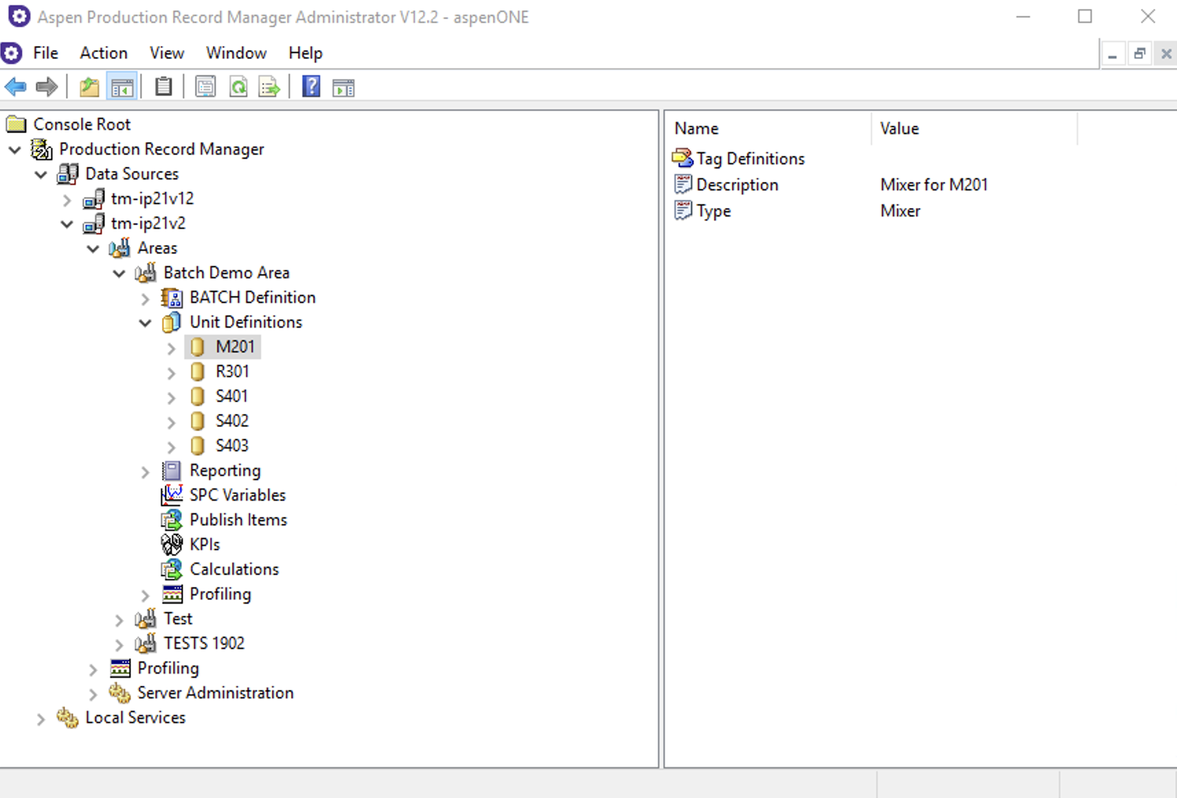

Our provider for Aspen Production Record Manager implements the asset capability and uses data from the area definition to populate the asset hierarchy in TrendMiner. The root node of the asset hierarchy is the area itself. The children nodes of an area node are created using “Unit Definitions". The asset hierarchy has a fixed depth of two.

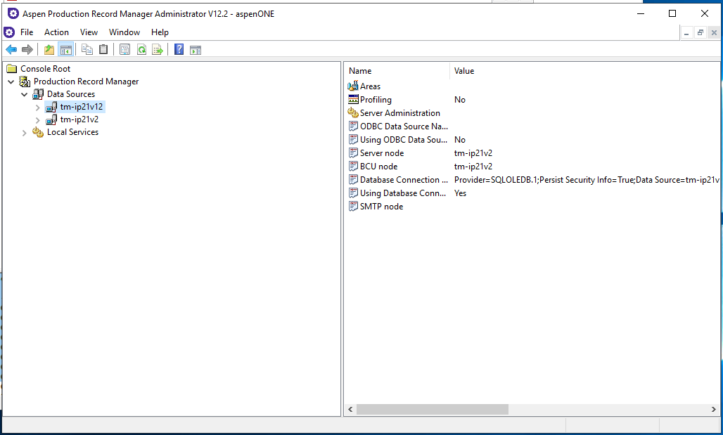

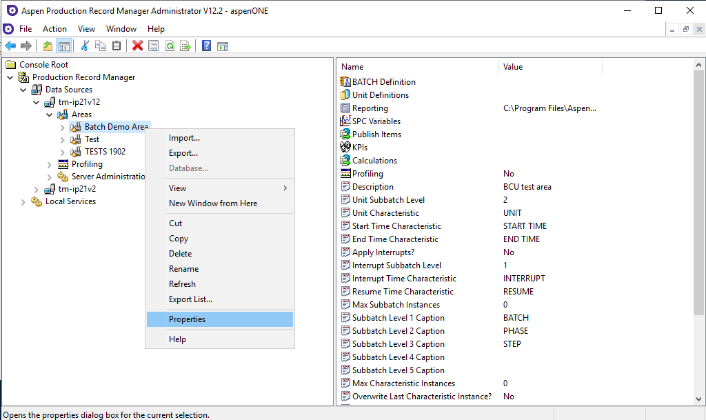

Area and Unit Definitions in Aspen Production Record Manager Administrator
Asset hierarchy in TrendMiner

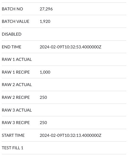

The provider generates Context Item Fields based on the string, numeric, boolean and time characteristics that are available on the subbatches of Aspen Production Record Manager. The existence of characteristics and the level on which they are defined is completely dependent on the configuration of the Subbatch Definition implemented in the environment of the the customer.
Context item fields
Designators
Designators are characteristics that uniquely identify a batch. These characteristics reside on a batch level but the provider makes these characteristics available on every level in the subbatch hierarchy. If ”BATCH NO” is the designator, all the subbatches will also receive “BATCH NO“ as a field.

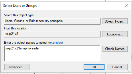

Plant Integrations must be configured to run under an identity that has access to Aspen Production Record Manager. This user must be a member of the ‘Distributed COM Users ’group on Aspen Production Record Manager server. If ARPM is configured to use Role-based security, be sure to grant the identity the correct roles. To configure role base security within Aspen Production Record Manager(APRM), a user account needs to be added to a role in AFW Security Manager and then assign the role to the desired Batch/Subbatch/Characteristic/Report with the intended permissions in APRM. Due to some limitations in Plant Integration, only one user account can be configured to interact with APRM being that account the same that operates Plant Integration application pool in IIS. The chosen user account also needs modify permissions at folder level where Plant Integration resides.

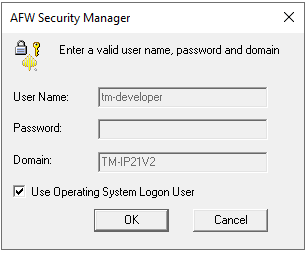

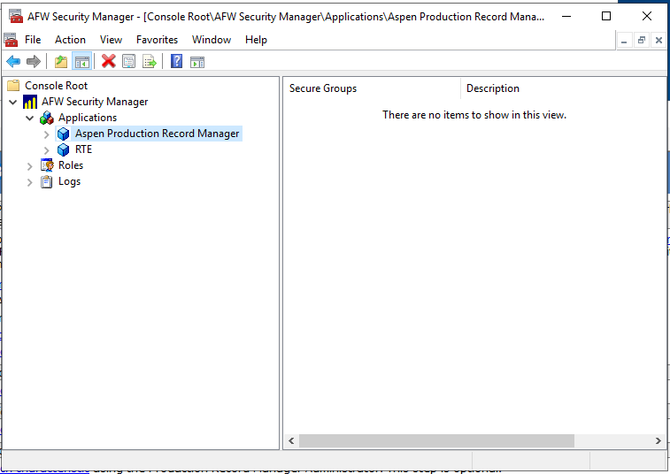

1. Open Application and Sign-in
Open Windows Start menu and search AFW Security Manager
Fill the User and Password or Use Operating System Logon User by checking the checkbox
2. Install role-based security for APRM

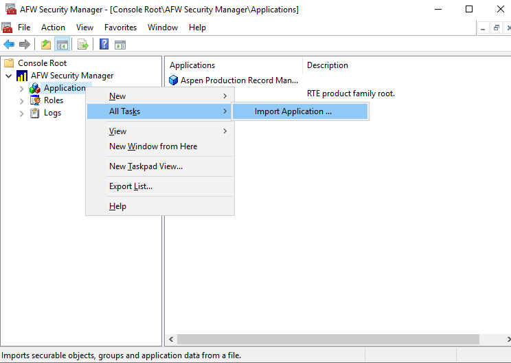

Right-click Application in the left pane of AFW Security Manager and click All Tasks > Import Application
Open Batch21.xml found in C:\Program Files\AspenTech\Batch.21\Server\Setup and APRM is now visible in Applications
Notice
The file might be found in a different location. E.g. “C:\Program Files\AspenTech\Production Record Manager\Server\Setup”.
To add the application manually, please follow the instructions found on APRM documentation in section “Configuring Role-Based Security”.

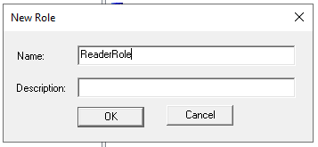

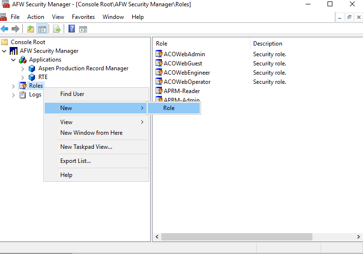

3. Create Roles
Right-click Roles in the left pane of AFW Security Manager and click New > Role
Fill the desire Name for the role and click Ok

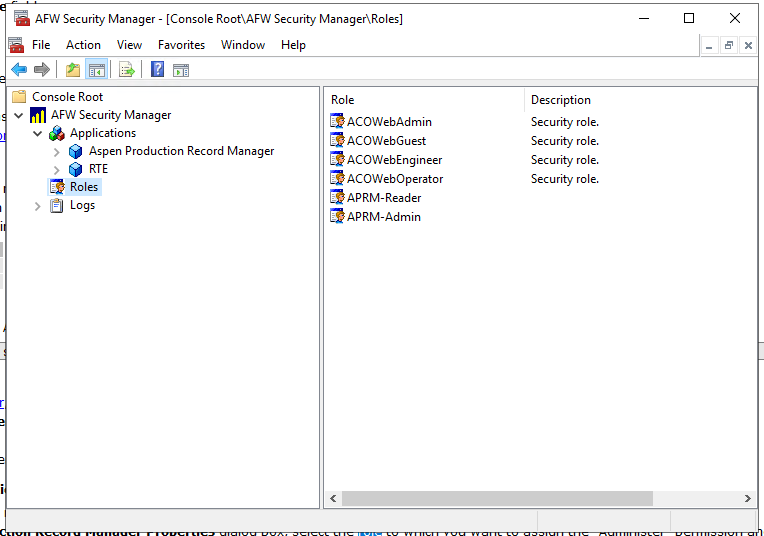

4.Assign Users to Roles

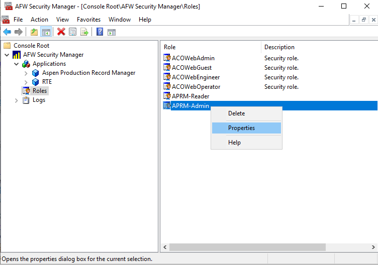

Click Roles in the left pane of AFW Security Manager and all existing roles should be visible in the content window
Right-click the role to which to assign the users and click Properties

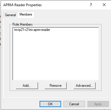

Navigate to Members tab and click Add to assign users to role
Choose the desired user and click Ok

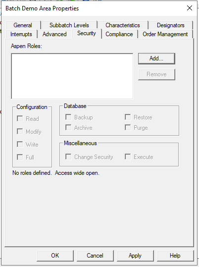

2. Configure Permissions

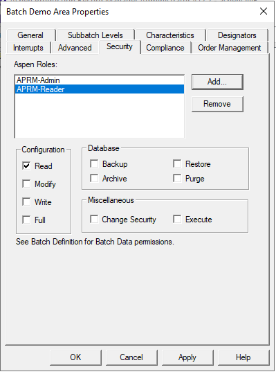

To configure permissions at any level Batch/Subbatch/Characteristic/Report, the method is the same.
Right-click on the level to which to set permissions and click Properties
Navigate to Security tab and click Add to assign a role
Choose the desired role and click Ok
Check the checkbox's of the permissions to assign to the role and click Ok
At least one role with Change Security permission is mandatory. The members of this role will be able to change security for the current level

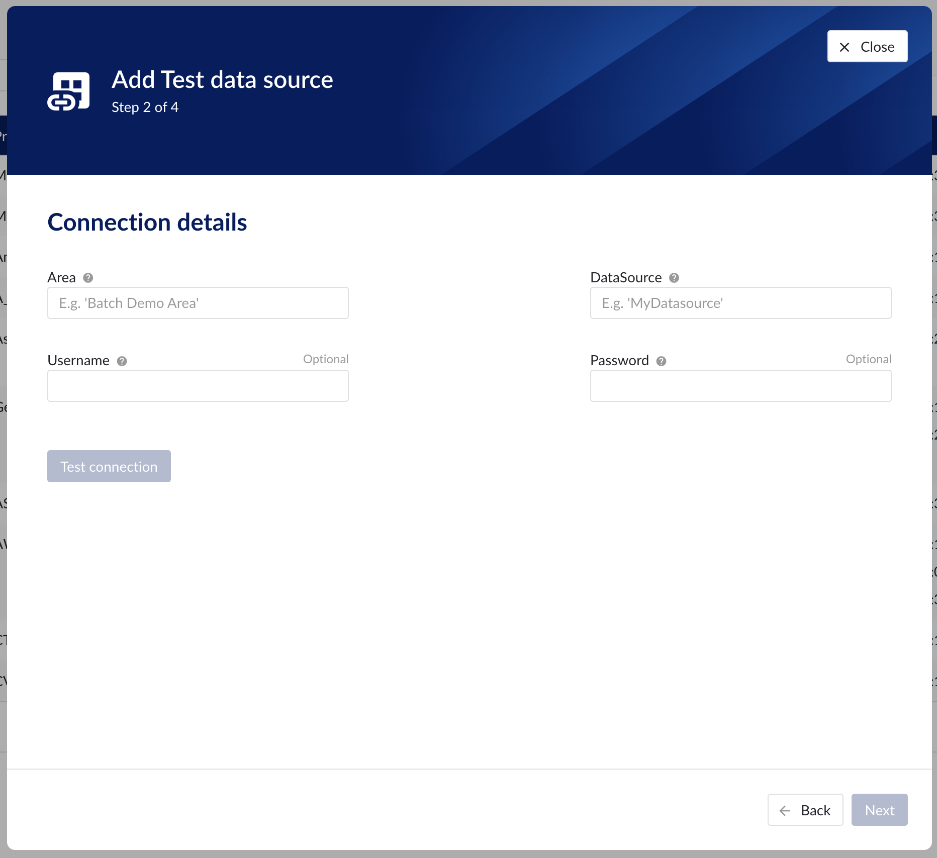

In ConfigHub go to Data in the left side menu, then Data sources, choose + Add data source. Fill out 'Data source details' on the first step of datasource creation wizard: type the name of a data source, select “Aspen Production Record Manager (via SDK)" from Provider dropdown, then select the configured connector from Connect via dropdown.
Connection details
To establish a connection, 4 provider properties need to be filled in:
Property | Required? | Description |
Area | true | Name of the area inside a specified DataSource where the provider reads its data. |
DataSource | true | Data source used by this provider. The AspenTech Production Record Manager can store multiple data sources on one server instance. |
Username | false | Optional convenience field to enter the username used to establish a connection. |
Password | false | Optional convenience field to enter the password used to establish a connection. |
