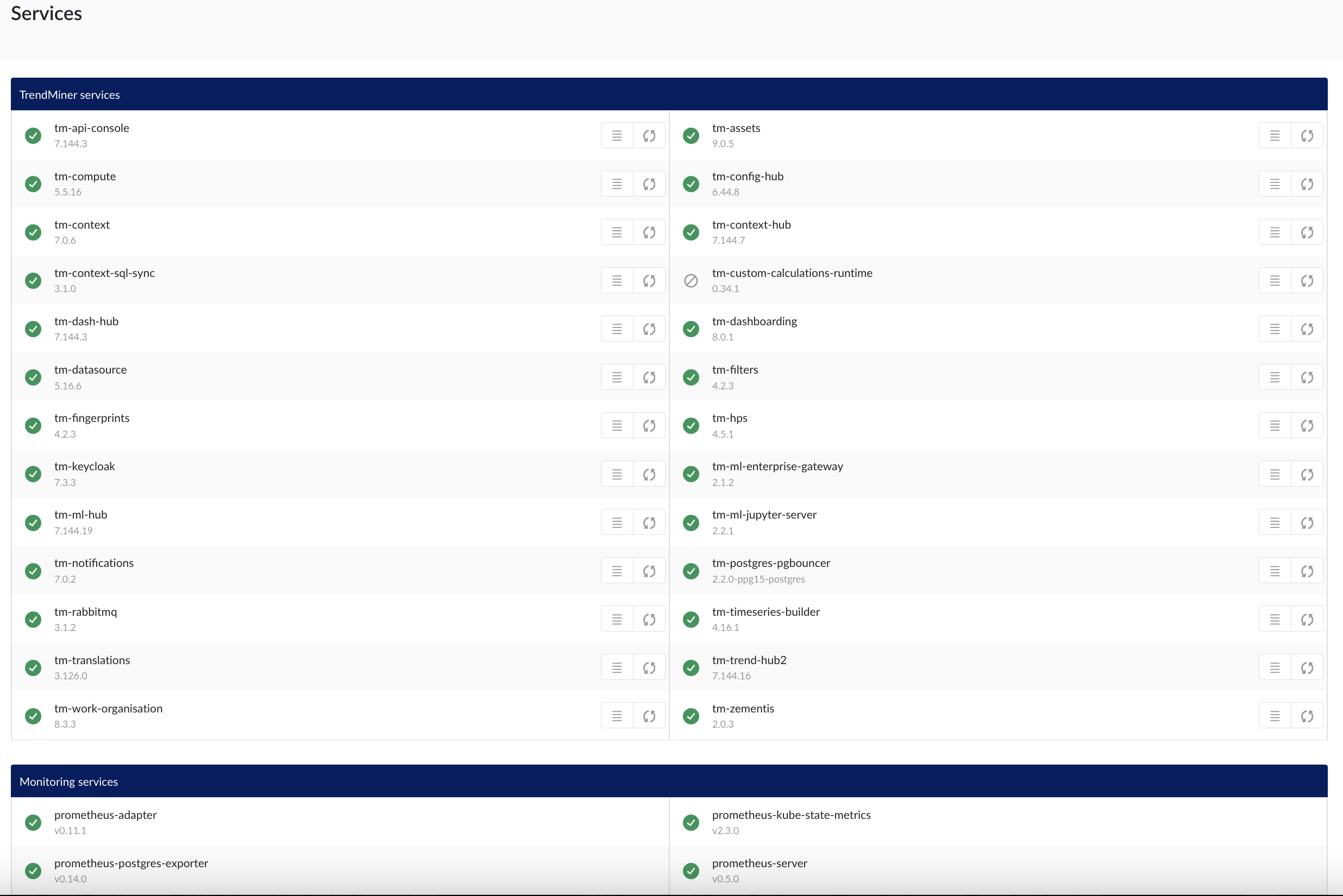

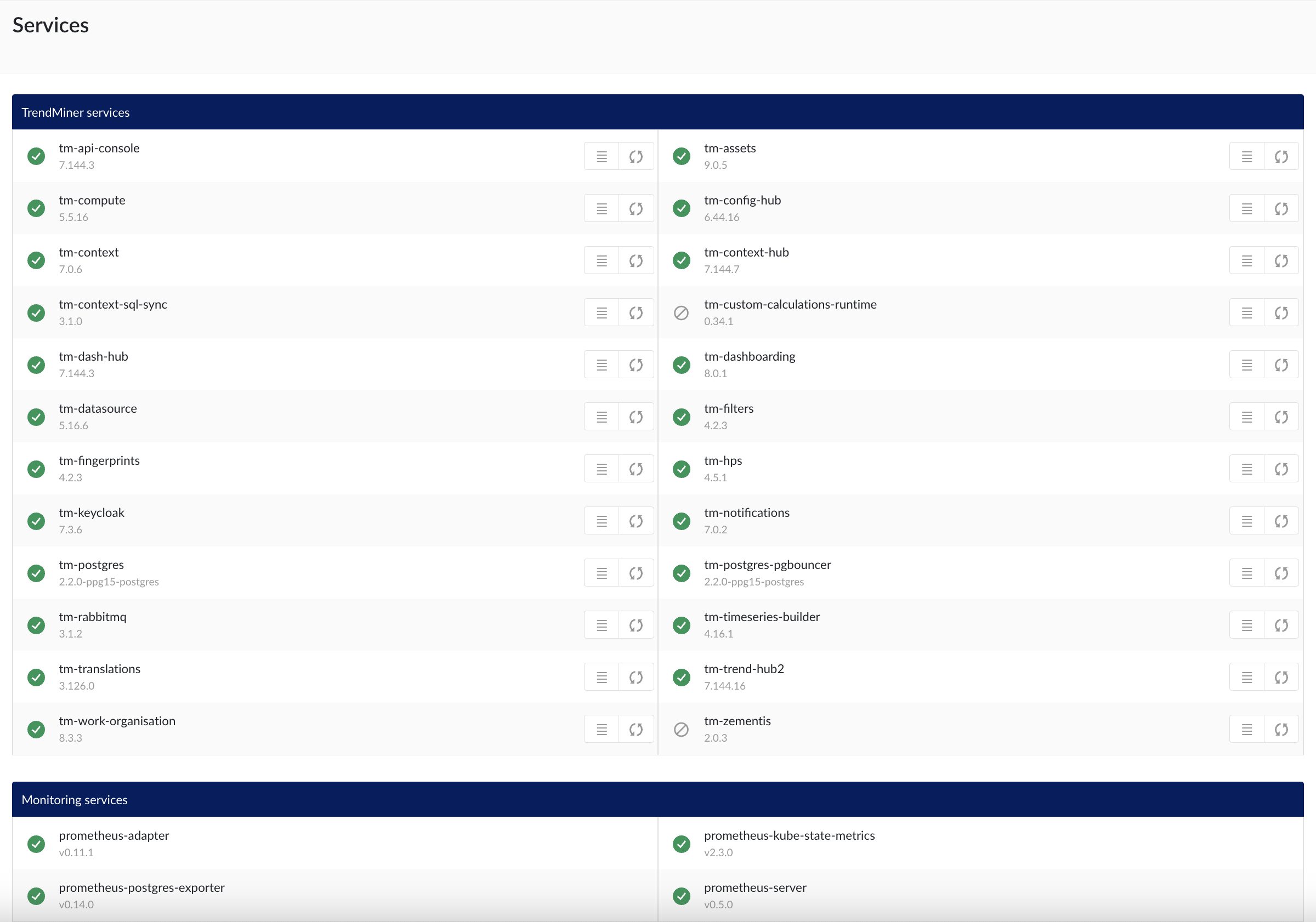

When using the TrendMiner Virtual Appliance reboot from the Edge Manager portal. Expand the ‘MANAGEMENT’ menu and go to the ‘Power’ section. Click ‘Reboot’ button.
Once rebooted, make sure all the services are healthy in the 'DASHBOARD' -> ‘Services’ page.
Without MLHub:
With MLHub:
