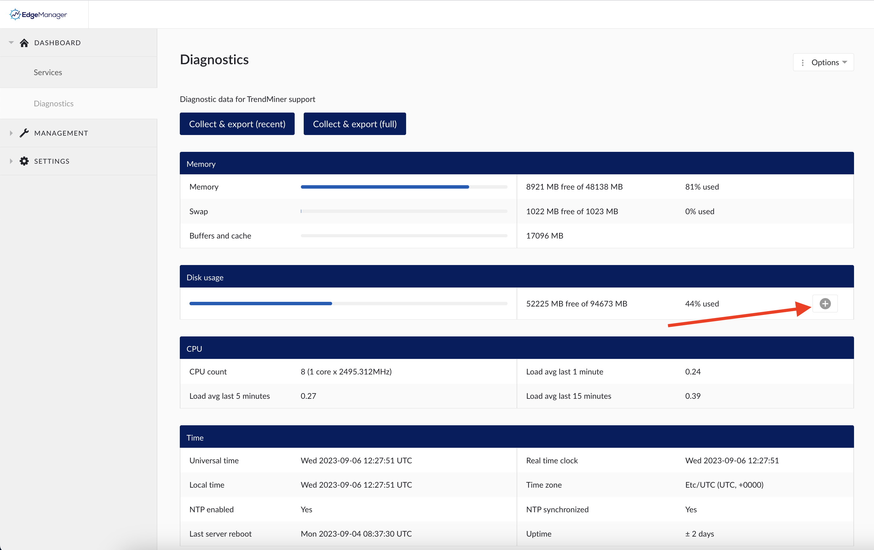

Expand the ‘DASHBOARD’ section and click ‘Diagnostics’.
Under the ‘Disk usage’ section, click the ‘+’ icon to start the disk extension process.
Click ‘Yes, extend’ to confirm the choice.

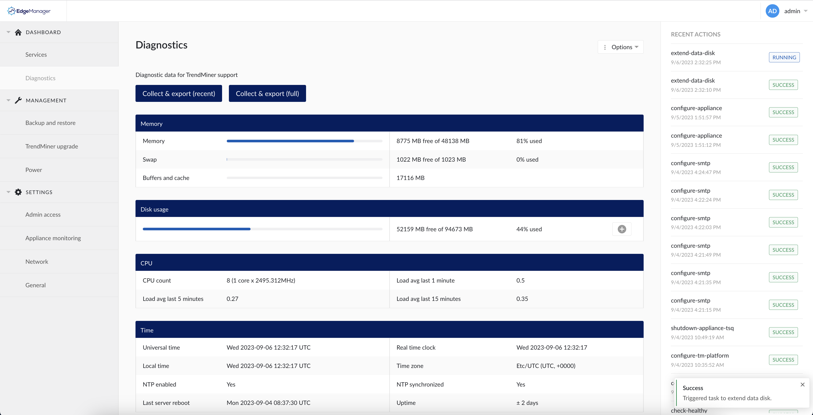

A green message on the bottom right will say ‘Triggered task to extend data disk’ and a new task 'extend-data-disk' will show up in the ‘Recent Actions’ panel on the right.
Wait until the ‘extend-data-disk’ status changes to ‘SUCCESS’. TrendMiner is now able to use the extra disk space.
