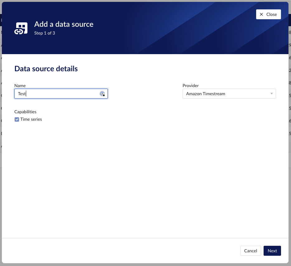

To add an Amazon Timestream data source, in ConfigHub go to Data in the left side menu, then Data sources, choose + Add data source.
Fill out 'Data source details' on the first step of the datasource creation wizard: type name of data source, select “Amazon Timestream” from the Provider dropdown. Time series capability will be checked by default.

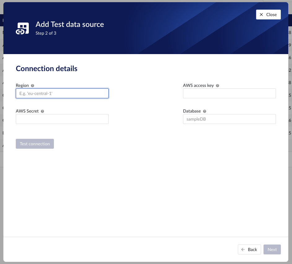

Fill out additional properties, grouped in following sections:
Connection details – lists properties related to the configuration of the connection that will be established with Amazon Timestream.
Time series details – lists properties relevant for the time series data.
"Region" – enter the availability zone region within AWS cloud in which the Amazon Timestream instance is configured. For more information, please consult the AWS Documentation.
"AWS access key" – enter the access key to authenticate. This is the access key id as created in AWS IAM.
"AWS Secret" – enter the secret to authenticate. This is the AWS secret as created in AWS IAM.
“Database” – enter the name of database in Amazon Timestream. This is primarily used to test the connection liveness from TrendMiner to Amazon Timestream.
