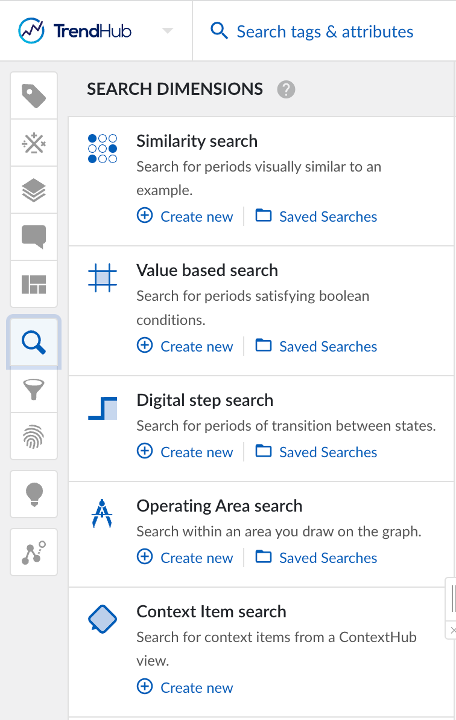

Goto TrendHub's menu and click on the search icon
 to find the Context Items search tool
. Select this tool to open TrendMiner's ContextHub, the location where all views for context used to annotate data can be found.
You need to click on "saved ContextHub views" in the search menu to use the search in TrendHub. If you click on context items, you are redirected to ContextHub.

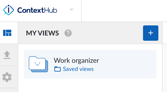

You can also enter ContextHub via the Hub selector, situated on the top left of the screen.
Look to the MY VIEWS menu within the panel on the left hand side of the screen.

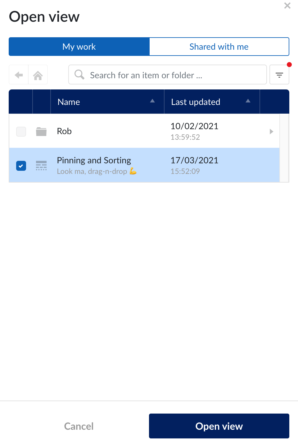

Click on "Saved views".
A side panel appears from the right.
Select a view from the list.

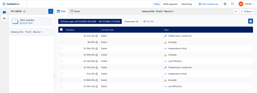

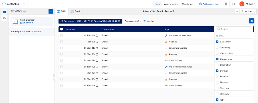

The view will open and present your context data in the table display mode by default.
Click on "Open view".
A listing of your items appears ContextHub
A View table presents a series of Context Items, normally indicative of a process. The table is composed of the following columns which can be selected by clicking the gear icon:

Opening the column selector (gear) will give you a variety of column types you wish to see displayed in your views table. Tick the column options that are interesting to you. Each new column selection will be placed to the front of the list of columns.

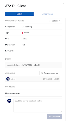

If you wish to see the story of your Context Item, click on a row to open the Context Item details panel, which appears from the right side of the screen.

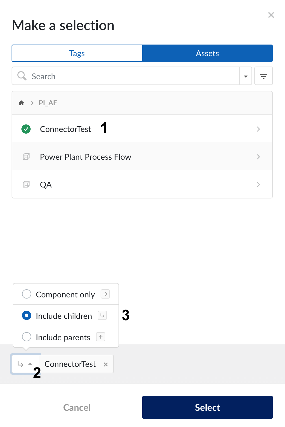

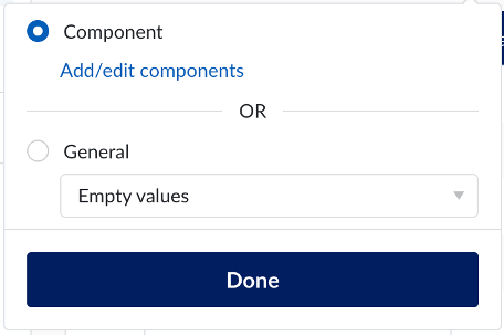

If you wish to select a component:
Click on the
 "Add Filter" button.A drop down window appears
Select "+Component".
A second drop down window appears.
Click on "Add/edit components".
Select your component from the component menu.
A label of the component selected appears in a bottom bar of the side panel.
Click on the arrow button.
A small drop down menu appears that includes the following options:
Component only (default)
Include children
Include parents
Select one of the options.
Click "Select" button.
After you click select your choice of components appears in your filtered selection.

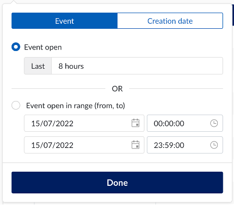

You can also filter a view using time periods and dates, relate to:
Event start date
Creation date of the context items
Simply select the time cell (last eight hours is the default setting) and enter the time periods and dates desired, in which your events occur.
You can either:
select a preordained period (in which your event occurred) by clicking on the "8 hours" field;
select specific event dates; or,
choose an item creation date beneath the "Creation date" button. This sub-filter includes before and after date.
Then click "Done".

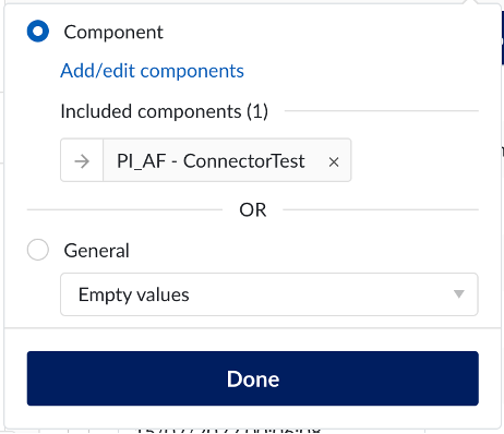

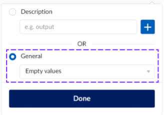

On some property/field types, it's possible to filter not only based on specific values, but also on empty or non-empty values. This option is available on the following filters:
A value is considered empty if it is either null or an empty string. Filtering on empty or non-empty values for component is currently not supported in Gantt view.
Component filter
Description filter
Keyword filter
Current state filter
Custom numeric context field filter
Custom string context field filter
Custom dropdown context field filter
