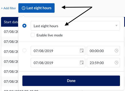

  2. Goto ContextHub and create views ensuring that you select a period associated with the final hours of operation in ContextHub grid views and/or ContextHub Gantt views.
    The "Enable live mode" switch refers to live mode of the views in ContextHub, and bear no relation to any action in DashHub.
