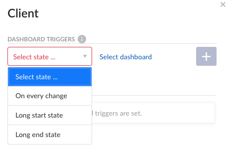

A panel will appear from the right, select a state on which the trigger should activate.
Click on "Select dashboard" and identify dashboard of interest.

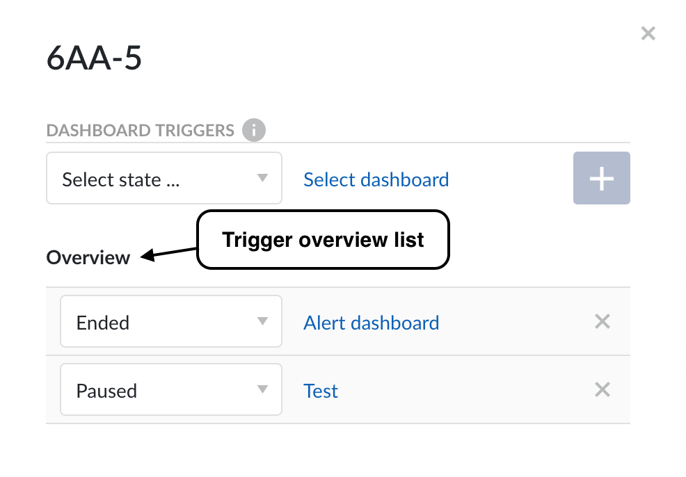

Click on the + sign to add your new trigger to the overview list. This list provides an overview of your preset triggers.
