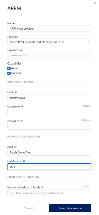

In ConfigHub go to Data in the left side menu, then Data sources, choose + Add data source. Type the name of a data source, select “Aspen Production Record Manager (via SDK)" from Provider dropdown, then select the configured connector from Connect via dropdown.
Provider properties
The APRM provider implements both assets and context capability. These capabilities have two required provider properties to be filled in:
Table 4.
Property
Description
Area
The name of the area inside the specified DataSource where the provider reads its data.
DataSource
The data source used by this provider. The AspenTech Production Record Manager can store multiple data sources on one server instance.

NumberOfSubbatchLevels
Override the number of subbatches to read from the area.This must be a number between (inclusive) 1 and 5. By leaving this property empty, all the levels defined in the area are included (APRM has a limit of 5 levels).
The host property of TrendMiner’s data source is not applicable for this provider, since the connection is resolved by the Directory Server configured using the ADSA Client Config Tool. A dummy value can be entered here, that will be ignored during creation of the provider.
