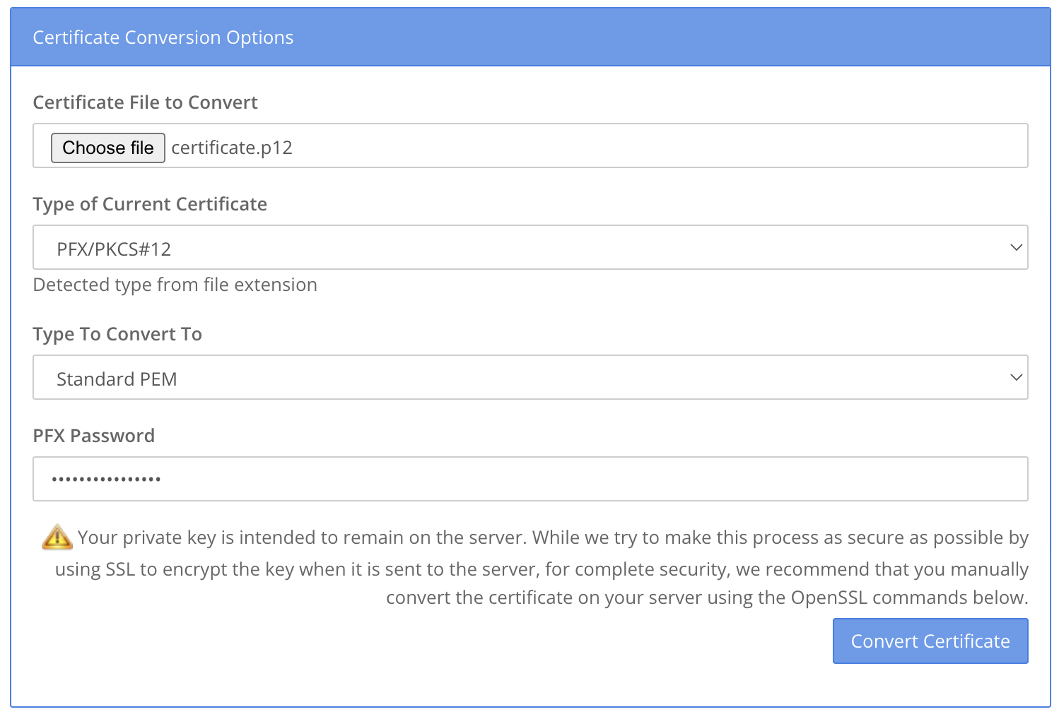

To extract the private key from the .p12/.pfx file:
Select your .p12 file and fill in the PFX Password (password you received together with the certificates) and click 'convert'.
The .pem file is now downloaded to your computer.
Open the .pem file with a text editor.
Copy the text from "-----BEGIN PRIVATE KEY-----" up till and including "-----END PRIVATE KEY-----" and paste it in a new text file. Save this file as 'private.key'.

If you only received a .pfx or .p12 file, your certificate can be extracted from there. Note that .p12/.pfx formatted certificates are password protected so you should have received a password too. To extract the certificate from the .p12/.pfx file:
Select your .pfx/.p12 file and fill in the PFX Password (password you received together with the certificates) and click 'convert'. The .pem file is now downloaded to your computer.
