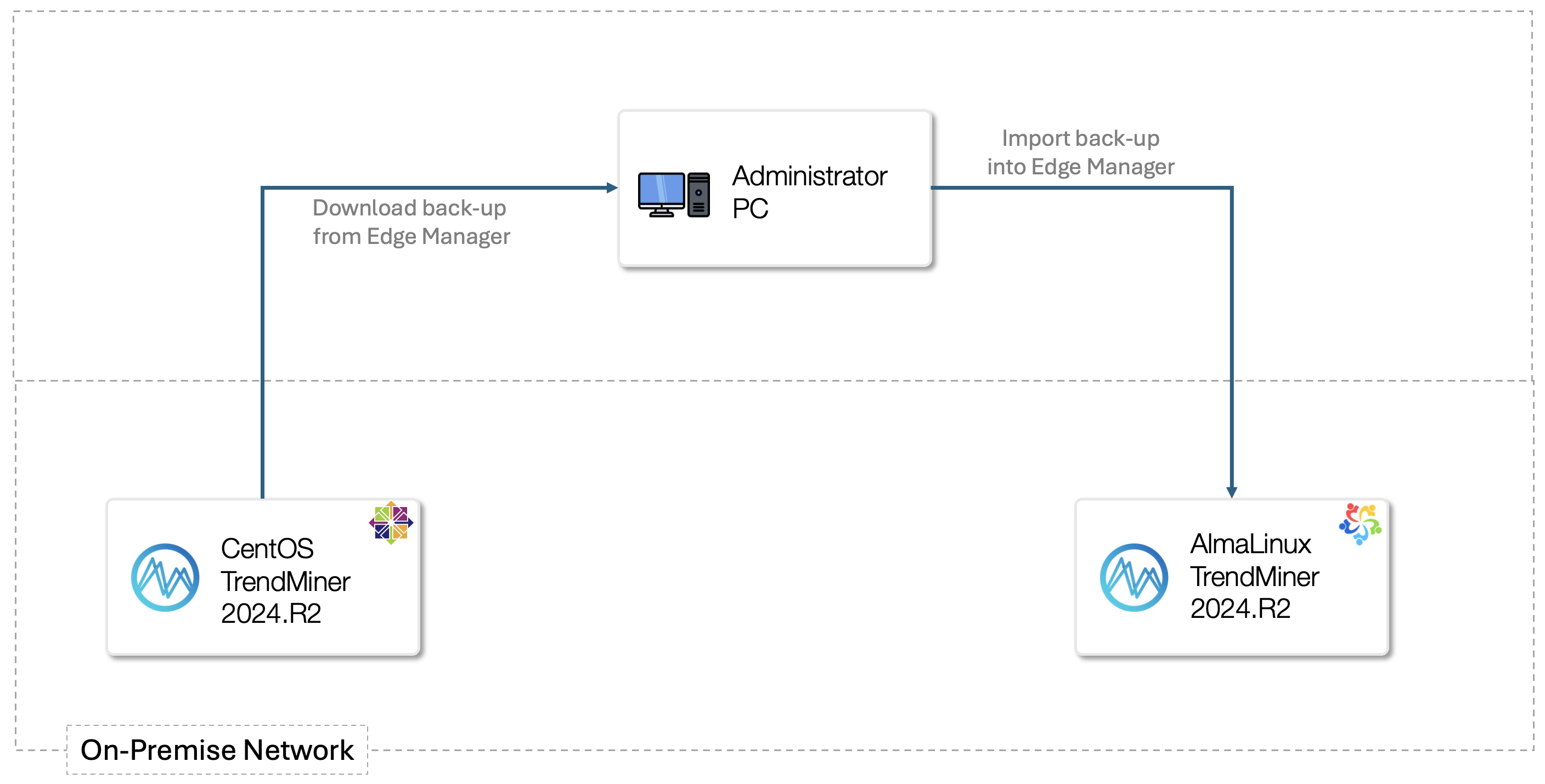

In this scenario, you are transitioning from an on-premises CentOS7 or RHEL7-based setup to an on-premises AlmaLinux OS9 or RHEL9 setup, and you have selected to go for the local backup and restore option, against the recommendation of TrendMiner.

Here's how you can accomplish this high level. More details will follow soon.
  1. Provision a New AlmaLinux or RHEL 9 Instance
  2. Install the TrendMiner Application (2024.R2.0) on the new AlmaLinux or RHEL 9 Instance
  3. Upgrade the source system applications
  4. Create a backup on the source system & download it
  5. [Optional] Create a list of currently indexed tags
  6. Import the TrendMiner Application Data on the target system by restoring the backup
  7. [Optional] Trigger the re-indexing of tags previously listed
  8. Test & validate the target server with a number of key users
  9. Fully switch to the target server and decommission the source system
