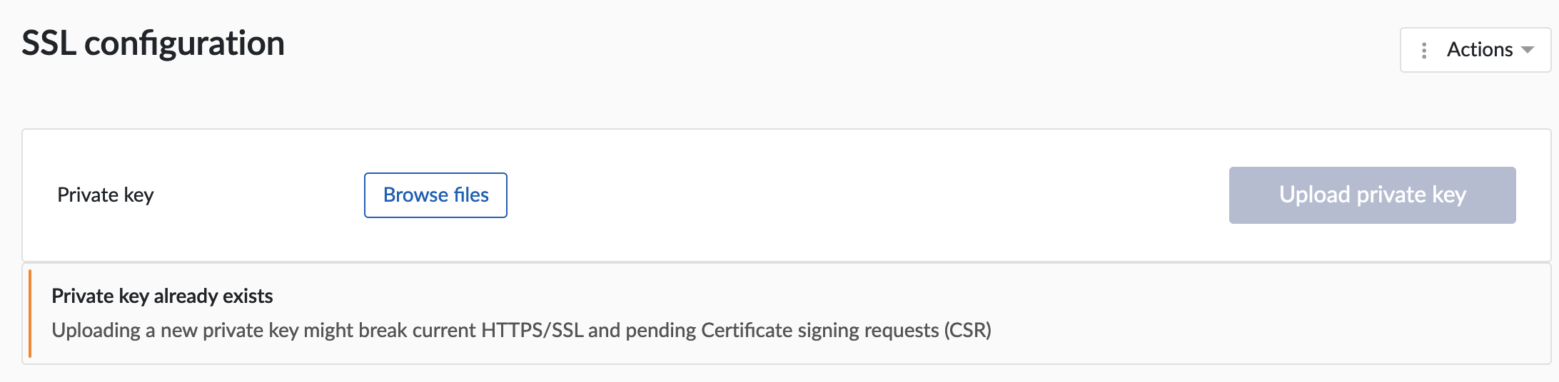

When a CSR was generated via ConfigHub the private key is already available on the server and no new private key has to be uploaded together with the certificates. This is indicated with the message "Uploading a new private key might break current HTTPS/SSL and pending Certificate signing requests (CSR)" in the ConfigHub UI.
ConfigHub_SSL_private key already exists-2023.R2.0
