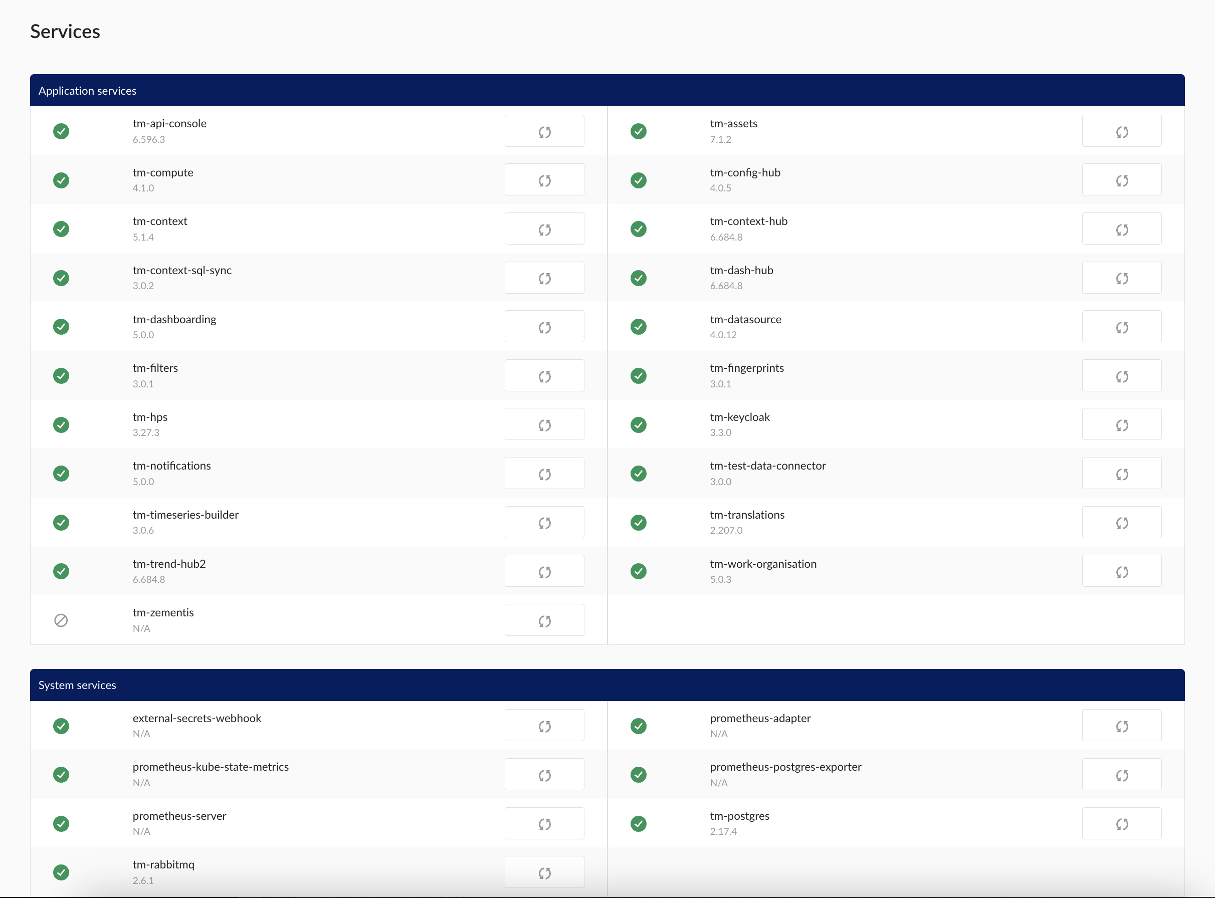

    Without MLHub:
    appliance_services-light-2023.R3.0

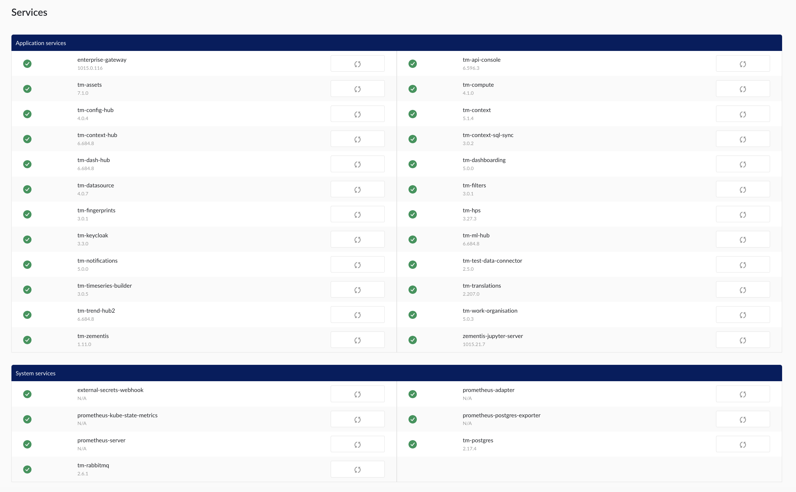

    With MLHub:
    appliance_services_2023.R3.0
