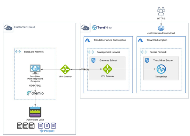

Architecture schema
Example reference architecture for TrendMiner SaaS with a cloud data source (Azure Data Lake in this example)
The analytics platform is deployed in a dedicated customer tenant in the cloud. This instance is managed and operated by TrendMiner.
On the customer side, the data lake is hosted in the cloud as well. Data is available through a query layer. For Azure, this could be for example an Azure data lake with a Dremio lake house, or Azure Data Explorer offering the Kusto Query Language (KQL).
The need for the Plant Integrations module depends on the cloud data source. Many have a direct connection available that can be configured. For others, custom connections can be created. In this case, the Plant Integrations module needs to be installed on a Windows Server.
A secure connection needs to be created between the TrendMiner cloud tenant and the customer's cloud environment. For example, through an Azure Virtual Network Peering.

In order to set up a secure connection between Customer Cloud and TrendMiner Azure environment different options can be considered:
- Azure virtual network peering
- Azure private link
- VPN with NAT
TrendMiner will work closely with Customer’s IT department on setting up this connection.
