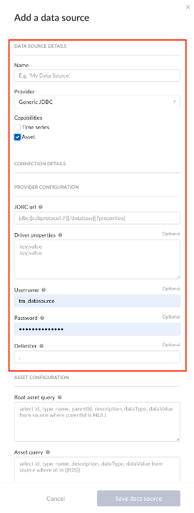

To add a Generic JDBC data source, in ConfigHub go to Data in the left side menu, then Data sources, choose + Add data source. Type the name of the data source, select “Generic JDBC” from the Provider dropdown. Selecting the capabilities for the data source with the given checkboxes will open additional properties to enter, grouped in following sections:
  • Provider configuration - lists properties related to the configuration of the connection that will be established with Generic JDBC
  • Time series configuration – lists properties relevant for the timeseries data
  • Asset configuration - lists properties relevant for asset data
Following properties need to be populated to establish the connection to the JDBC provider:
  • "Provider" - select the option "Generic JDBC" from the dropdown.
  • "Capabilities" - the Generic JDBC provider supports the Timeseries and Asset capabilities.
  • "JDBC url" - mandatory JDBC url to establish a connection to.
  • "Driver properties" - additional  optional driver specific properties can be configured here as key;value, where key is the name of driver specific property and value the desired value for this property. Please consult the documentation of the specific JDBC driver for more information.
  • "Username" - optional convenience field to enter the username used to establish a database connection. As an alternative this information can be entered through the driver properties.
  • "Password" - optional convenience field to enter the password used to establish a database connection. As an alternative this information can be entered through the driver properties.
  • "Delimiter" - optional delimiter override, used to parse data values of type STRING_ARRAY. The default is a comma (,)."Delimiter" - optional delimiter override, used to parse data values of type STRING_ARRAY. The default is a comma (,).

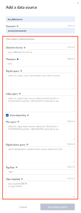

Following properties need to be entered to enable time series capability:
  • “Index query” - a query used by TrendMiner to ingest timeseries data for a specific tag. The query is expected to return a ts (timestamp) and a value. The following variables are available to be used in the WHERE clause of this query. The variables will be substituted at query execution with values.
  • “Internal plotting” - if this option is selected TrendMiner will use interpolation if needed to plot the timeseries on the chart on specific time ranges. If this value is not selected and no plot query was provided, TrendMiner will plot directly from the index.
  • “Plot query” – a query used by TrendMiner to plot timeseries data for a specific tag. The query is expected to return a ts (timestamp) and a value. The following variables are available to be used in the WHERE clause of this query. The variables will be substituted at query execution with values.
    • {STARTDATE}. TrendMiner will plot data per intervals of time. This denotes the start of such an interval.
    • {ENDDATE}. TrendMiner will plot data per intervals of time. This denotes the end of such an interval.
    1. customTypeA;ANALOG
    2. customTypeB;DIGITAL
    3. customTypeC;DISCRETE
    4. customTypeD;STRING
  • "DateTime format" - optional format your time series data are stored in.
  • "Timezone" – optional timezone your times series data are stored in. Default is UTC.

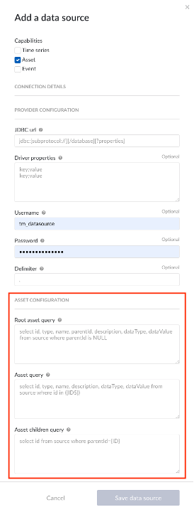

Following properties need to be entered to enable asset capability:
  • "Root asset query" - this query is responsible for returning all top level elements from the asset tree structure. It will be used to traverse further down the tree using to queries below. The order of the columns in the result needs to be:
    • id. Required, unique identifier for this asset record.
    • type. Required, TrendMiner can handle asset of type ASSET or ATTRIBUTE. This column must be one of these two values.
    • name. Required, name for this asset record.
    • description. Optional, description for this asset record.
    • data type. Optional, TrendMiner can ingest 4 different types of data in case the asset is of type ATTRIBUTE. This column will impact on how the data value column will be interpreted:
      • STRING data value is interpreted as text
      • STRING_ARRAY comma delimited string
      • NUMERIC
      • DATA_REFERENCE
    • data value. Optional, this column will either be interpreted as text (STRING), a collection of text (STRING_ARRAY), a number (NUMERIC), or a reference to a tag (DATA_REFERENCE).
  • "Asset query" - this query returns details for a specific asset record. The following variables are available to be used in the where clause of this query. The variables will be substituted at query execution with values:
    • {ID}. The id as the unique asset identification.
      • NUMERIC
      • DATA_REFERENCE
  • "Asset children query" - this query returns the ids of the direct descendants of the asset. The id passed is the parent, the records returned are its child nodes.  The following variables are available to be used in the where clause of this query. The variables will be substituted at query execution with values:
