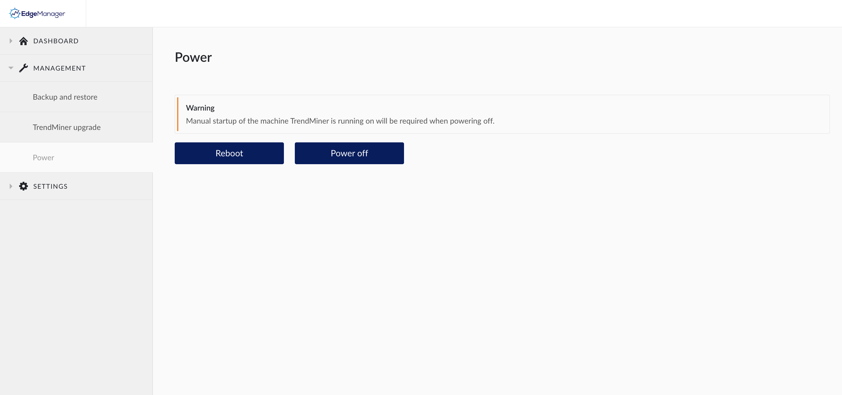

When not using the TrendMiner Virtual Appliance, please follow the existing internal procedure to reboot the server. Reboot the TrendMiner Virtual Appliance from the Edge Manager portal. Expand the ‘MANAGEMENT’ menu and go to the ‘Power’ section. Click ‘Reboot’ button.

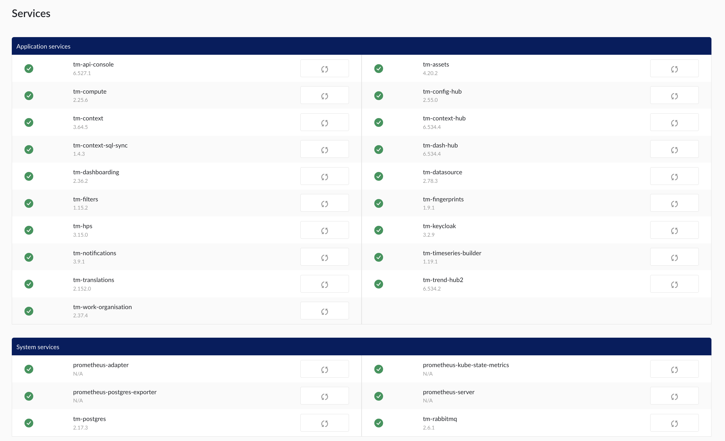

Once rebooted, make sure all the services are healthy in the 'DASHBOARD' -> ‘Services’ page.
