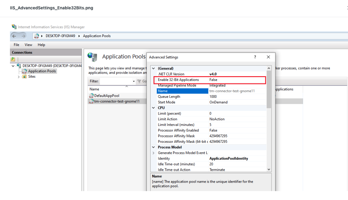

This is important since connectivity will only work when the target data source and the driver used to connect match each other. TrendMiner's plant integrations will by default run 64-bit. If your connectivity depends on a 32-bit driver, the application pool setting needs to be changed.
Figure 1. Enable 32-Bit Applications attribute
Change the property for "Enable 32-Bit Applications" to True and restart the application pool. The Plant Integrations will now run in 32-bit.
Warning
Note that the same connector cannot run both 32-bit and 64-bit drivers at the same time. If you plan on using a 32-bit driver for one or more data sources, and 64-bit for the others, you need to install 2 Plant Integrations connectors side-by-side by deploying a second IIS website. This can be done on the same server following the same installation steps but assigning a new user, a different IP port, etc.
Incorrect settings will result in the connector api web interface not loading in the browser. Instead an error will be shown: "Could not load file or assembly <driver name> or one of its dependencies. An attempt was made to load a program with an incorrect format."
