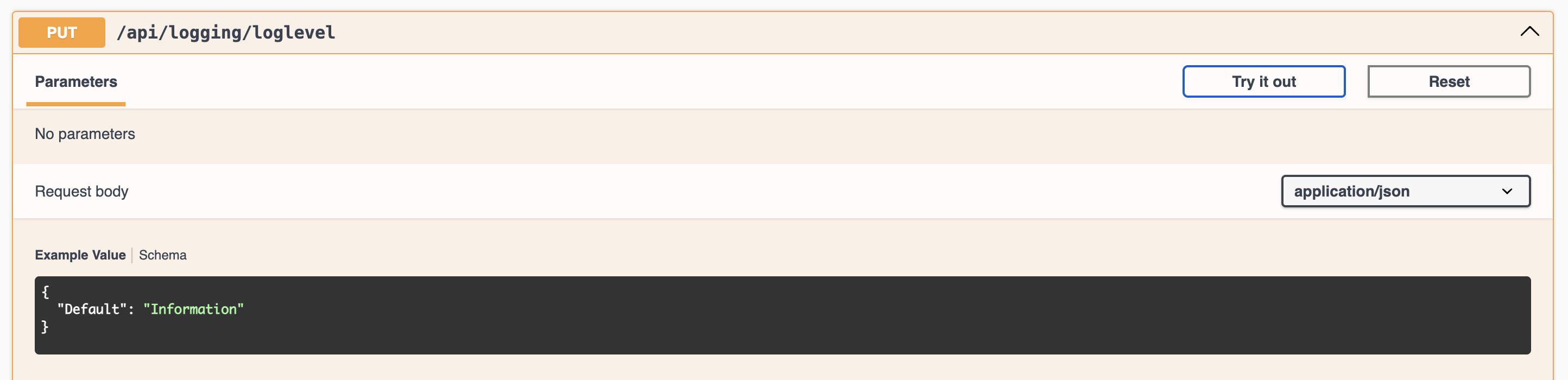

Changing the log level can be done by doing a PUT on the connector API (via Swagger) at the /api/logging/loglevel endpoint.
