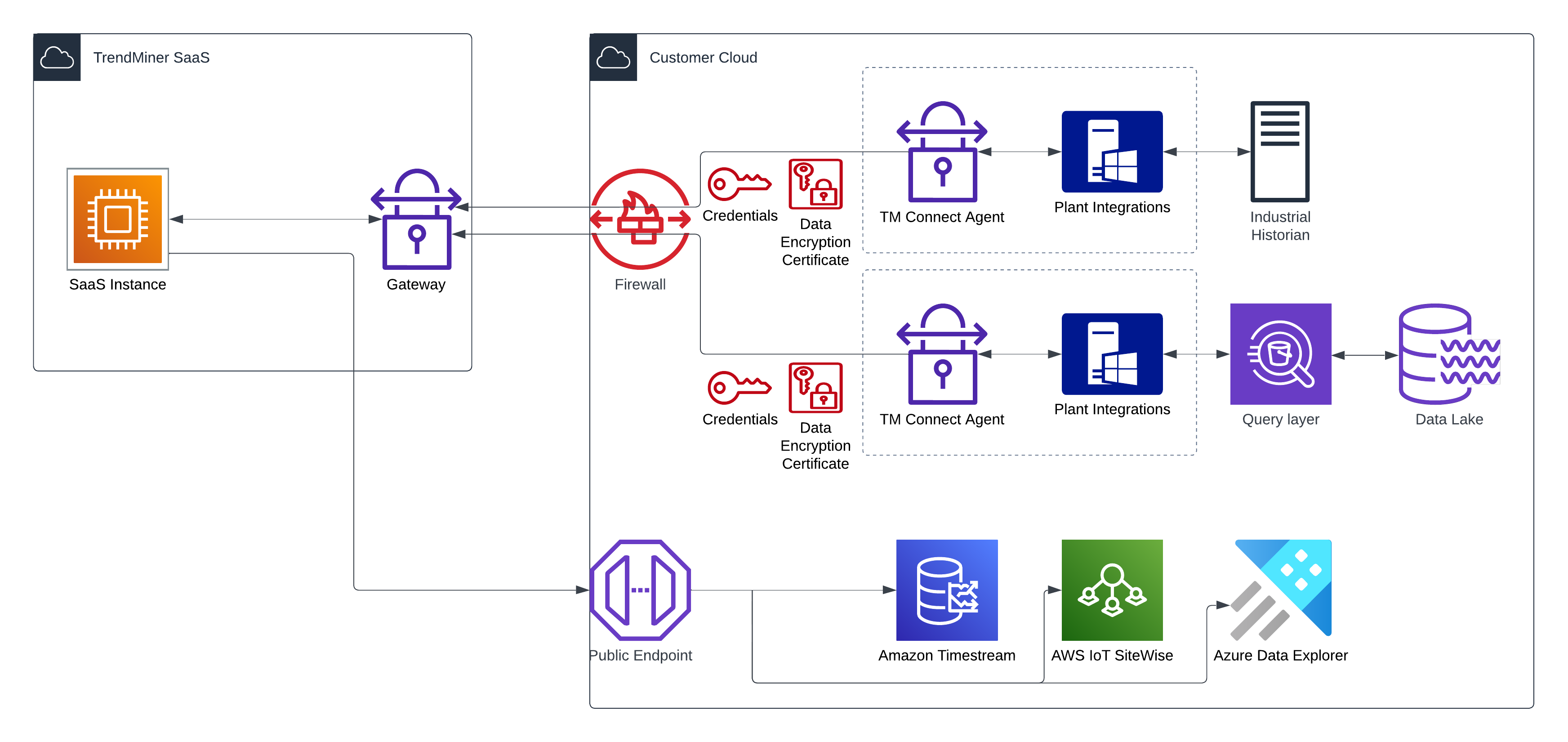

Architecture schema
Example reference architecture for TrendMiner SaaS with a cloud data source
The need for the Plant Integrations module depends on the cloud data source. Many have a direct connection available that can be configured. For others, custom connections can be created. In this case, the Plant Integrations module needs to be installed on a Windows Server.

Datasource connection
Data Lake:
The connection between the cloud data source and TrendMiner is usually done through a query layer. In general, this layer provides JDBC/ODBC connectivity and the ability to run queries (e.g. SQL or KQL) against the data source.
For generic or custom connections, the installation of the Plant Integrations module is required. This module exposes access to read data over a REST-based API (HTTP or HTTPS). TrendMiner only accesses this connector, not the data source directly.
The ingestion flow is outside of the scope of this reference architecture, as it is not important for TrendMiner how data arrives in the data lake, as long as it can be queried.
Cloud-native data sources:
Public Endpoint needs to be available in order to connect to such data sources as AWS IoT SiteWise, Amazon Timestream, Microsoft Azure Data Explorer (Kusto ADX). Connection will be established from TrendMiner SaaS Environment.
