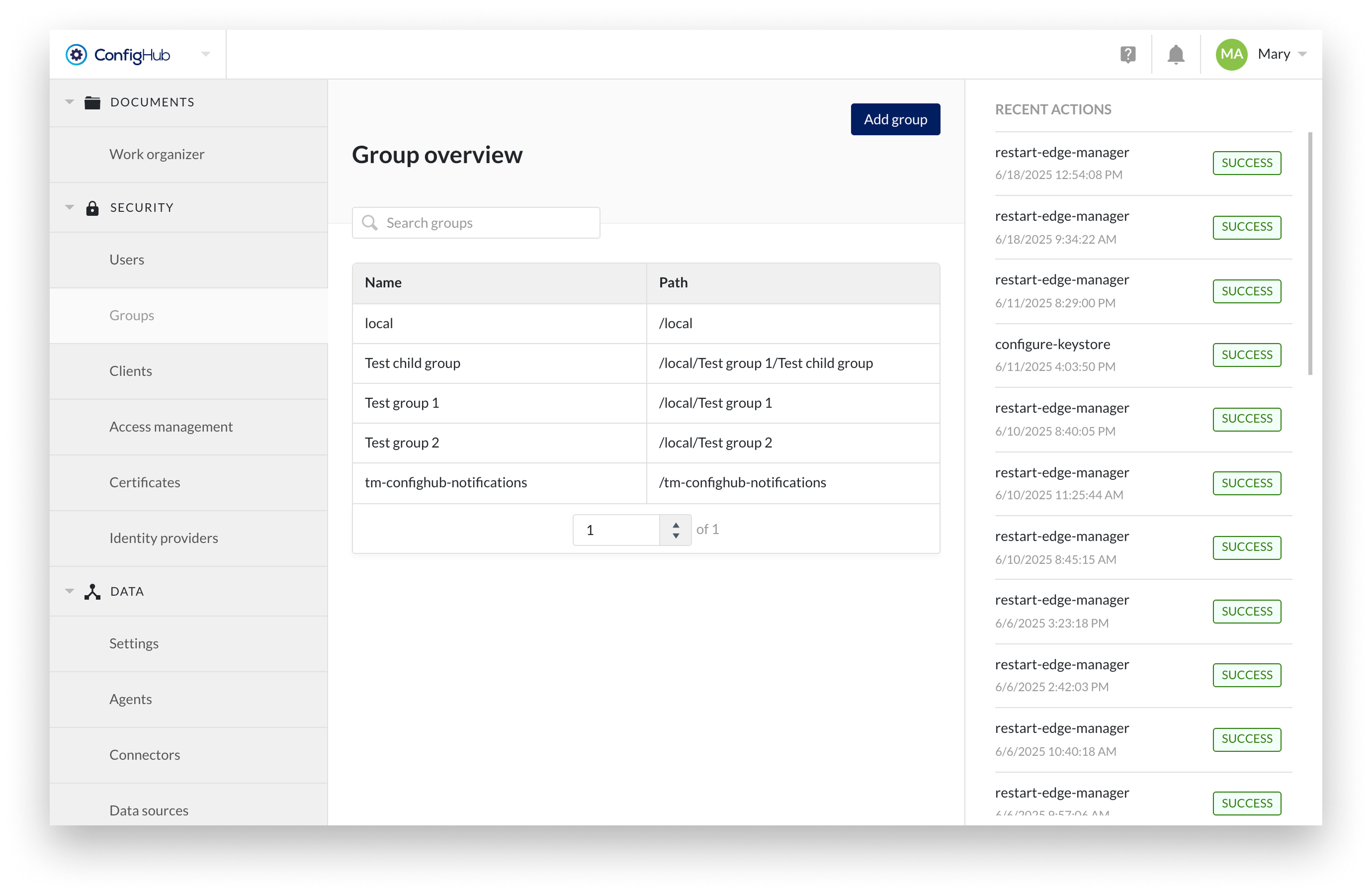

Group management allows the creation of a collection of users and other groups (i.e. nested groups). An overview of all existing groups can be found under the "SECURITY" section in ConfigHub.
The group overview shows the group name and path of the groups so that it can be linked to its corresponding identity provider.
Specific groups can be searched through via the top right search bar above the table.

To create a new group you will need to go to the Groups menu under the "SECURITY" section. From there groups can be added via the “Add group” button.
