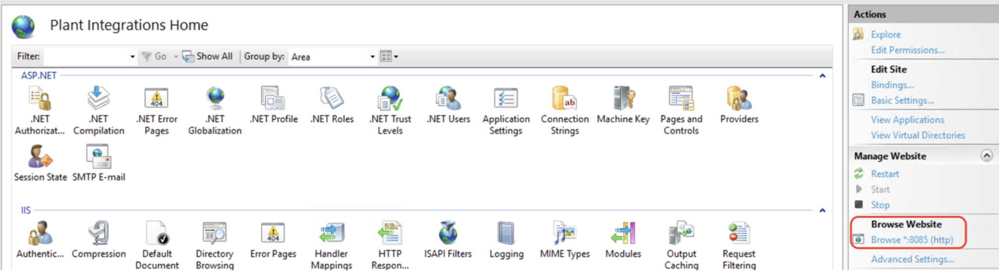

Option 2: In the IIS manager, by clicking on the Plant Integrations site and browsing website
