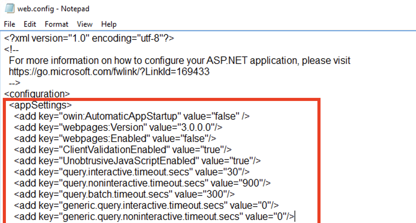

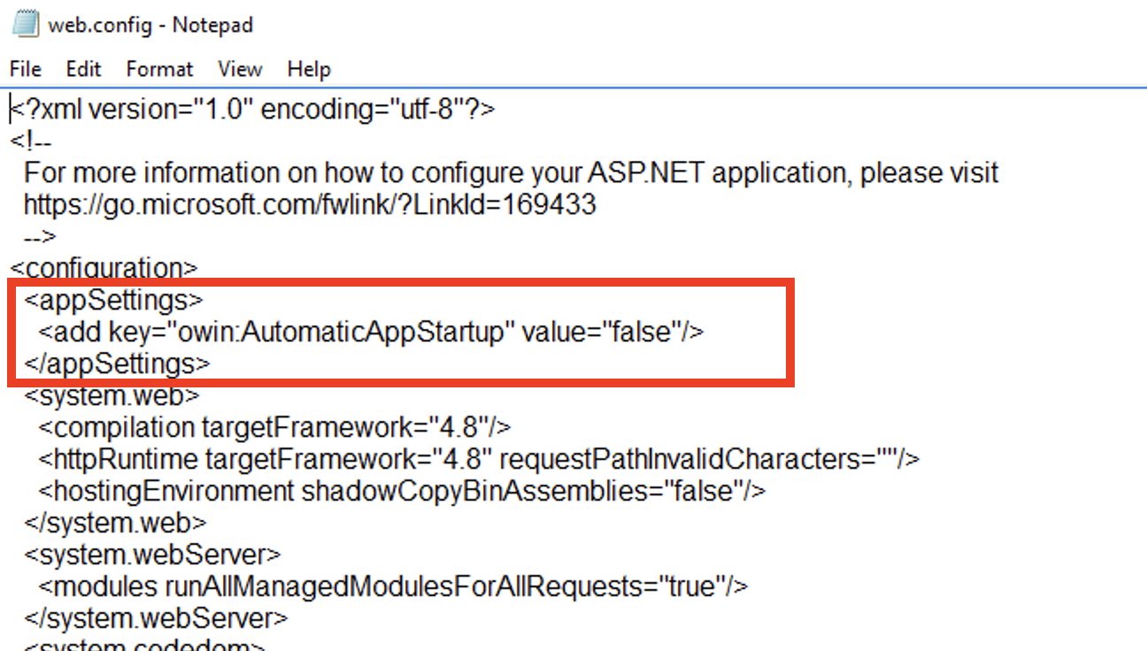

    Open both the web.config file which is located in the backup of your Plant Integration folder and the web.config which is in your Plant Integration folder (usually located at C:\inetpub\PlantIntegrations). The web.config in your installation directory contains 1 or max a few keys under <appSettings>.
    Copy over all keys under <appSettings> from the backup web.config to the current active web.config in the installation directory, e.g. like in the image below.
