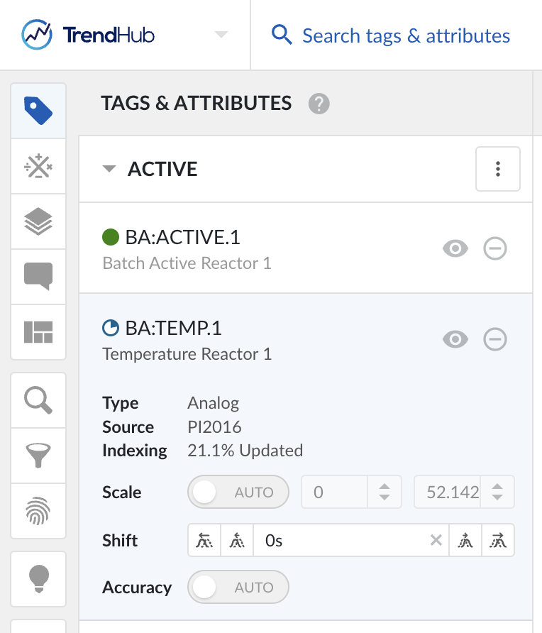

Start typing a tag name inside of the search box.
Tags that match the input will show up in the dropdown. Click on the plus icon (+) to visualize. TrendMiner displays a trend view of the tag and starts the indexing process.
