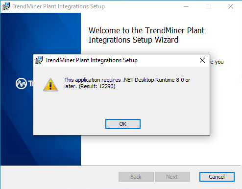

The installer currently does not bundle/install the .NET (Framework) dependencies that are required to run the application. Therefore, we need to install the following components before starting the installer:
.NET Framework 4.8 Runtime (Download .NET Framework 4.8 Offline Installer)
ASP.NET Core Runtime 8.0 (Hosting Bundle) or later (Download ASP.NET Core 8.0 Runtime (v8.0.17) - Windows Hosting Bundle Installer )
.NET Desktop Runtime 8.0 or later (Download .NET 8.0 Desktop Runtime (v8.0.17) - Windows x64 Installer )
The installer will detect whether these components are installed. If they are not, an error message will be displayed indicating that these components are required.
For reference, the detection of .NET (DotNetCompatibilityCheck) can yield the following result code:
0 - Successful compatibility check.
13 - Requested platform is not compatible with OS.
12289 - No runtime is installed.
12290 - Required runtime is not installed.
12291 - Failed to get hostfxr exports.
12292 - Invalid arguments.
12293 - Failed to construct temp json file path.
12294 - Failed to create temp json file.

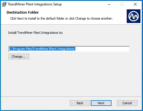

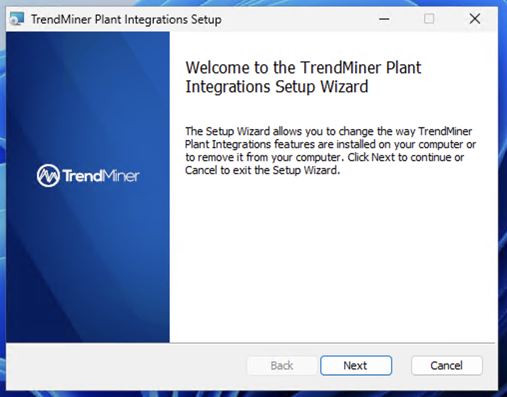

The installation process is straightforward.
Users are required to accept the license agreement and may optionally specify a custom installation directory. By default, the software is installed in the C:\Program Files\TrendMiner\Plant Integrations\ directory.
The installer will perform the following steps during the installation of Plant Integrations:

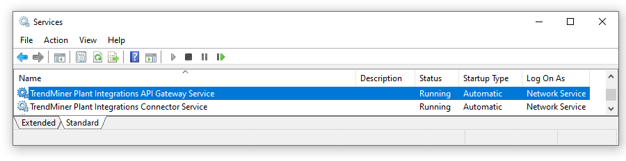

Validation
To validate the installation you can use the “Services” management console to check that the application is running:

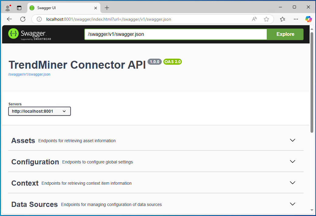

The swagger endpoint is available on http://localhost:8001/swagger
