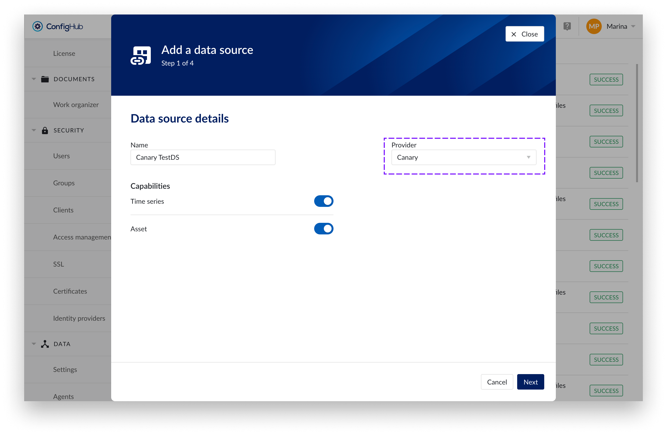

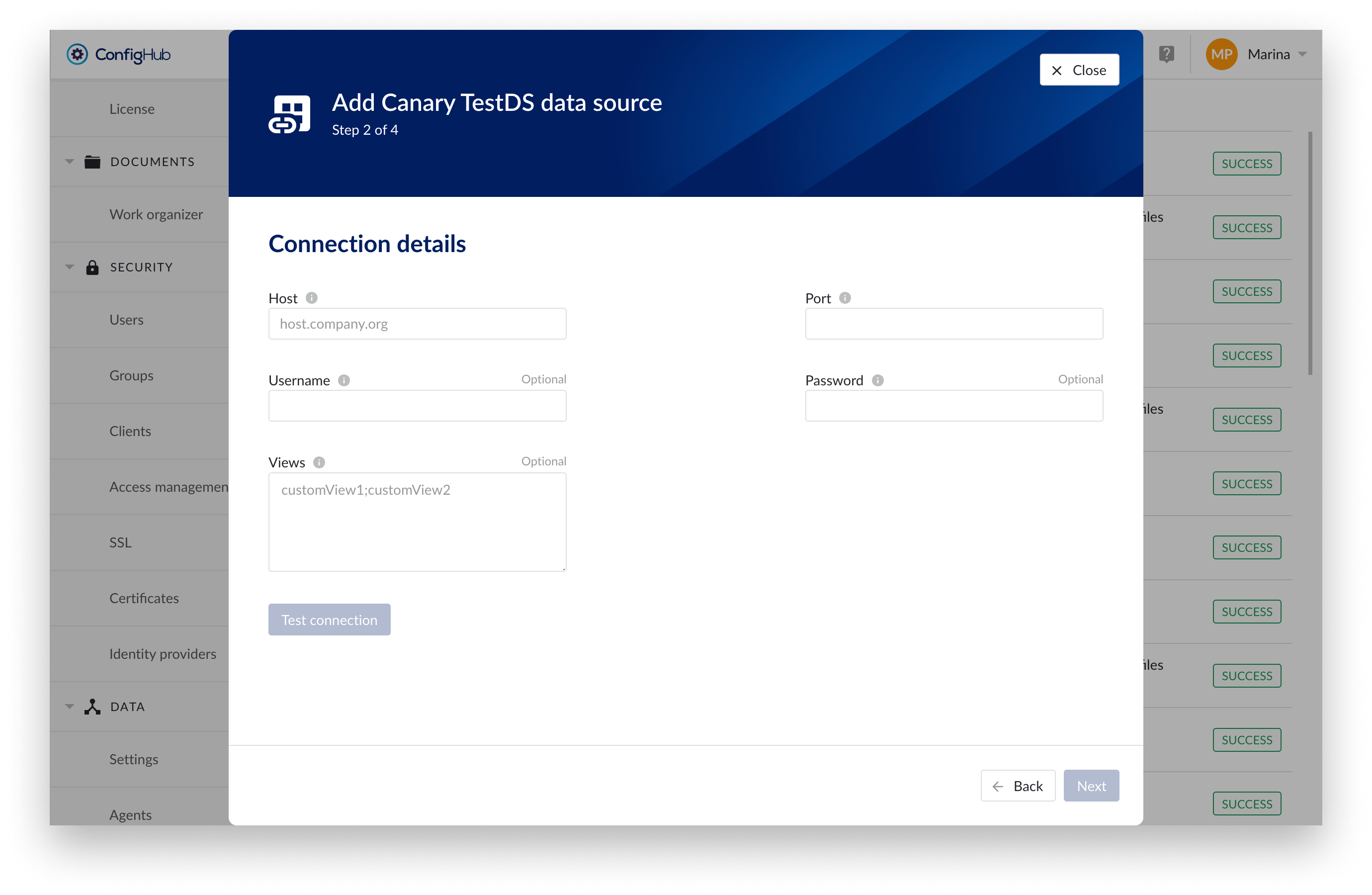

To add a Canary data source, in ConfigHub go to Data in the left side menu, then Data sources, choose + Add data source. Fill out 'Data source details' on the first step of the datasource creation wizard: type the name of the data source, select “Canary” from the Provider dropdown. Selecting the capabilities for the data source with the given checkboxes will open additional properties to enter, grouped in following sections:
Connection details - lists properties related to the configuration of the connection that will be established with datasource.
Time series details - lists properties relevant for context data
Asset details - lists properties relevant for asset data

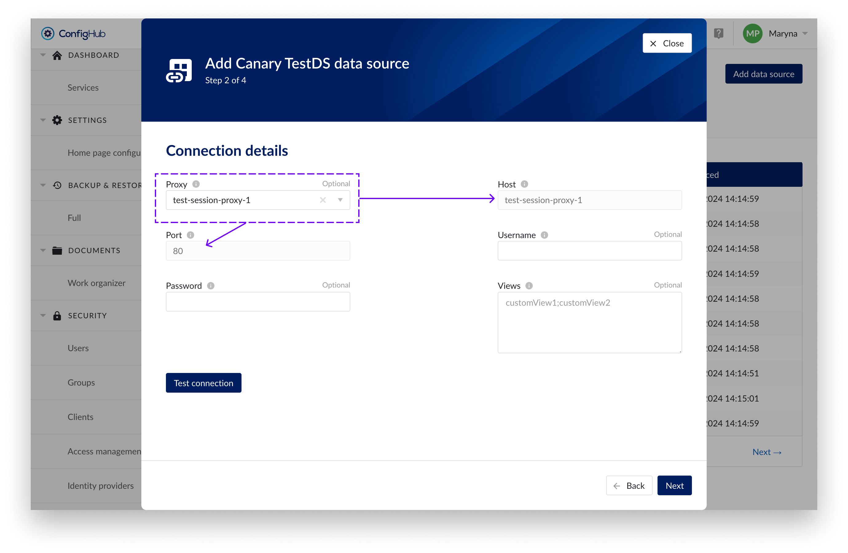

Following properties need to be populated to establish the connection to the Canary historian:
“Host" - mandatory host URL of Canary historian
“Port" - mandatory port of Canary historian
"Username" - mandatory username used to establish a connection to Canary historian
"Password" - mandatory password used to establish a connection to Canary historian
“Views" - optional field that allows you to specify views the data will be ingested from:
If a view or multiple views are defined, only tags and assets within these views are ingested.
If no view is defined, the datasource will ingest all data regardless of the views.
You can connect to the Canary server using two options: via TM-Connect (TrendMiner Connect Agent) or without TM-Connect. For further information, please refer to Establishing a connection to Canary for more details.
For SaaS environments only. When connecting to the Canary historian via the TM-Connect tunnel, you can choose a pre-configured proxy from the "Proxy" dropdown menu. Upon selection, the host field will be automatically populated with the proxy name and the port field will be automatically populated with value 80. The fields will become read-only.

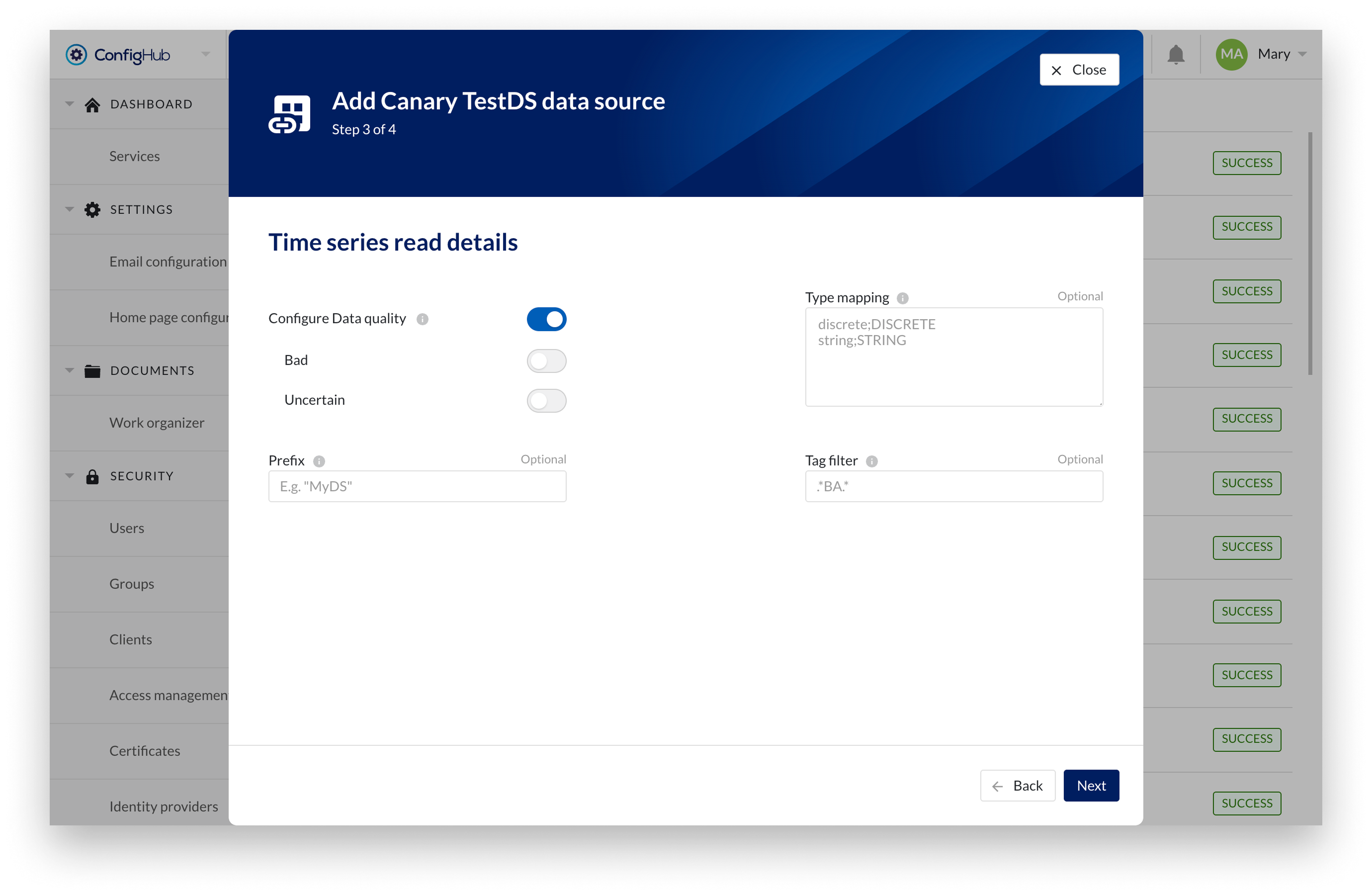

Following properties need to be populated to configure time series capability:
“Configure Data quality” - optional field that allows you to specify the quality of data to ingest. By default, only time series values with GOOD quality are ingested. However, you can choose to include time series values with BAD and/or UNCERTAIN quality as well.
“Tag filter” - optional regular expression can be entered here. Only tags with names that match this regex will be retained when creating tags.
"Type mapping" - If types differ from what TrendMiner uses, a custom type mapping can be entered here. It can contain multiple lines and expects per line the value to be representing a custom type followed by a semicolon (";") and a TrendMiner type: e.g.
customTypeA;ANALOGDefault tag type mappings between Canary and TrendMiner are documented here: How does TrendMiner determine tag type?

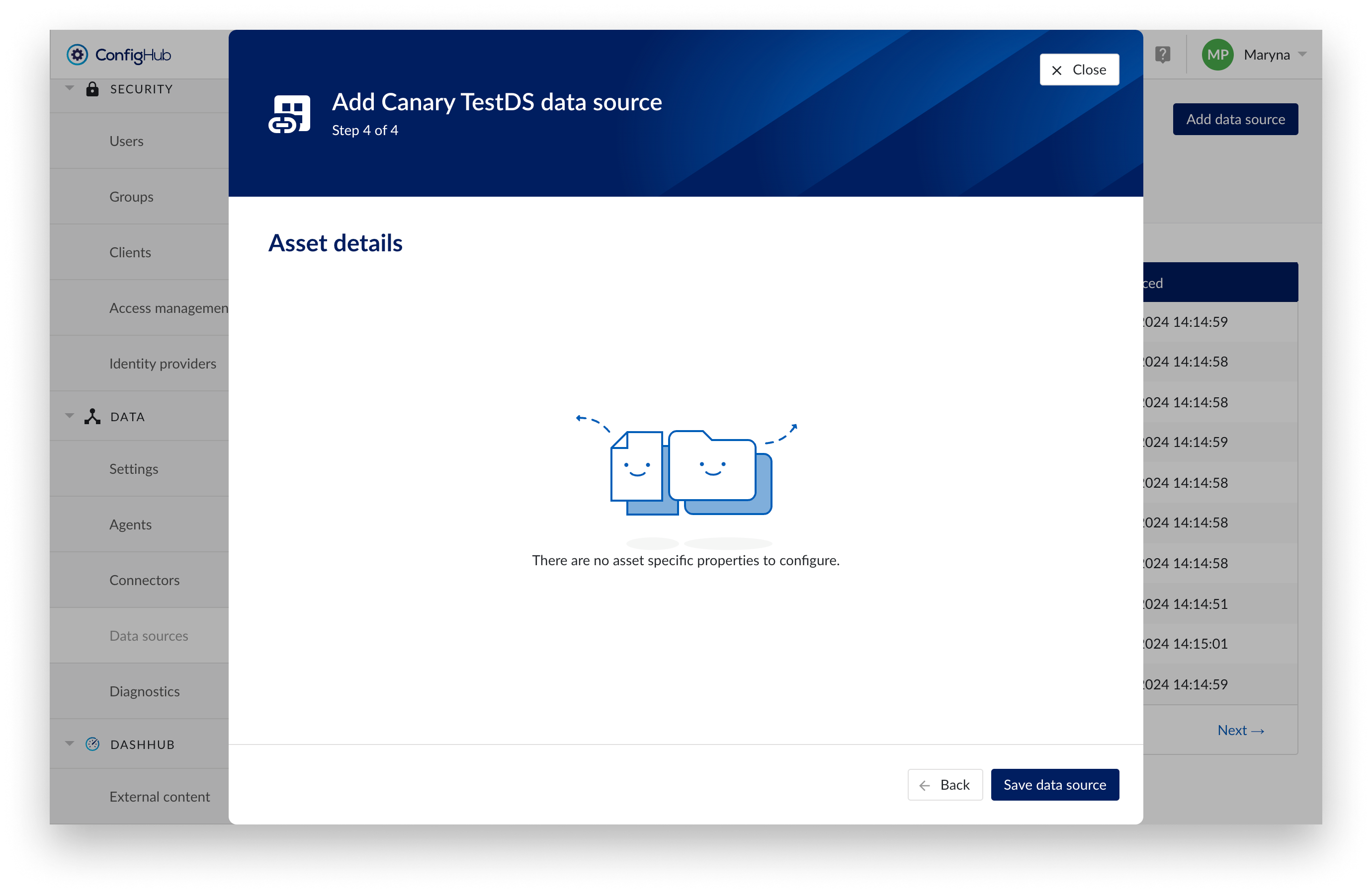

Asset capability
There are no asset specific properties to configure for Canary provider.

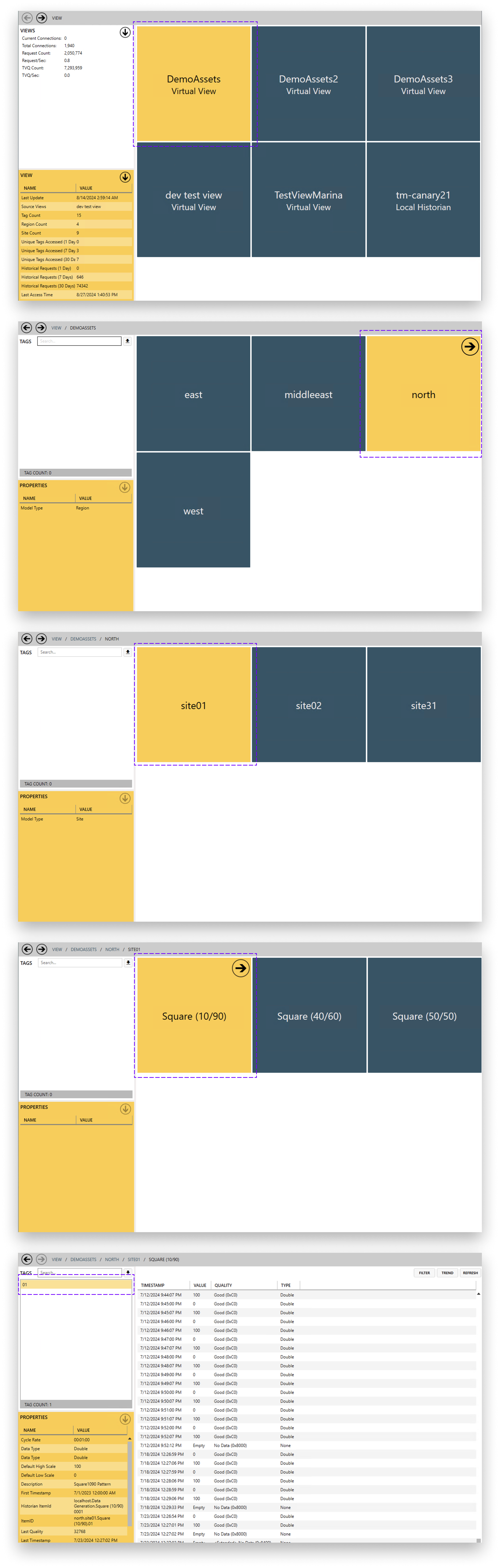

Asset tree in TrendMiner is built based on Canary virtual view that contains asset types. The node names represent assets of type ASSET, while the underlying tags are classified as assets of type ATTRIBUTE and can be added to the trend chart.
Example of asset structure in Canary Historian:
Example of corresponding asset tree in TrendMiner:
