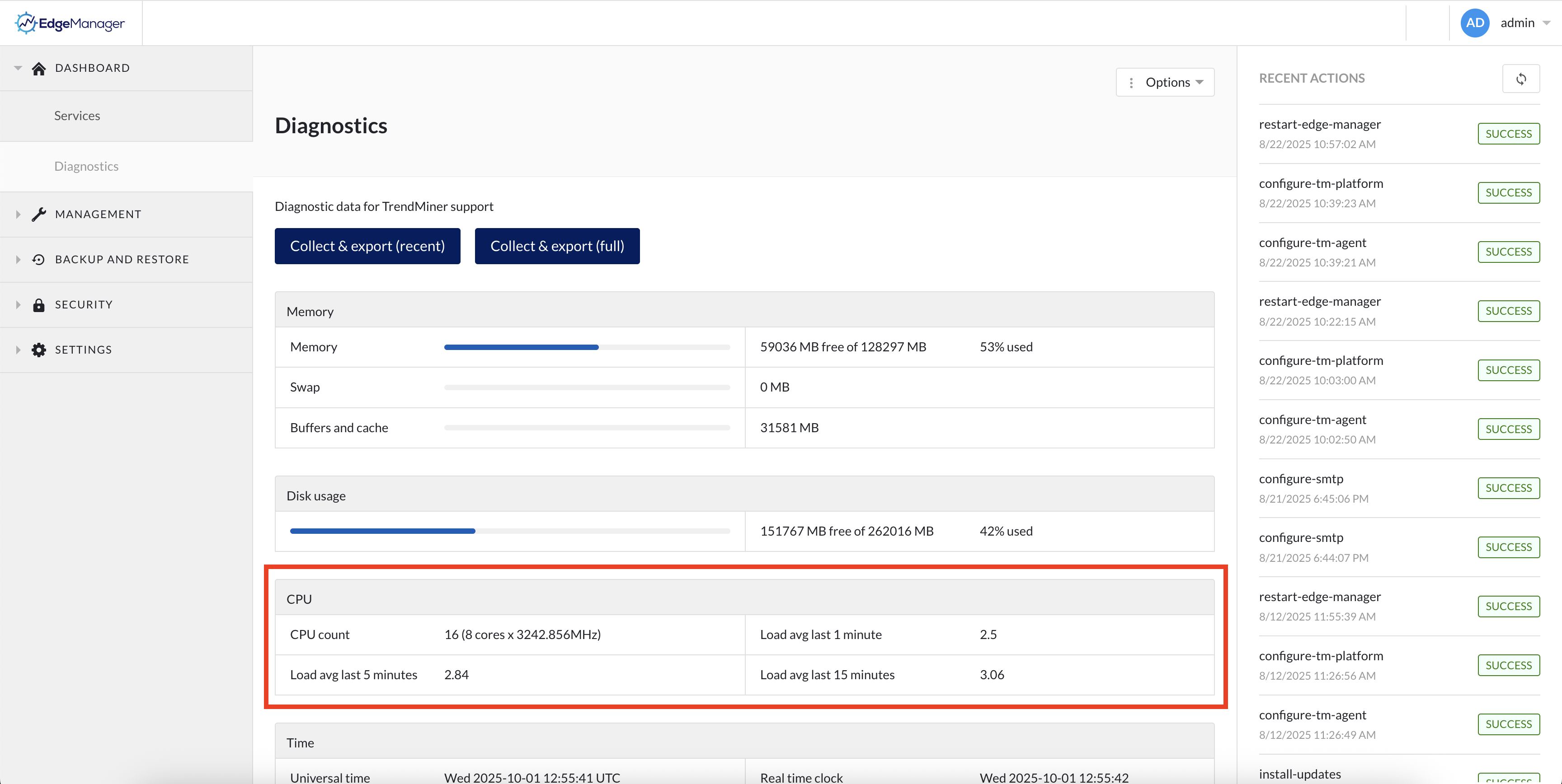

CPU
Insight in available vCPU and actual CPU usage of TrendMiner.
The CPU load values represent the average number of runnable or waiting processes (CPU + I/O). Think of it as “how many people are standing in line for the CPU”. A value of 1.00 on a single-core system means the CPU is fully utilized. On a quad-core system, 4.00 would mean full utilization.
If you have 16 CPU cores the "safe" load threshold is around 16.00.
Load < number of cores → system is healthy.
Load ≈ number of cores → system is busy but OK.
Load > number of cores → system is overloaded (processes are waiting).

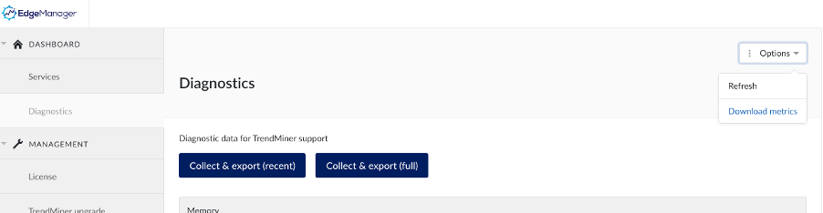

Export metrics
Via the “Options” button at the top right, you can click “Download metrics”, to trigger the export of the metrics data.
More information about metrics collection can be found here: License audit
