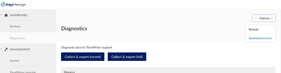

The Edge Manager diagnostics page contains the following functionality:
Extract appliance logs
  • "Collect and export (recent)": when clicked, TrendMiner will generate an archive file containing the 'light logs' and start the download once the archive file is available. The 'light logs'/'recent logs' will contain only recent data and will also contain less data. Gather these logs for issues which occurred the last day(s) and are unrelated to performance or service crashes.
  • "Collect and export (full)": when clicked, TrendMiner will generate an archive file containing the 'full logs' and start the download once the archive file is available. The full logs will contain more historical logging (up to a week or longer) and will contain more data. The full logs are required for more profound troubleshooting, performance analyses, ...
When in doubt about which log files to collect, please collect the full logs.

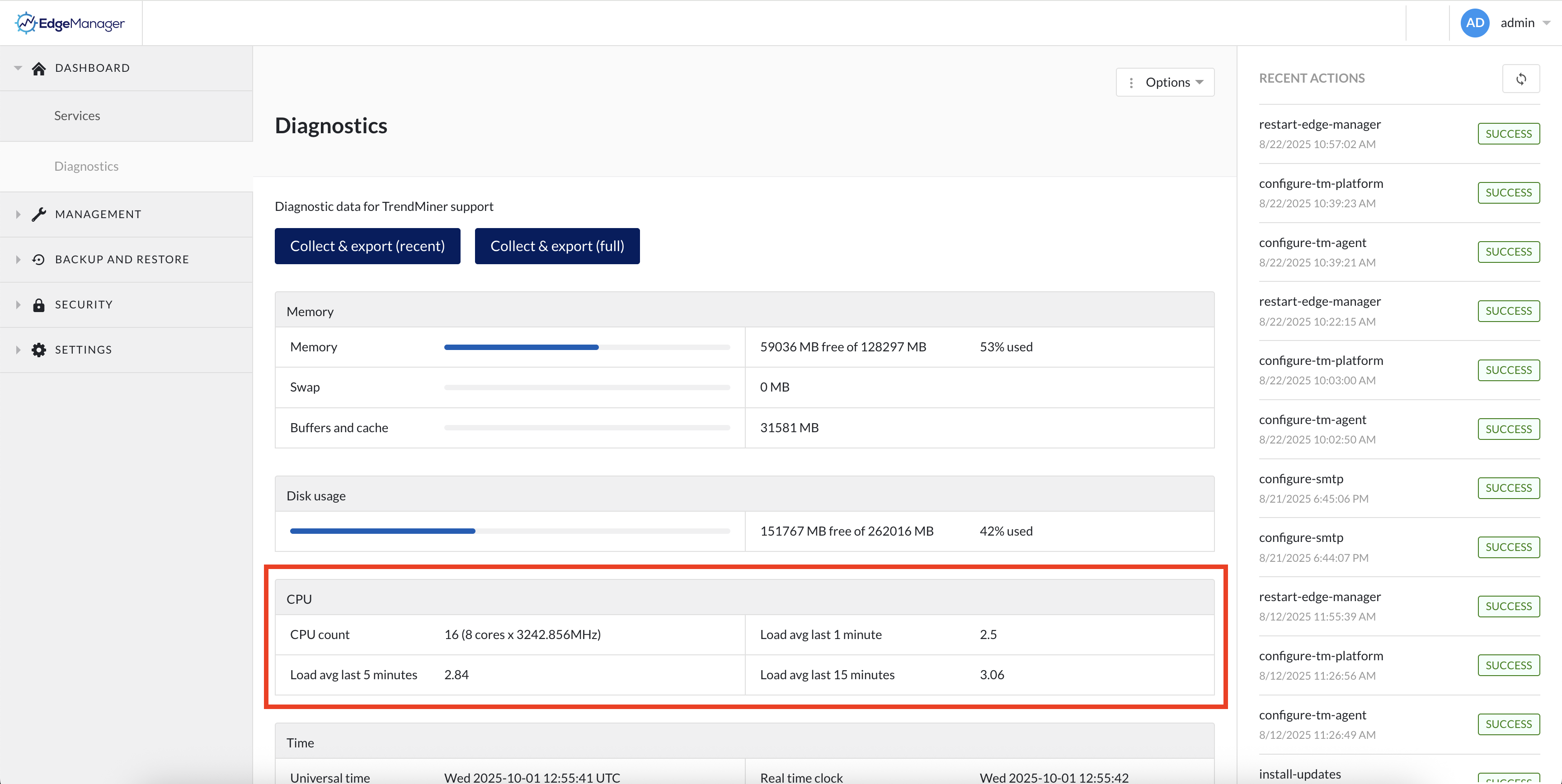

Memory
Insight in available memory and memory usage of TrendMiner.
Tip
The memory usage you see in ConfigHub is expected to be high since Linux occupies all available memory. More info can be found here: https://www.linuxatemyram.com
Memory usage will stay high even if you would add more RAM.
Disk usage
This table shows the available disk space and the total disk space of the /mnt/data volume (the volume on which the TrendMiner appliance is installed and TrendMiner stores its data).
Next to the /mnt/data volume there is also the root volume, on which the OS and system services are running. Both the root volume and the /mnt/data volume can run out of disk space which in both cases will result in service interruption.
The root volume total disk space and usage is not shown in Edge Manager since TrendMiner does not actively use this volume. Disk space issues should not occur on this volume if the system requirements are met. For more info on the required disk space of both the root volume and the /mnt/data volume, please contact our server requirements page.

CPU
Insight in available vCPU and actual CPU usage of TrendMiner.
The CPU load values represent the average number of runnable or waiting processes (CPU + I/O). Think of it as “how many people are standing in line for the CPU”. A value of 1.00 on a single-core system means the CPU is fully utilized. On a quad-core system, 4.00 would mean full utilization.
If you have 16 CPU cores the "safe" load threshold is around 16.00.
  • Load < number of cores → system is healthy.
  • Load ≈ number of cores → system is busy but OK.
  • Load > number of cores → system is overloaded (processes are waiting).

Export metrics
Via the “Options” button at the top right, you can click “Download metrics”, to trigger the export of the metrics data.
