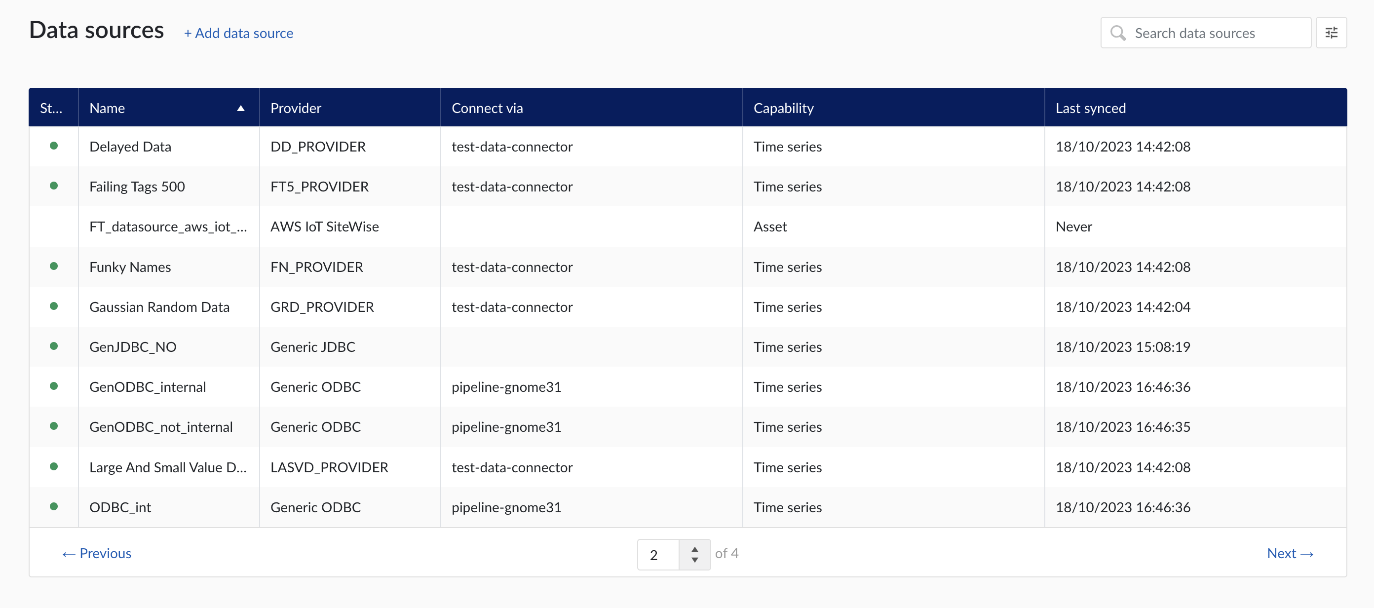

Data sources
When clicking on the Data sources menu option, the data sources overview is shown :
Data sources overview
Add a new data source by clicking the (+ Add data source) label next to the title. An "Add a data source" modal will appear.

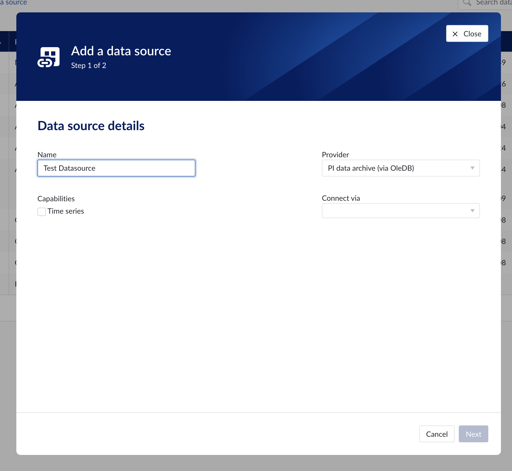

Data source details
Populate the fields on the Data source details step:
  • Name: you are free to choose data source names but they are mandatory, case insensitive and unique. The name of a data source identifies the data source. We strongly advise to only use alphanumerical and '-' or '_' in data source names as other characters are not supported in the access management so using special characters in a data source name might give issues when you want to assign access permission to the data source later on.
  • Provider: TrendMiner provides some out of the box connectivity to data sources via specific vendor implementations (e.g. OSIsoft PI, Honeywell PHD,...) and via more generic alternatives (e.g. Generic JDBC, ODBC, OleDB, ...). The provider 'TM connector' enables the  connection of data sources via a connector to connector setup. To connect a data source via multiple connectors, extra configuration is needed via the TrendMiner Connector API.
  • Connect via: this dropdown is used to select a connector which is used to connect to the data source. The dropdown is displayed based on the selected provider: some data sources need to be connected via a connector (e.g. OSIsoft PI, Generic ODBC, Wonderware, ...), while others don't need any connector (e.g. Amazon Timestream, Generic JDBC, AWS IoT SiteWise, ...). To add a data source that needs a connector,  the connector needs to be added first.
  • Capabilities: Capabilities depend on provider implementation. Some datasources have only one capability (e.g.  Amazon Timestream has Time series capability only), others have all 3 capabilities (e.g. AWS IoT SiteWise). Selecting the capabilities for the data source with the given checkboxes will open additional properties to enter, grouped in following sections:
    • Connection details - lists properties related to the configuration of the connection that will be established with datasource
    • Time series details – lists properties relevant for the time series data
    • Asset details - lists properties relevant for asset data
    • Context details - lists properties relevant for context data
Duplicate tag names are not supported. If 2 tags with exactly the same name are synced to TrendMiner, analytics, calculations and indexing on/for these tags might fail. Use data source prefixes to avoid possible duplicate tag name issues.
Depending on the provider you select, the connection details required for completion may differ.

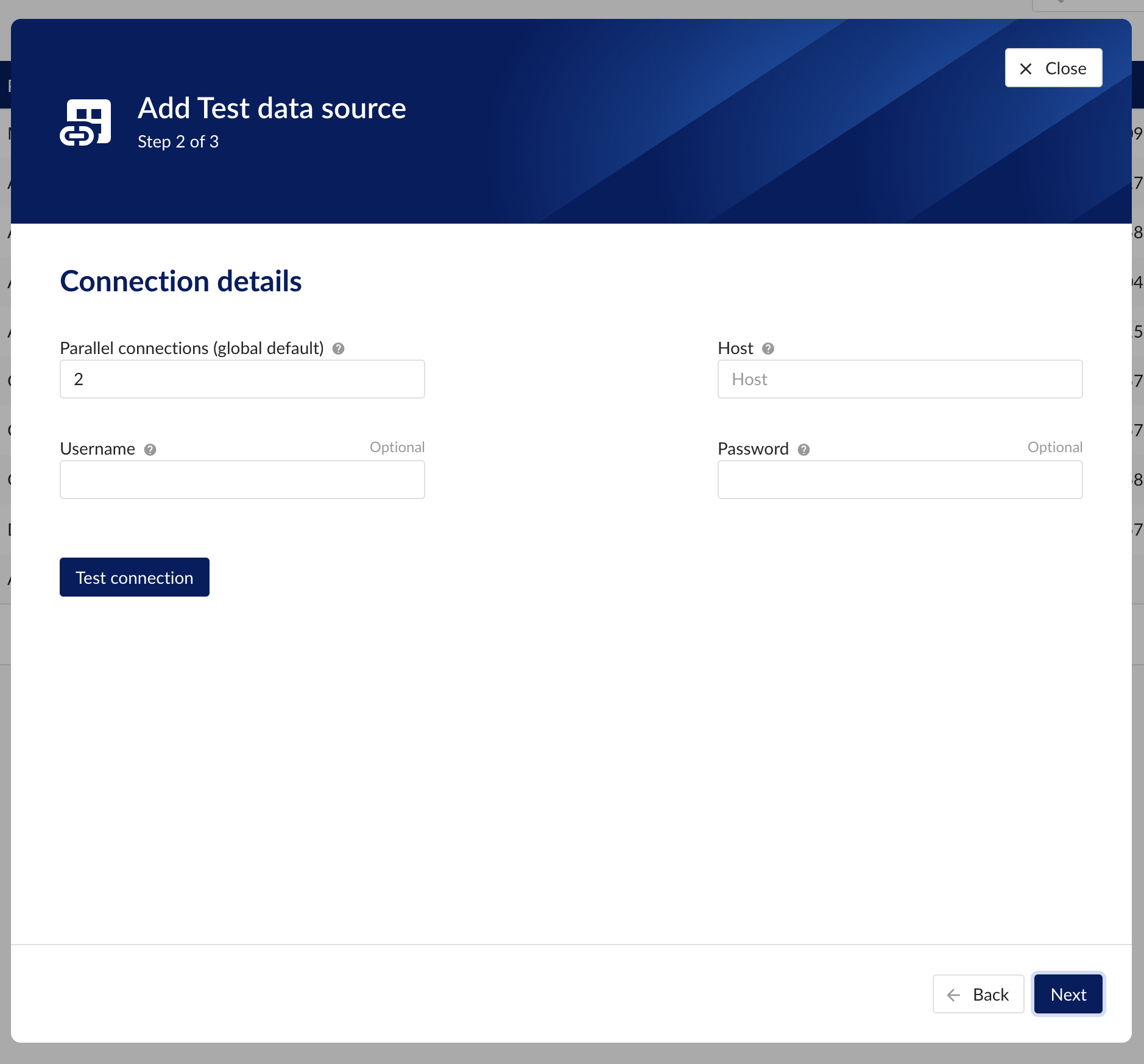

Connection details
Populate the fields on the Connection details step:
  • Parallel connections (if any): Each data source has 2 queues: one interactive - plot calls, one non-interactive - index calls, batch calls etc. Parallel connections determine how many connections each queue has to the connector. By default there are 2 parallel connections to the connector.
  • Host: the host name of the data source, e.g. myhistorian.mycompany.com
  • Username: username of the account configured in the data source.
  • Password: password of the account configured in the data source.
Once all mandatory fields are filled in, 'Test connection' button becomes enabled. By clicking on the button, user can verify the connection to the datasource.

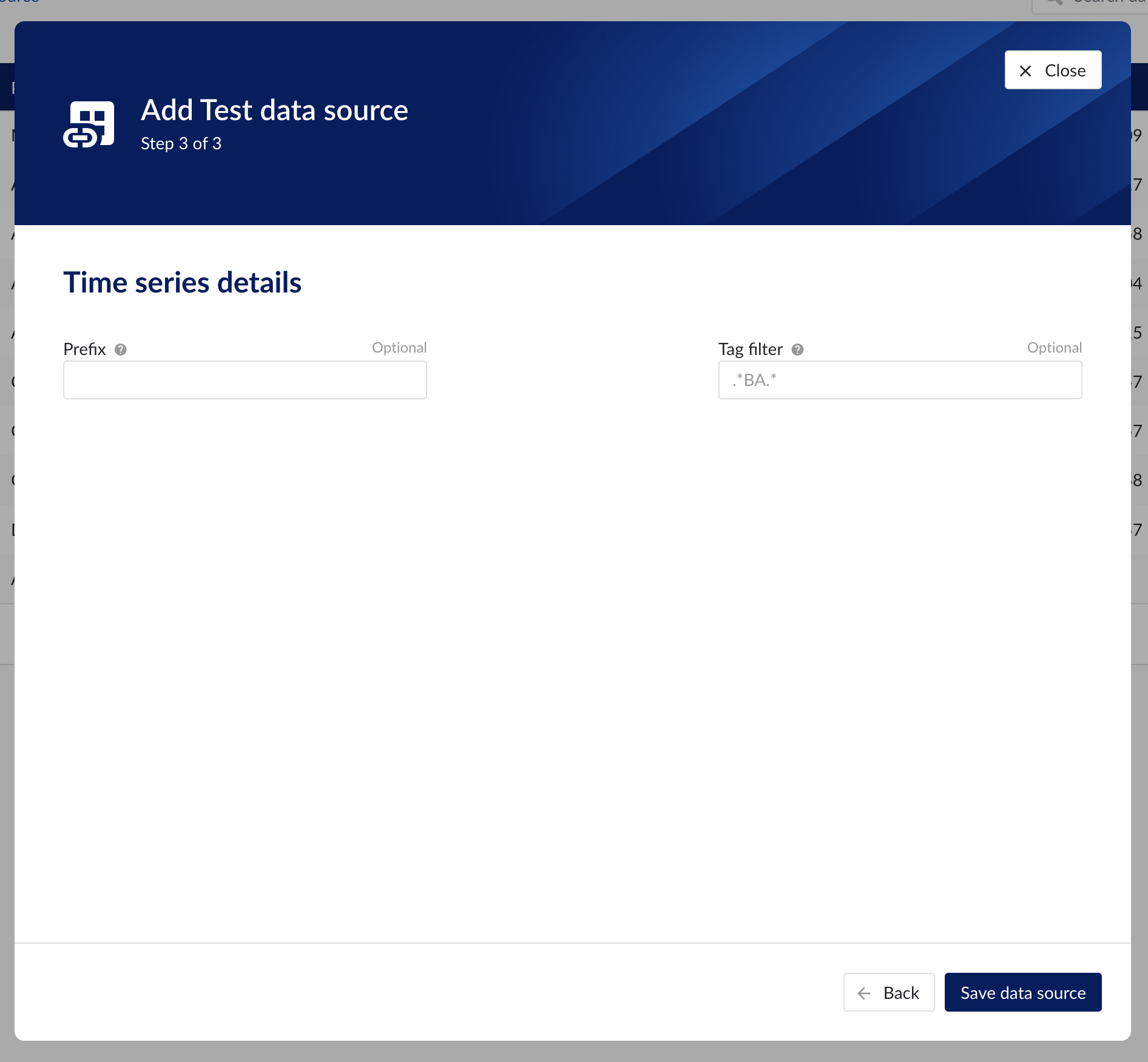

Time series details
Populate the fields on the Time series details step:
  • Prefix: you are free to choose prefixes. They are case insensitive but unique strings and have a maximum length of 5 characters. When synchronising a data source, all tag names of that data source will be prepended with the prefix to ensure tag name uniqueness in TrendMiner. Prefixes are optional but we highly recommend the provision of a prefix when connecting a data source to avoid duplicate tag names.
  • Tag filter: regular expression to be entered. Only tags with names that match this regular expression will be retained when creating tags (using the tag list query).
    Examples:
    Tag filter
    Result
    LINE.[1]+
    Will make tags with 'LINE.1' in the name available but will exclude tags with 'LINE.3' in the tag name.
    ^(?:(?!BA:TEMP).).*$
    Only excludes tag STARTING with BA:TEMP (so still keep test_BA:TEMP.1)
    ^\[pref\]PI.*$
    Only syncs tags from a data source with prefix 'pref' and which start with 'PI'

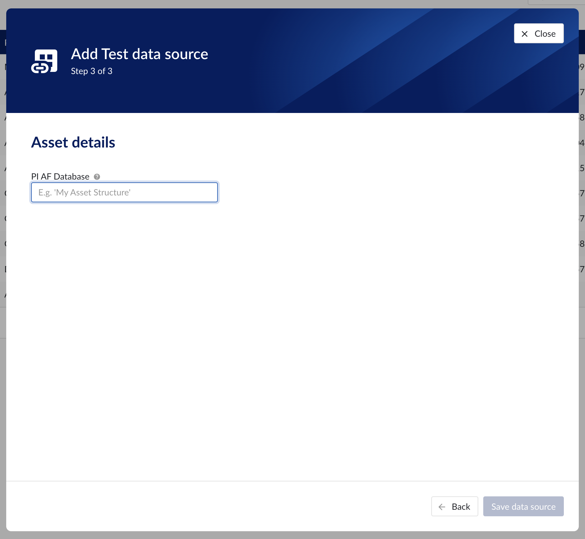

Asset details
The process of creating asset data source, is somewhat similar to the creation of time series data source, but fewer fields are required to fill in.
  • Database: name of the database to connect to.
It is not permitted to add the same connection multiple times with asset capabilities enabled on both instances!
Asset tree permissions need to be managed in the asset permission section (ContextHub).
Asset details step in the datasource creation wizard

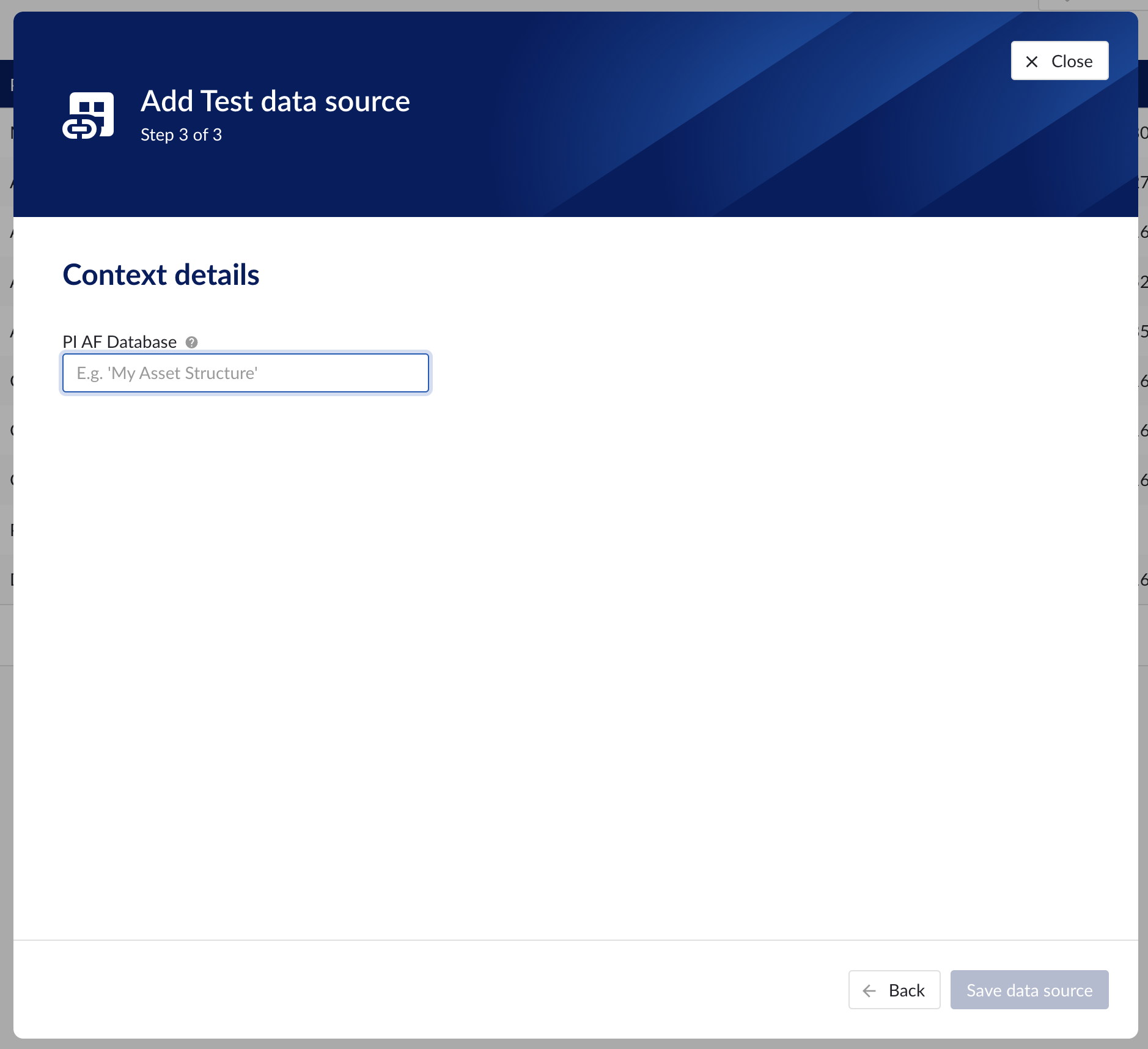

Context data
Context data sources are managed the same way as asset data sources. When a data source is context capable, the context capability checkbox can be checked, after which the correct database for context data needs to be specified.
Notice
Context data synchronised from a data source in OSISoft PI will be related to asset data in TrendMiner based on the "referenced elements" on the PI event frames. The system will always attempt to relate the context item to the asset corresponding to the primary referenced element in PI (if it exists). Otherwise it will default to the first referenced element for which a corresponding asset is known in TrendMiner.
It is not permitted to add the same connection multiple times with context capabilities enabled on both instances! This will result in the creation of duplicate context items.
Context details step in the datasource creation wizard

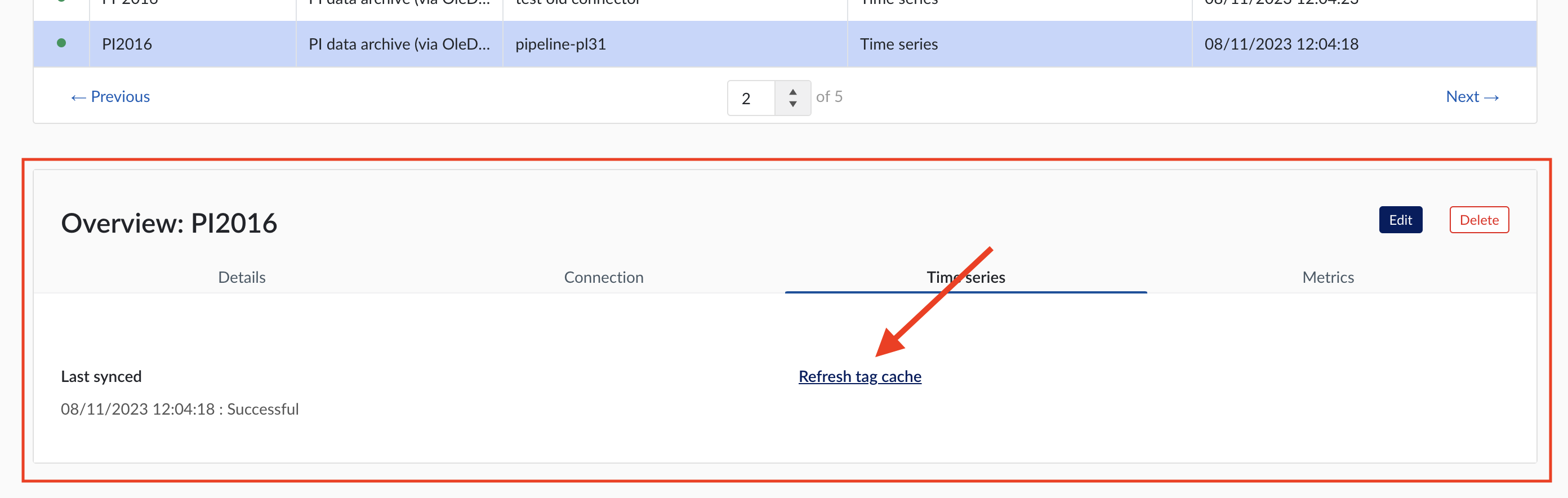

As soon as a new data source (with time series capability) is successfully added, it will start syncing all the tags from the data source, and can be found in the Data source overview.
To manually synchronize the data source, simply:
  1. Click on the data source of your choice within the data source overview table. Datasource details will open below the datasources overview table.
  2. Click on Time series tab.
  3. Click on "Refresh tag cache" button.
    If a data source cannot be synced, the error feedback will be shown under 'Last synced' field.
    For data sources which are successfully connected the 'Last synced' field in the data source details will show the last synced date and time and status 'Successful'. The last sync date and time will be updated when a manual sync is triggered or when TrendMiner synchronizes the tag cache for that data source, which happens automatically every 24 hours since the last refresh or service restart.
