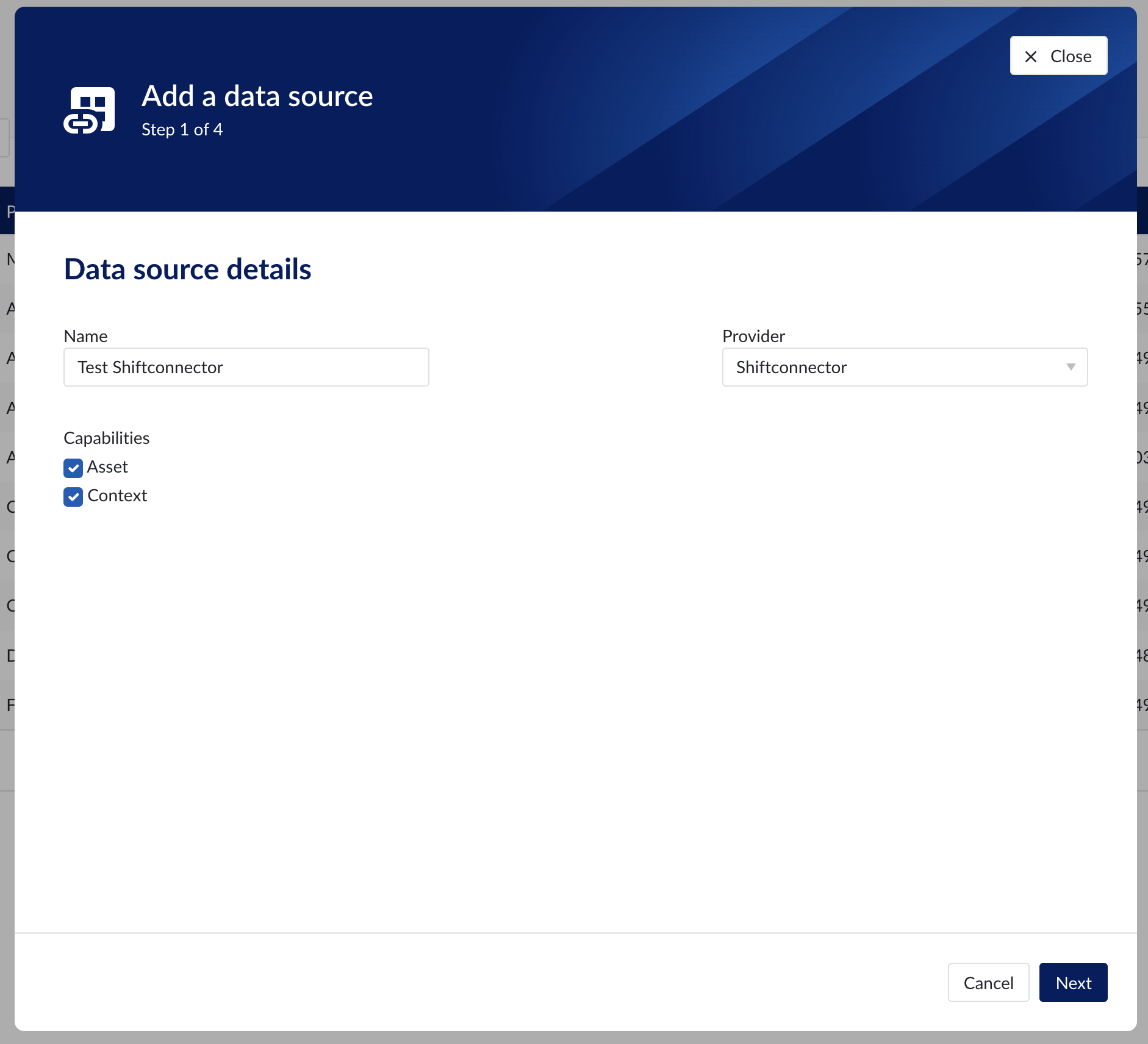

To add a Shiftconnector data source, in ConfigHub go to Data in the left side menu, then Data sources, choose + Add data source. Fill out 'Data source details' on the first step of the datasource creation wizard: type the name of the data source, select “Shiftconnector” from the Provider dropdown. Selecting the capabilities for the data source with the given checkboxes will open additional properties to enter, grouped in following sections:
Connection details - lists properties related to the configuration of the connection that will be established with a datasource
Asset details - lists properties relevant for asset data
Context details - lists properties relevant for context data
As the asset and context capabilities go hand in hand in Shiftconnector, the checkboxes for Asset and Context capabilities must be selected together.

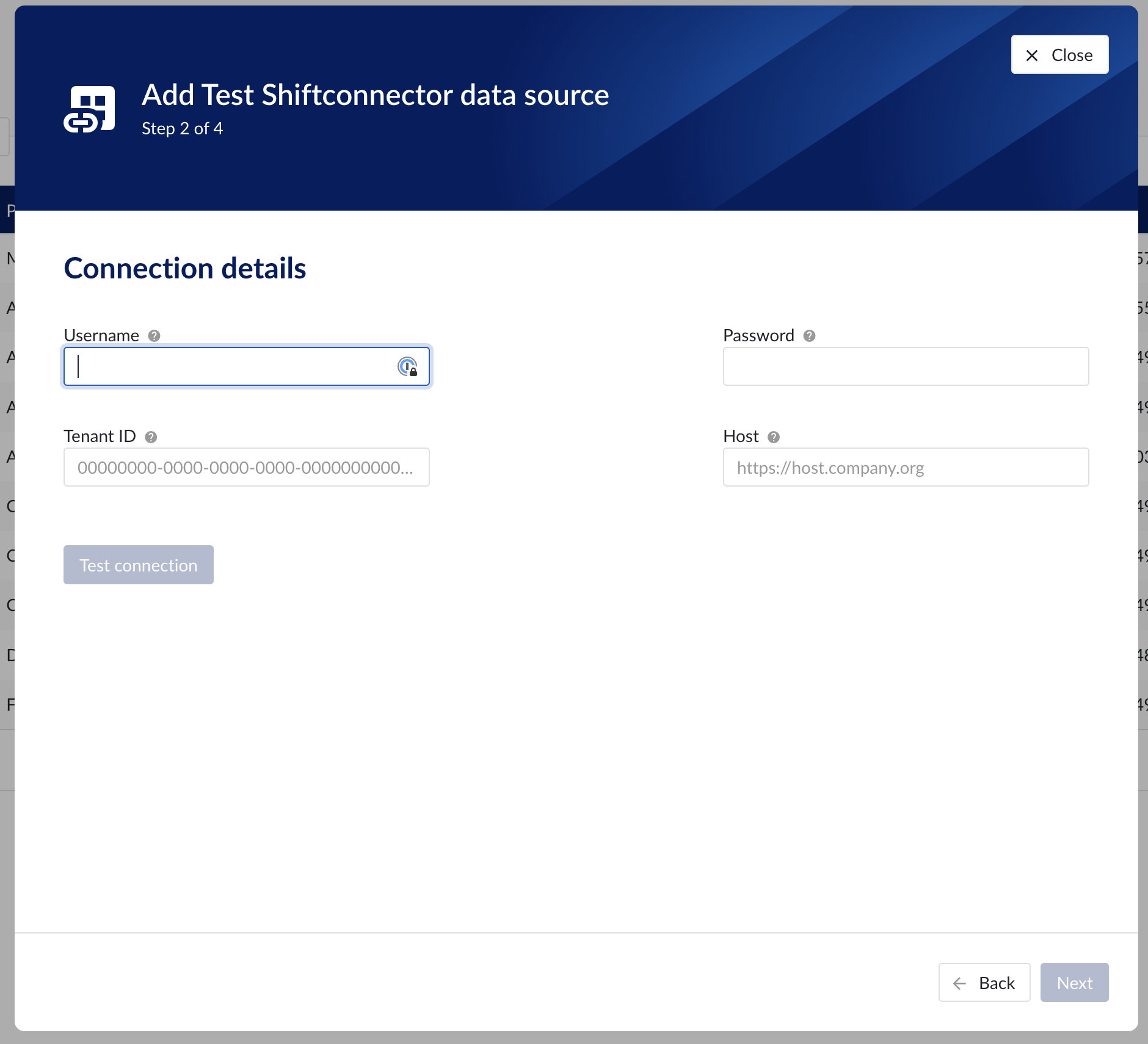

Following properties need to be populated to establish the connection to the Shiftconnector provider:
"Username" - a mandatory username used to establish a connection
"Password" - a mandatory password used to establish a connection
“Tenant ID" - a mandatory tenant ID as configured in the Shiftconnector application
“Host" - a mandatory host URL of the Shiftconnector application

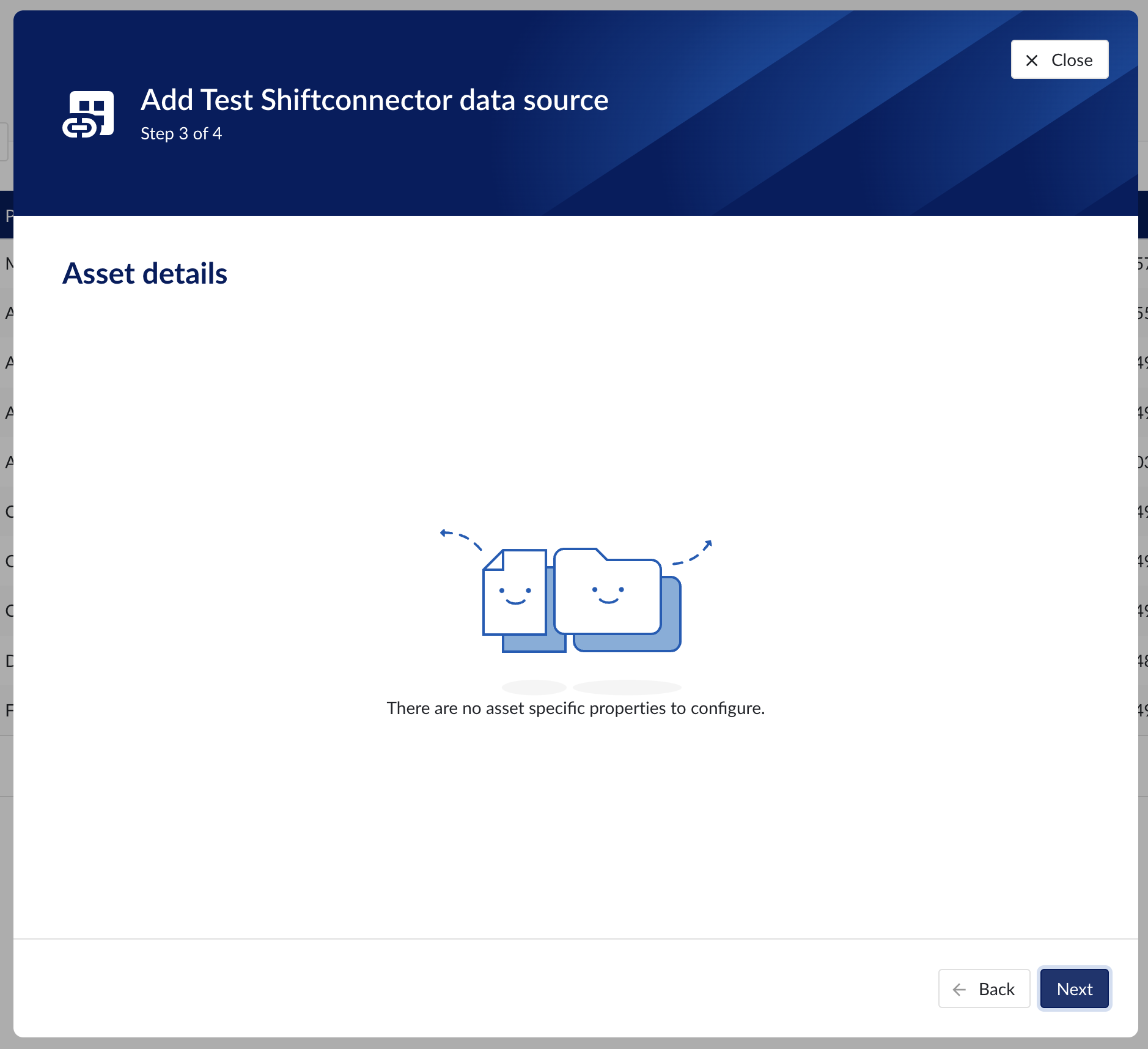

There are no asset specific properties to configure for the Shiftconnector provider.
Asset details step in creation wizard

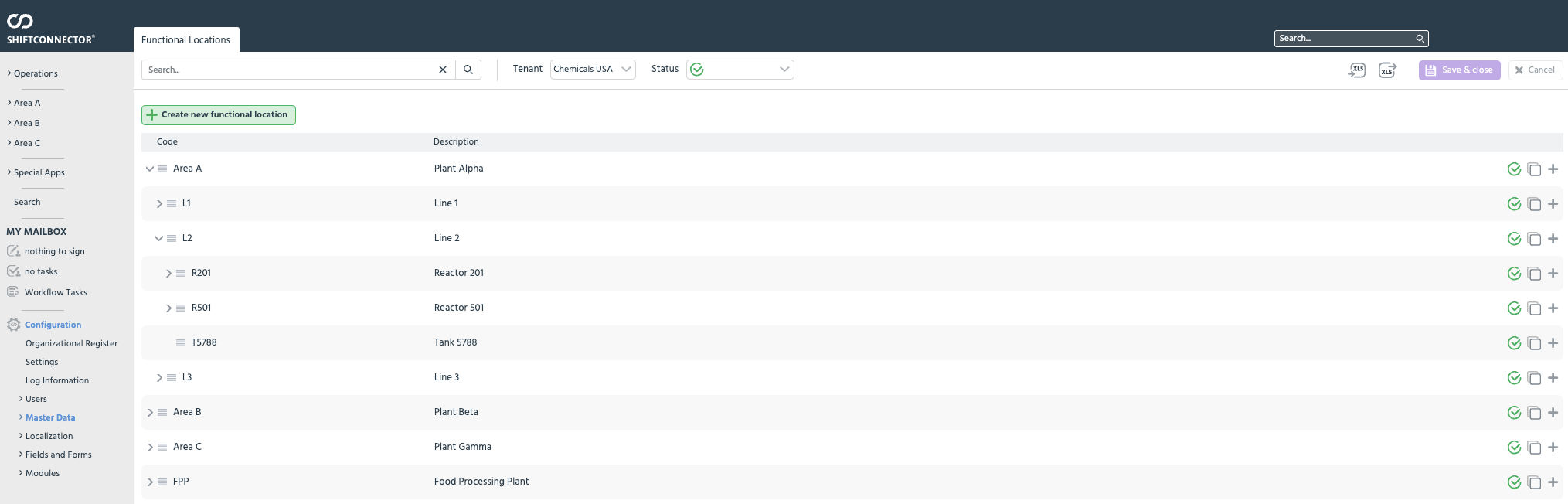

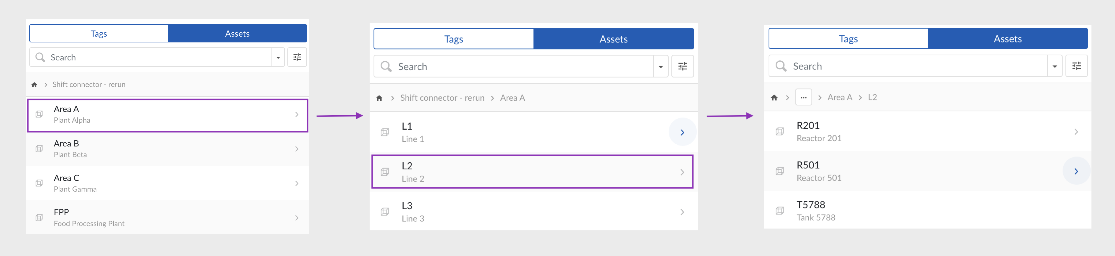

If the asset capability for the Shiftconnector is enabled, TrendMiner will ingest Functional Locations from the Shiftconnector domain as Assets into the TrendMiner domain. Only active functional locations are synced as assets into TrendMiner.
TrendMiner caches functional locations. Changes in existing functional locations on Shiftconnector side will only be visible after a manual resync, triggered at least 1 hour after the change. If a new location is added, it will become available after manual resync immediately.
Functional locations in Shiftconnector
Asset hierarchy in TrendMiner

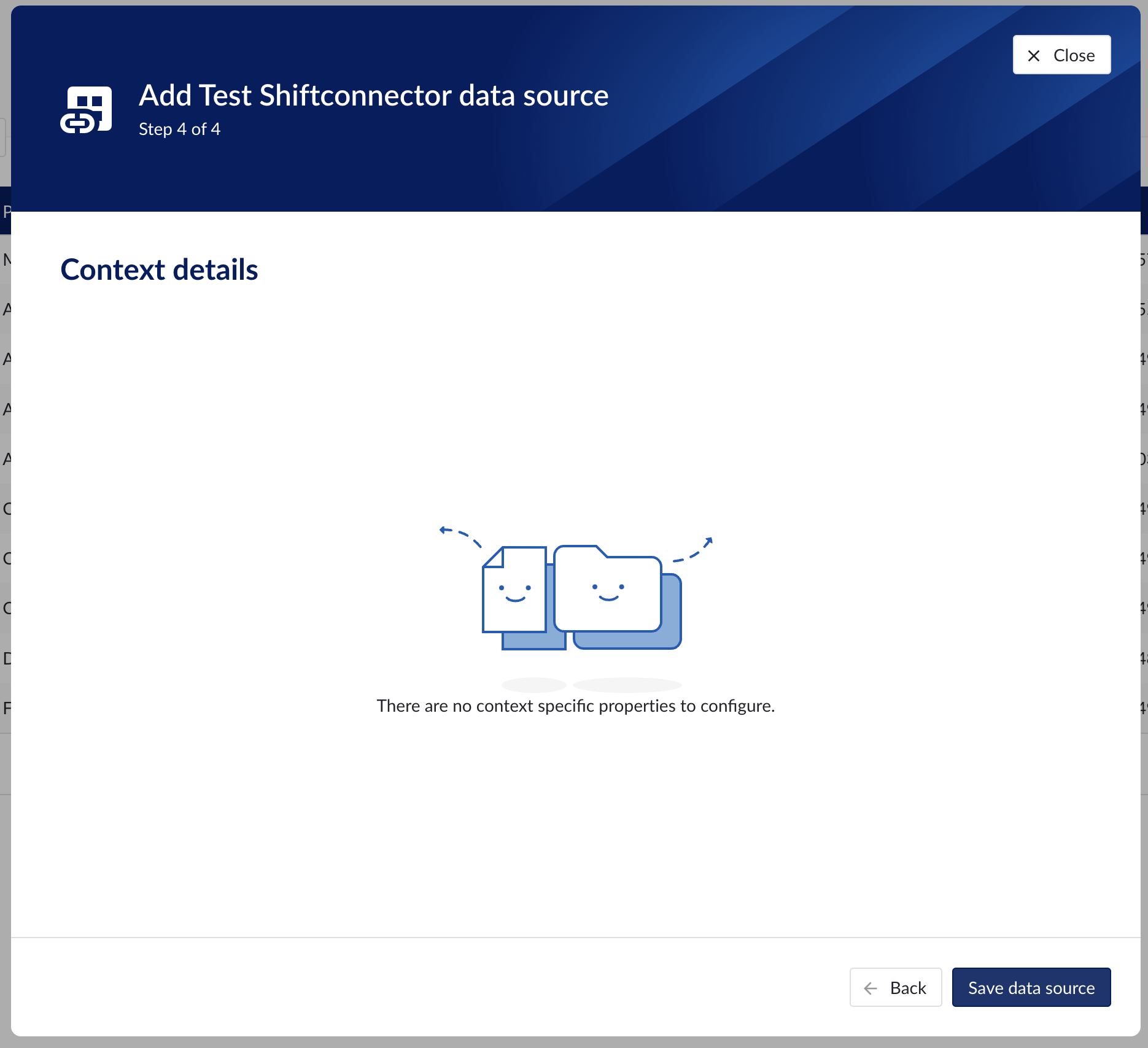

CONTEXT CAPABILITY
There are no context specific properties to configure for the Shiftconnector provider.
Context details step in creation wizard

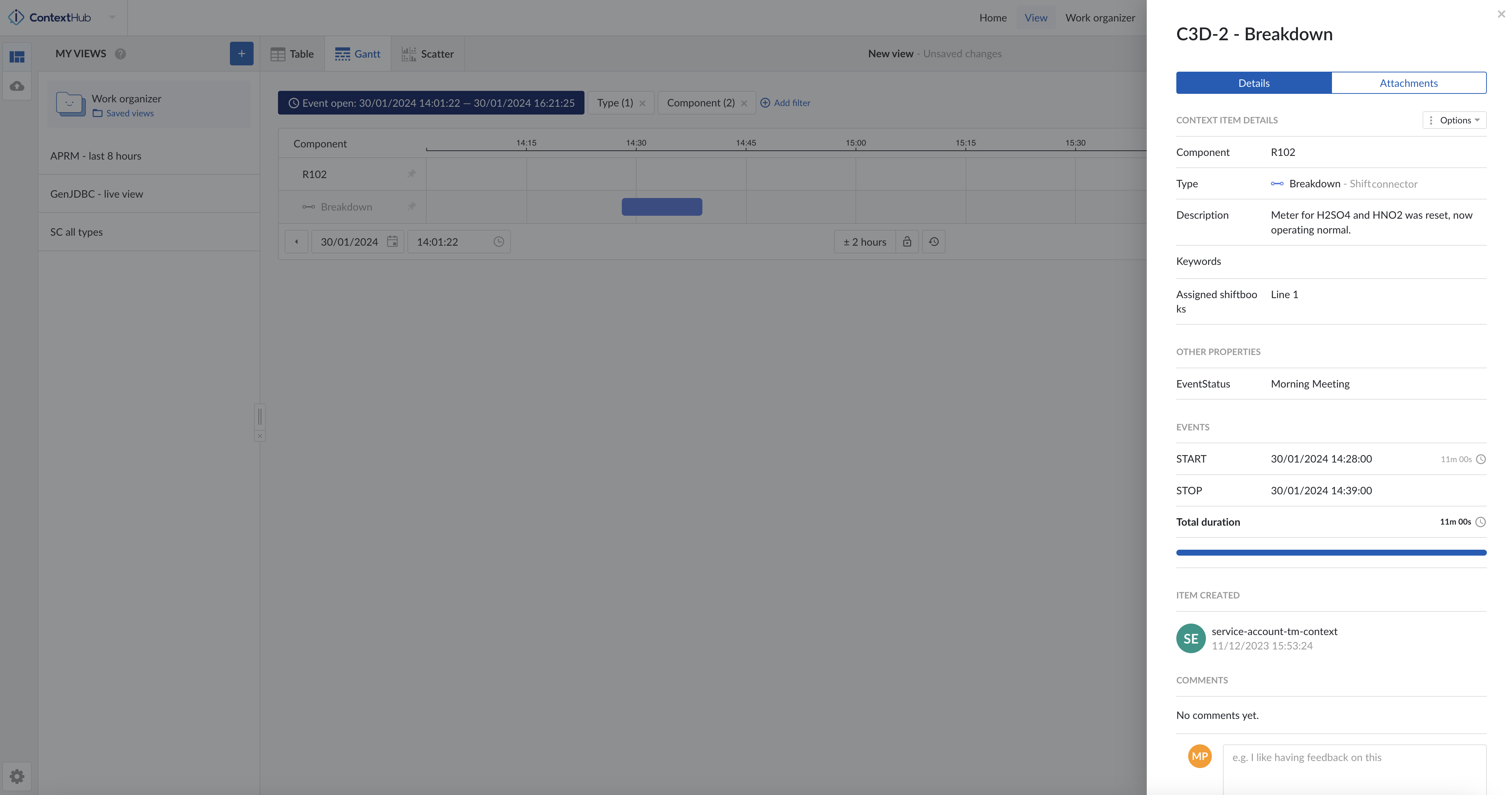

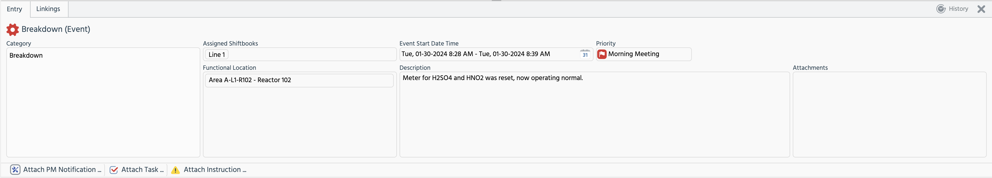

If the context capability for the Shiftconnector is enabled, TrendMiner will ingest entry items of type ‘Event' from the Shiftconnector domain as Context Items into the TrendMiner domain. Deleted events aren’t synced into TrendMiner as context items.
The provider will map Shiftconnector categories to TrendMiner context item types. The link between the asset hierarchy and the context items is established using components in TrendMiner.
Event in Shiftconnector
Context Item in TrendMiner

The following Shiftconnector event fields are mapped on the TrendMiner context item fields:
Shiftconnector Event Fields | TrendMiner Context Item Fields |
Functional location | Functional location |
Type | Category ("name") |
Description | Description |
Shiftbook | Assigned Shiftbooks |
Batch | Batch |
Event status | Event Status |
Attachment | Attachments (true/false) |
Started | Start DateTime |
Ended | End DateTime |
