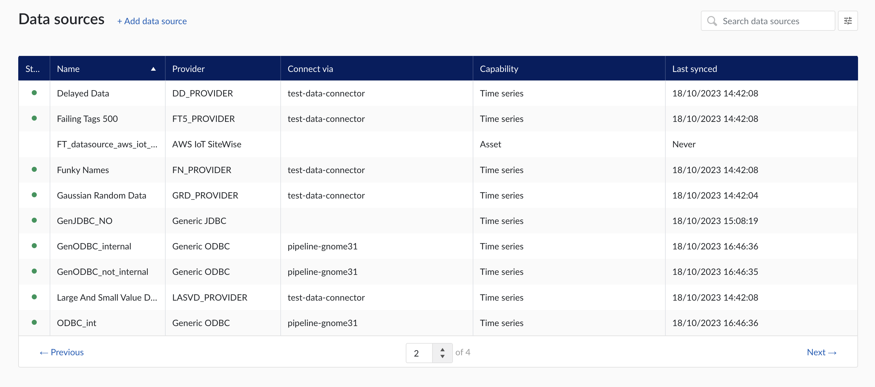

When clicking on the Data sources menu option, the data sources overview is shown :
Data sources overview

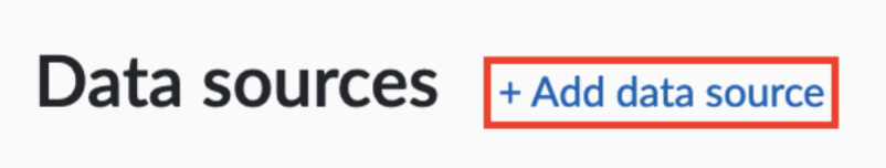

Add a new data source by clicking the (+ Add data source) label next to the title. An "Add a data source" modal will appear.

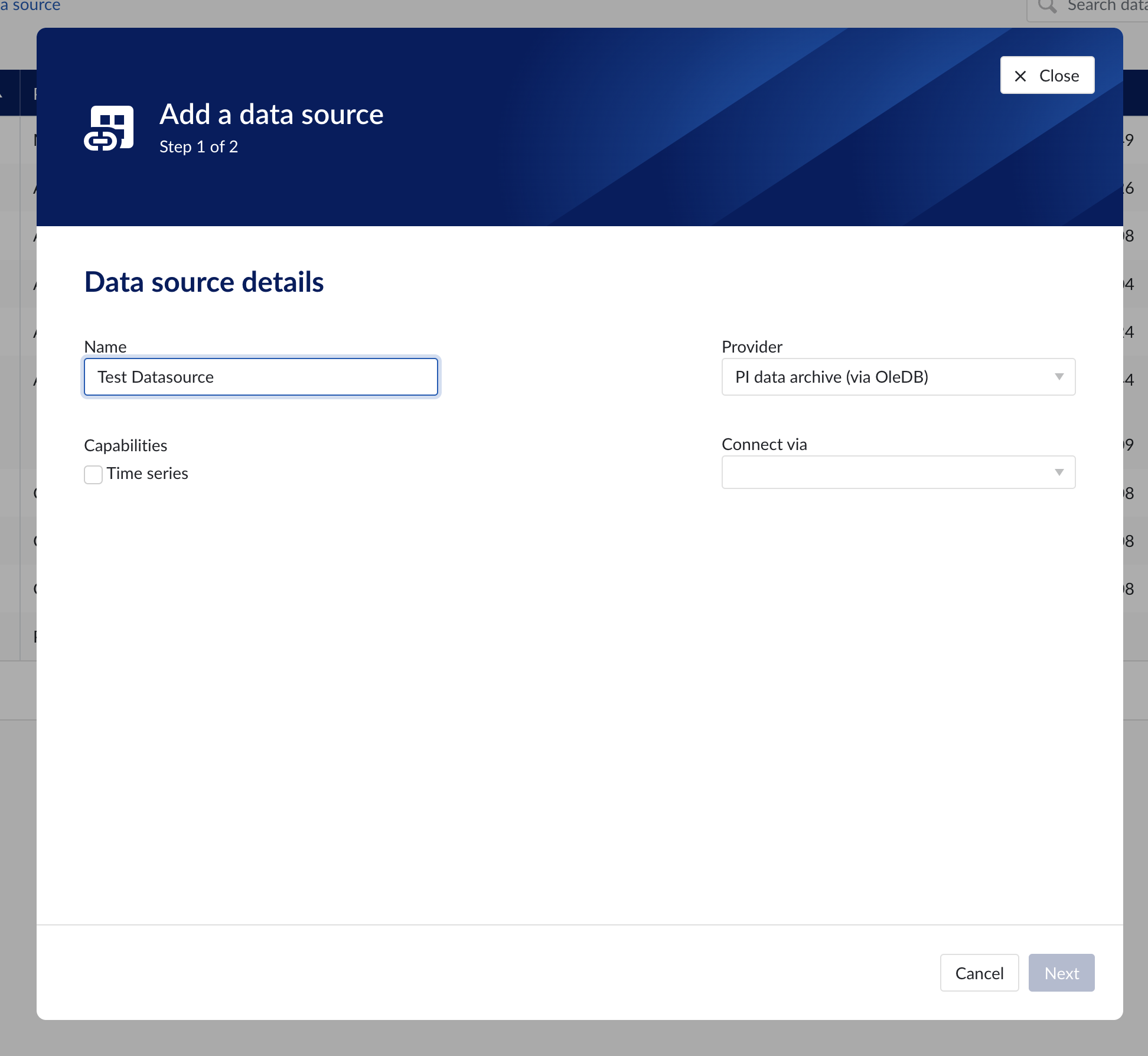

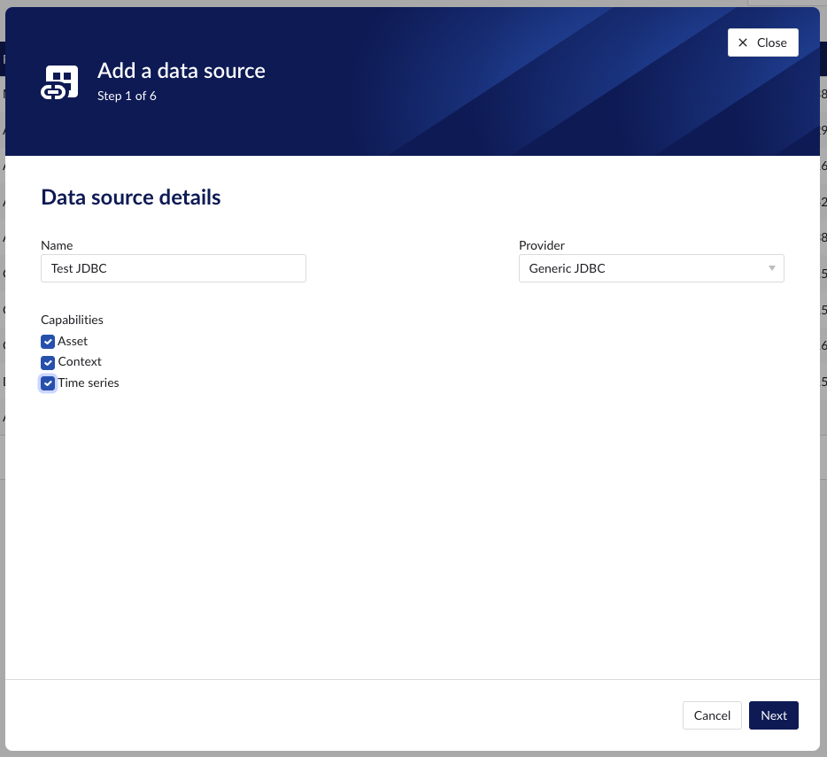

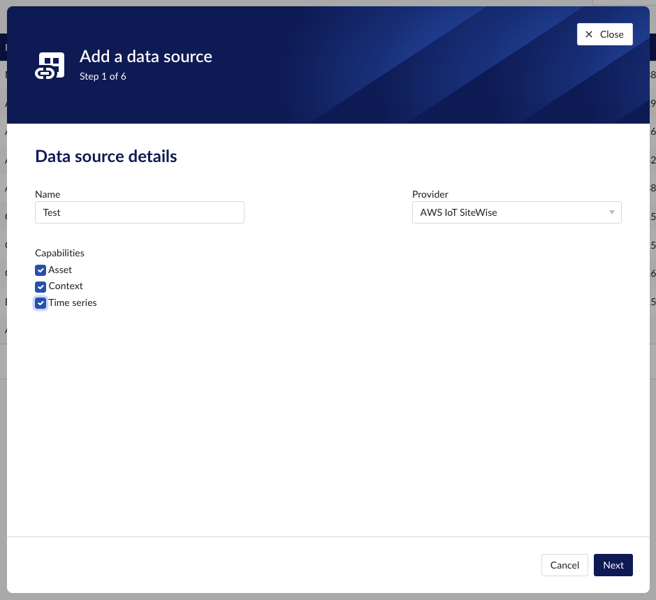

Data source details
Populate the fields on the Data source details step:
  • Name: you are free to choose data source names but they are mandatory, case insensitive and unique. The name of a data source identifies the data source. We strongly advise to only use alphanumerical and '-' or '_' in data source names as other characters are not supported in the access management so using special characters in a data source name might give issues when you want to assign access permission to the data source later on.
  • Provider: TrendMiner provides some out of the box connectivity to data sources via specific vendor implementations (e.g. OSIsoft PI, Honeywell PHD,...) and via more generic alternatives (e.g. Generic JDBC, ODBC, OleDB, ...). The provider 'TM connector' enables the  connection of data sources via a connector to connector setup. To connect a data source via multiple connectors, extra configuration is needed via the TrendMiner Connector API.
  • Connect via: this dropdown is used to select a connector which is used to connect to the data source. The dropdown is displayed based on the selected provider: some data sources need to be connected via a connector (e.g. OSIsoft PI, Generic ODBC, Wonderware, ...), while others don't need any connector (e.g. Amazon Timestream, Generic JDBC, AWS IoT SiteWise, ...). To add a data source that needs a connector,  the connector needs to be added first.
  • Capabilities: Capabilities depend on provider implementation. Some datasources have only one capability (e.g.  Amazon Timestream has Time series capability only), others have all 3 capabilities (e.g. AWS IoT SiteWise). Selecting the capabilities for the data source with the given checkboxes will open additional properties to enter, grouped in following sections:
    • Connection details - lists properties related to the configuration of the connection that will be established with datasource
    • Time series details – lists properties relevant for the time series data
    • Asset details - lists properties relevant for asset data
    • Context details - lists properties relevant for context data
Duplicate tag names are not supported. If 2 tags with exactly the same name are synced to TrendMiner, analytics, calculations and indexing on/for these tags might fail. Use data source prefixes to avoid possible duplicate tag name issues.
Depending on the provider you select, the connection details required for completion may differ.

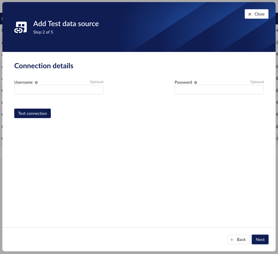

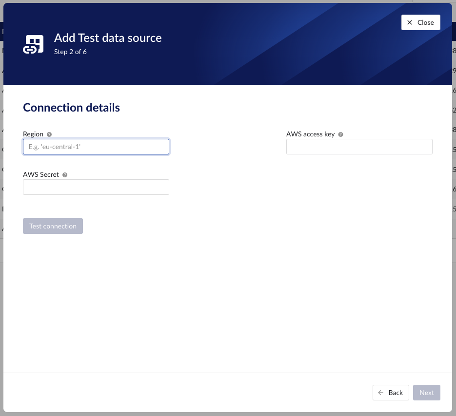

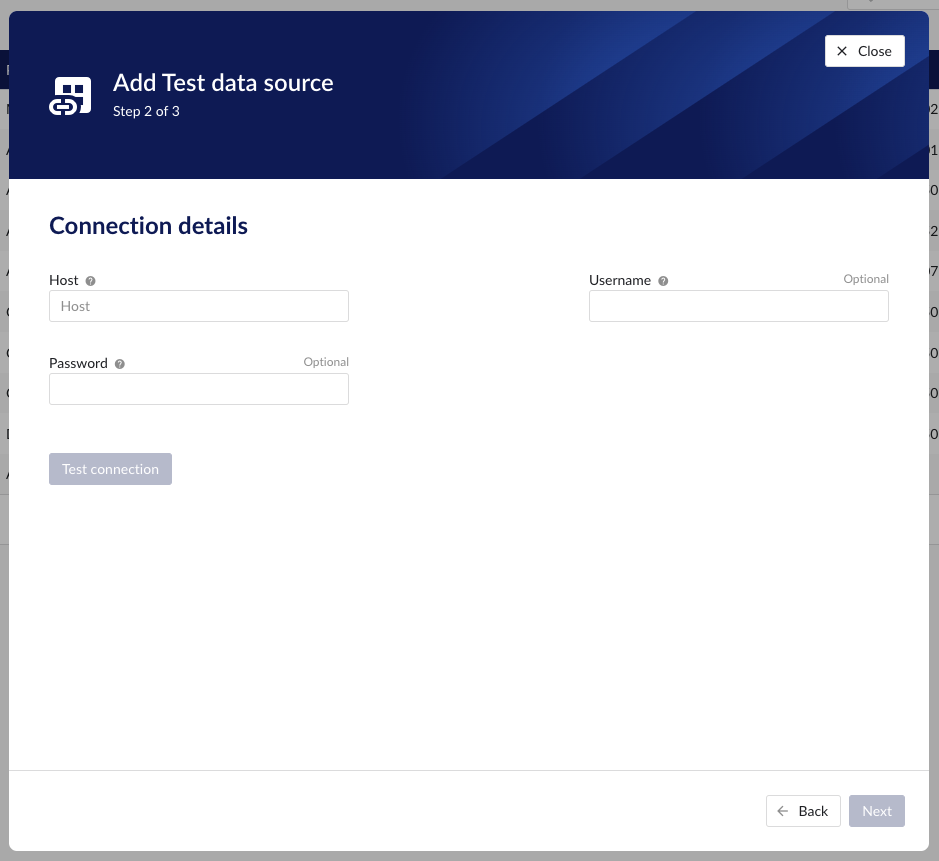

Connection details

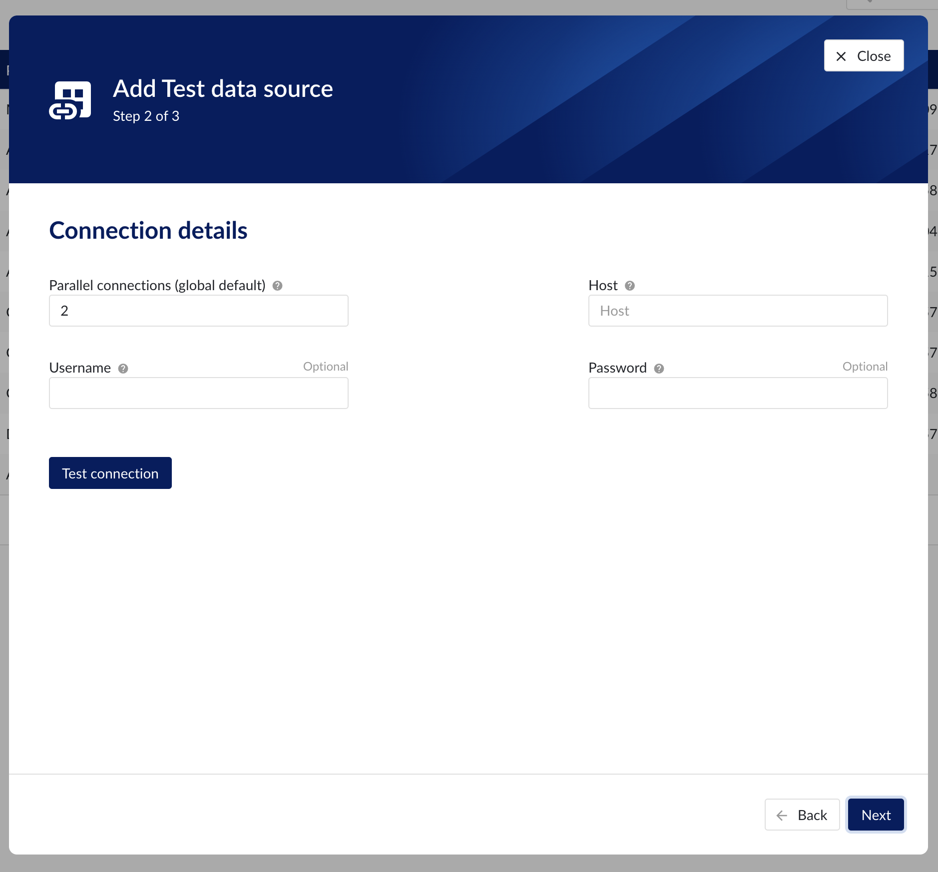

Populate the fields on the Connection details step:
  • Parallel connections (if any): Each data source has 2 queues: one interactive - plot calls, one non-interactive - index calls, batch calls etc. Parallel connections determine how many connections each queue has to the connector. By default there are 2 parallel connections to the connector.
  • Host: the host name of the data source, e.g. myhistorian.mycompany.com
  • Username: username of the account configured in the data source.
  • Password: password of the account configured in the data source.
Once all mandatory fields are filled in, 'Test connection' button becomes enabled. By clicking on the button, user can verify the connection to the datasource.
Connection details step in the datasource creation wizard

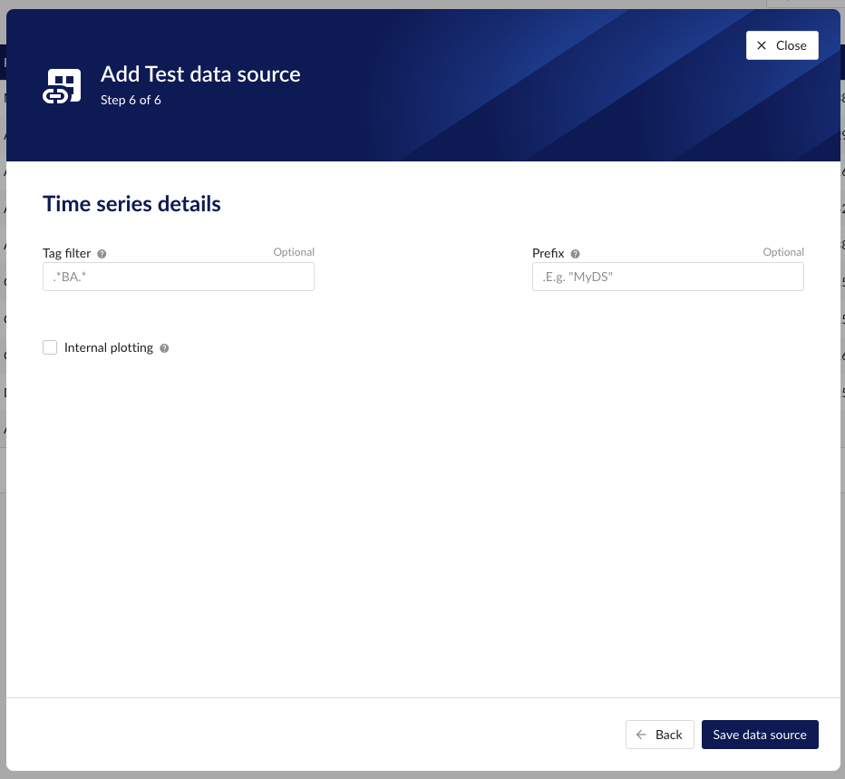

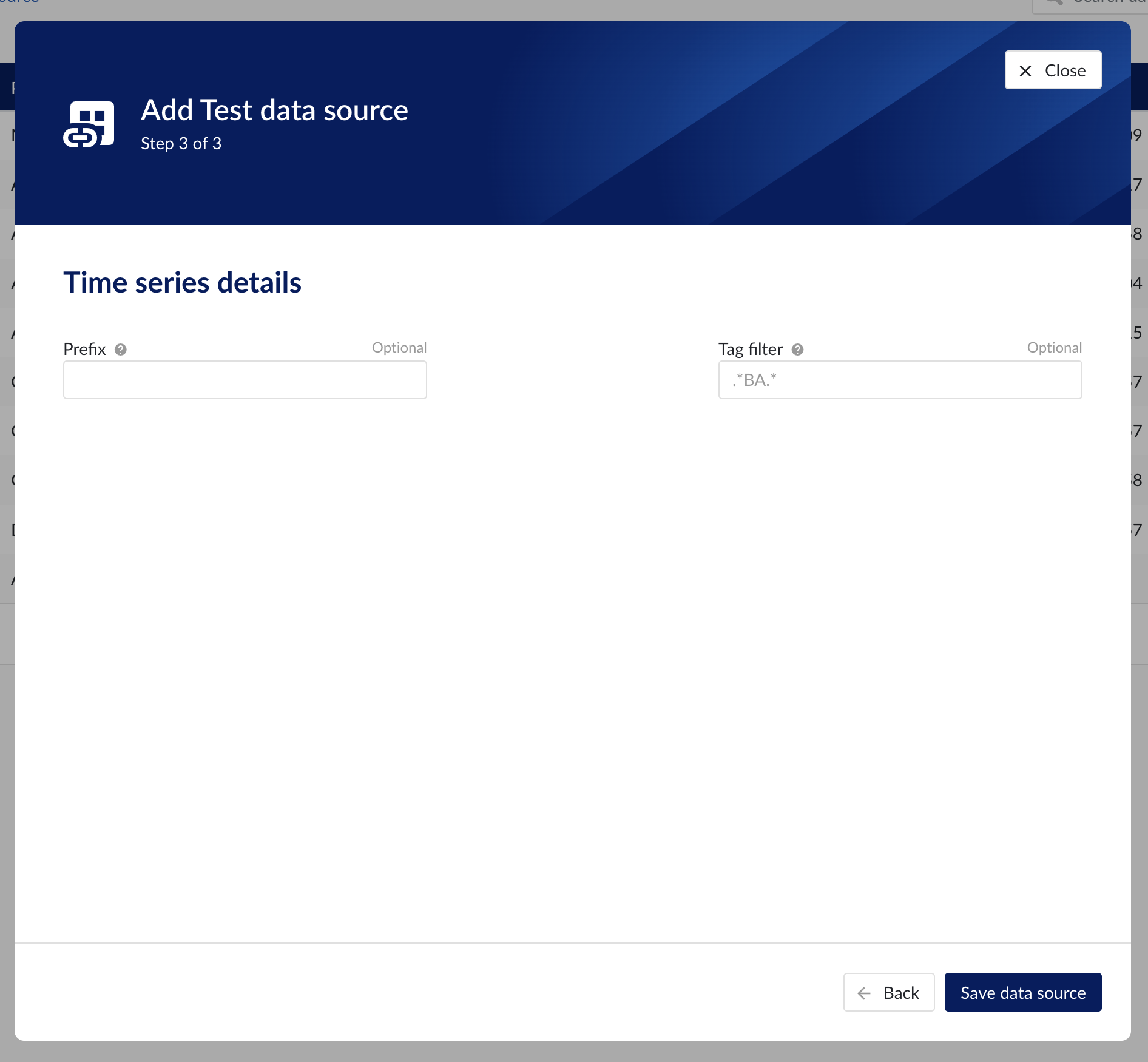

Time series details

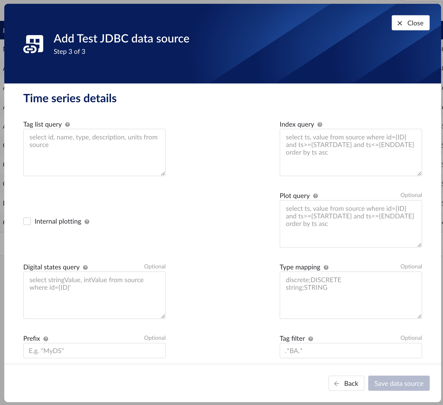

Populate the fields on the Time series details step:
  • Prefix: you are free to choose prefixes. They are case insensitive but unique strings and have a maximum length of 5 characters. When synchronising a data source, all tag names of that data source will be prepended with the prefix to ensure tag name uniqueness in TrendMiner. Prefixes are optional but we highly recommend the provision of a prefix when connecting a data source to avoid duplicate tag names.
  • Tag filter: regular expression to be entered. Only tags with names that match this regular expression will be retained when creating tags (using the tag list query).
    Examples:
    Tag filter
    Result
    LINE.[1]+
    Will make tags with 'LINE.1' in the name available but will exclude tags with 'LINE.3' in the tag name.
    ^(?:(?!BA:TEMP).).*$
    Only excludes tag STARTING with BA:TEMP (so still keep test_BA:TEMP.1)
    ^\[pref\]PI.*$
    Only syncs tags from a data source with prefix 'pref' and which start with 'PI'
Time series details step in the datasource creation wizard

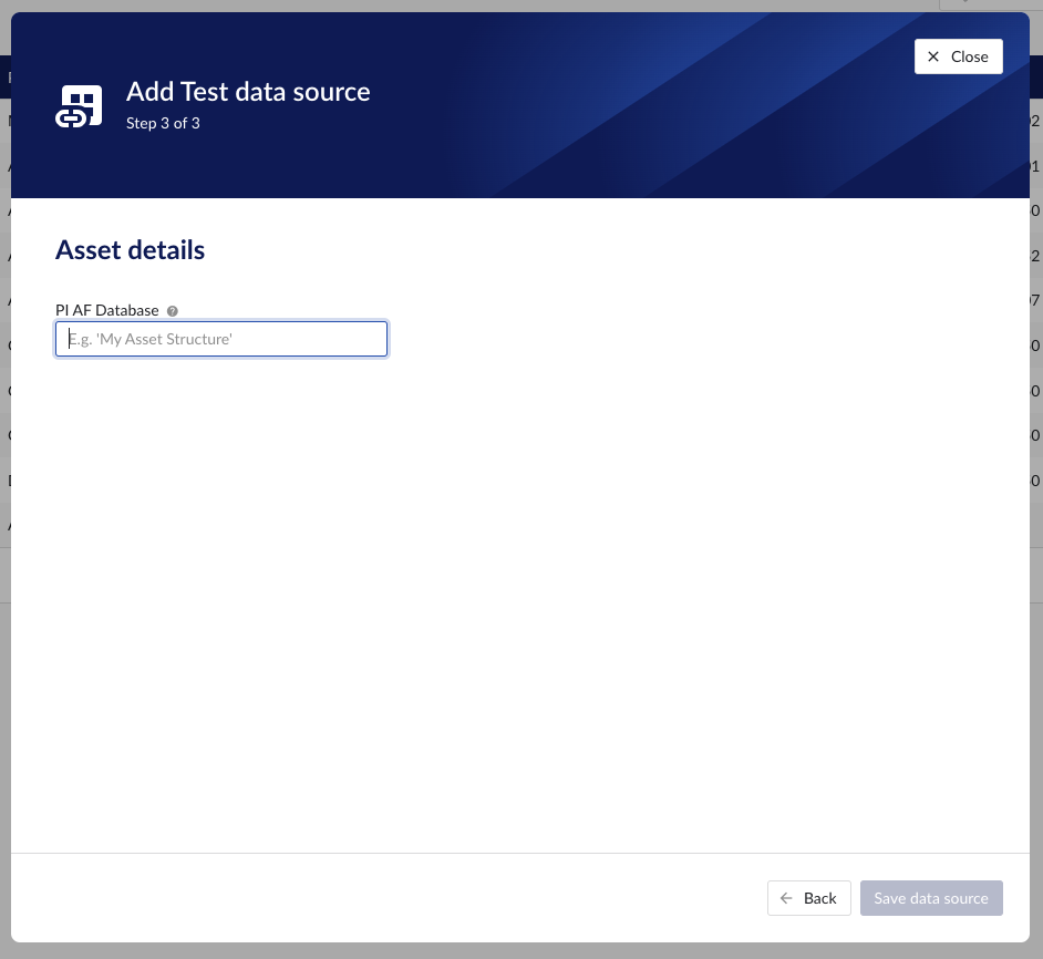

Asset details

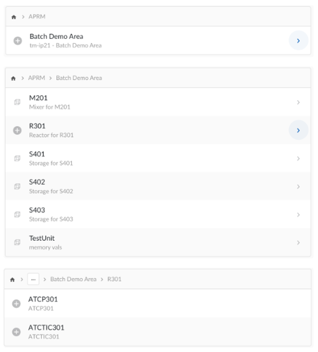

The process of creating asset data source, is somewhat similar to the creation of time series data source, but fewer fields are required to fill in.
  • Database: name of the database to connect to.
It is not permitted to add the same connection multiple times with asset capabilities enabled on both instances!
Asset tree permissions need to be managed in the asset permission section (ContextHub).

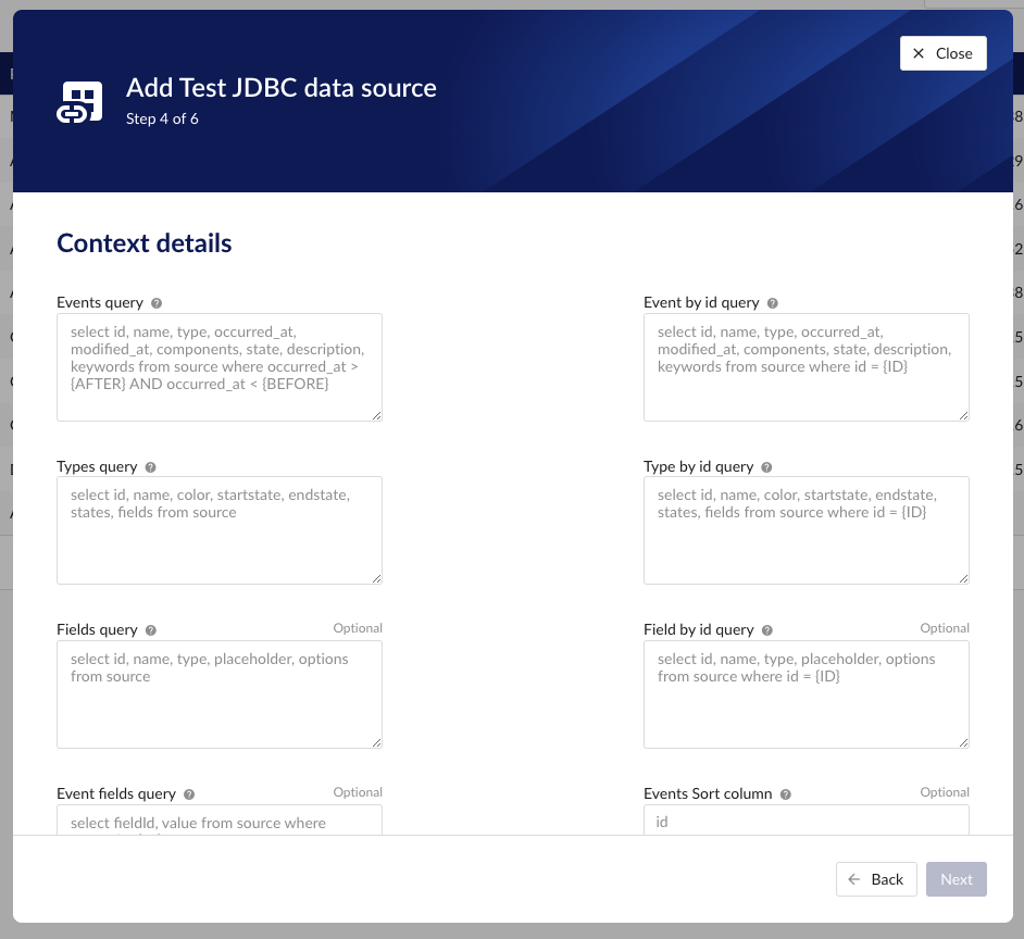

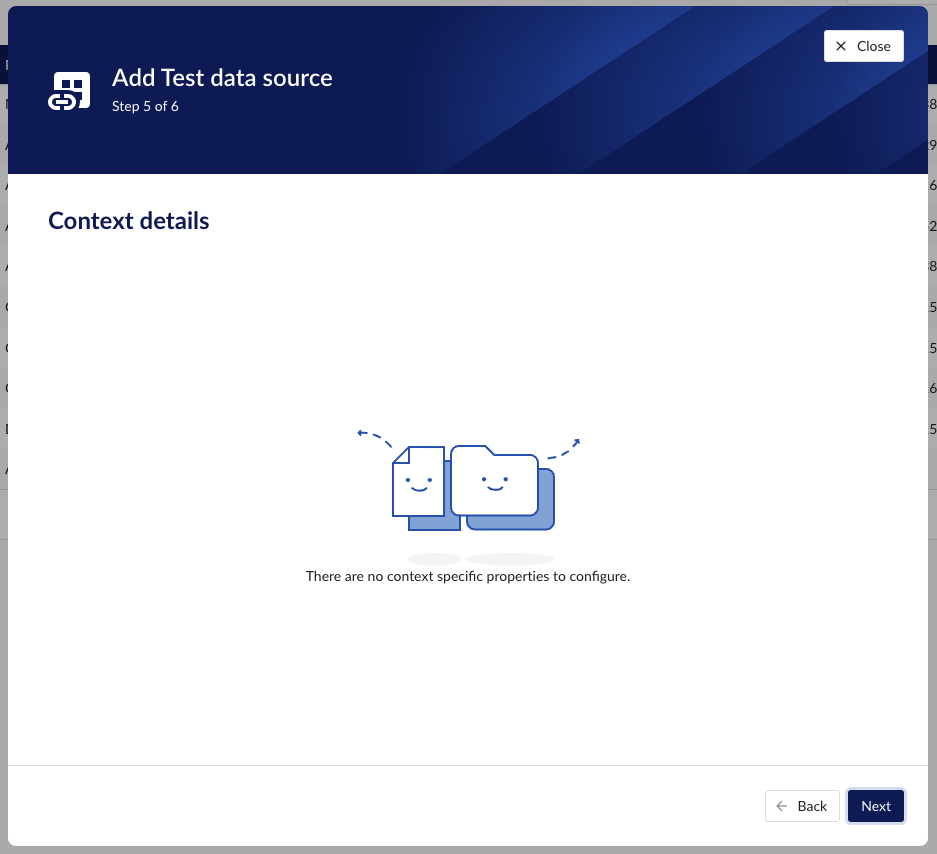

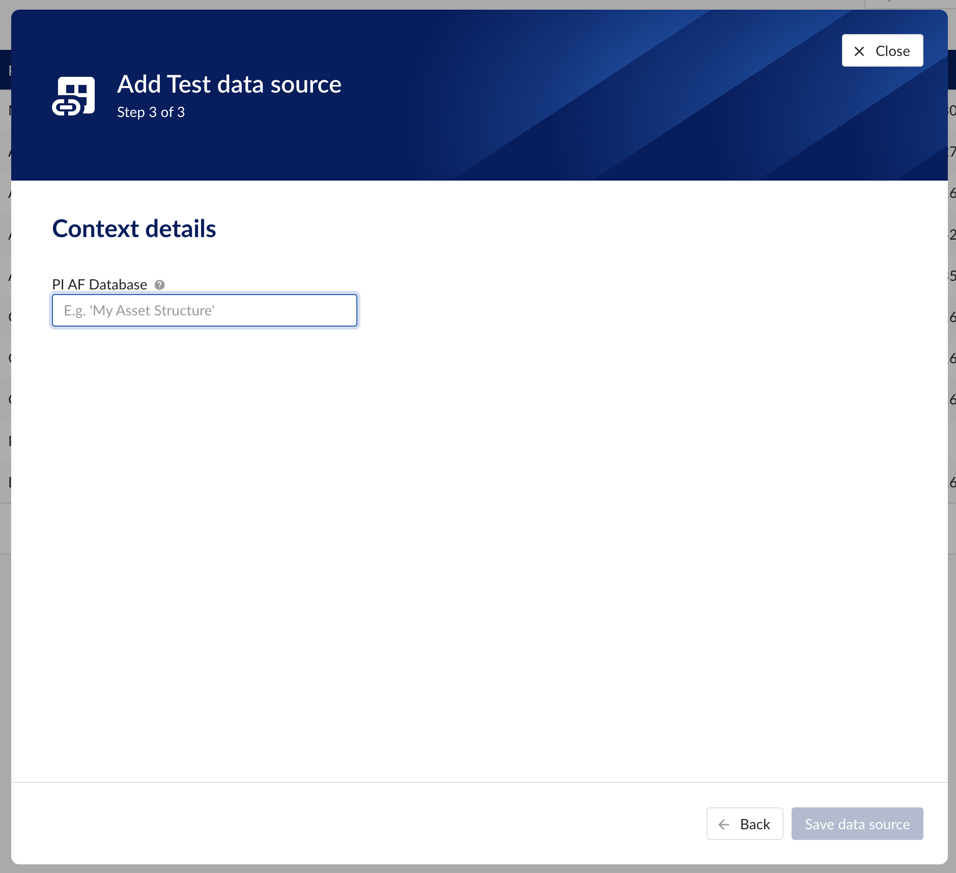

Context data
Context data sources are managed the same way as asset data sources. When a data source is context capable, the context capability checkbox can be checked, after which the correct database for context data needs to be specified.
Notice
Context data synchronised from a data source in OSISoft PI will be related to asset data in TrendMiner based on the "referenced elements" on the PI event frames. The system will always attempt to relate the context item to the asset corresponding to the primary referenced element in PI (if it exists). Otherwise it will default to the first referenced element for which a corresponding asset is known in TrendMiner.
It is not permitted to add the same connection multiple times with context capabilities enabled on both instances! This will result in the creation of duplicate context items.
Context details step in the datasource creation wizard

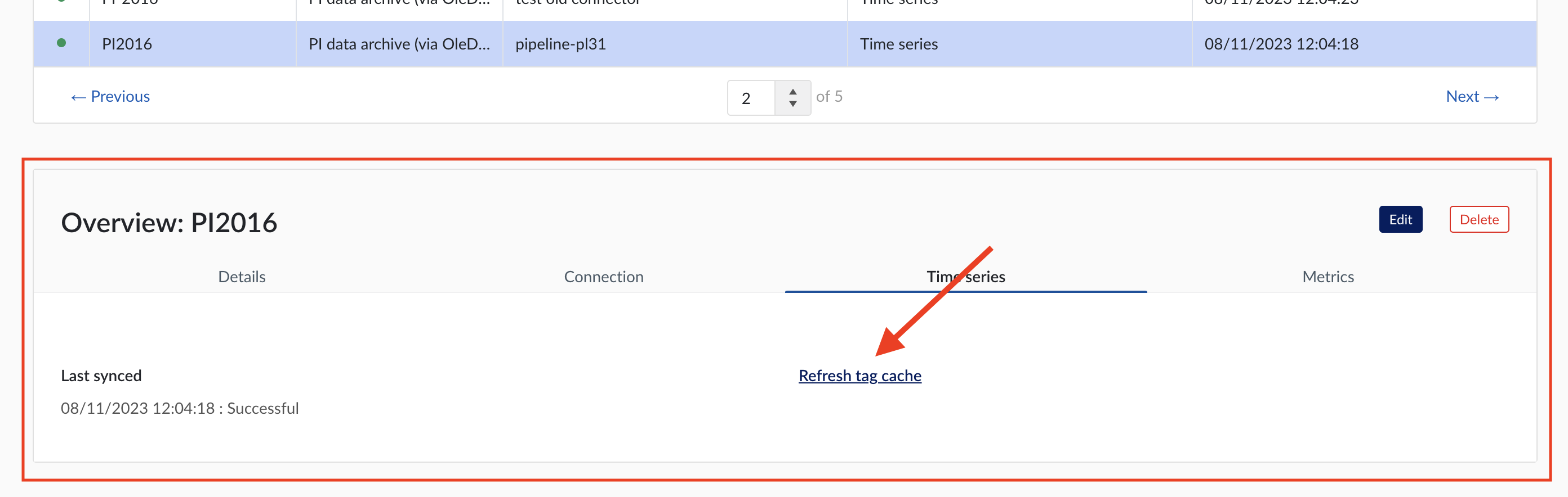

As soon as a new data source (with time series capability) is successfully added, it will start syncing all the tags from the data source, and can be found in the Data source overview.
To manually synchronize the data source, simply:
  1. Click on the data source of your choice within the data source overview table. Datasource details will open below the datasources overview table.
  2. Click on Time series tab.
  3. Click on "Refresh tag cache" button.
    If a data source cannot be synced, the error feedback will be shown under 'Last synced' field.

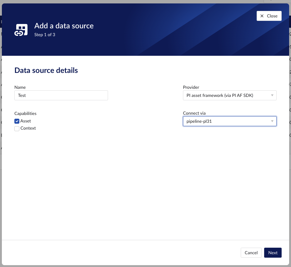

  3. Click  "+ Add data source". Datasource creation modal will appear.
  4. Fill out 'Data source details' step:
    1. Name the data source.
    2. Select the provider you would like to use. If the provider of your choice is not listed, this implies none of the connected connectors supports this data source type and you have to add a connector which does, or check your implementation in case you implemented your own custom connector.
      A list of providers which TrendMiner supports out of the box can be found here.
    3. Select the connector you want to use for connecting the data source via 'Connect via' dropdown (if the provider of your choice requires a connector). If the connector of your choice is not listed, this implies this connector does not support this provider and you have to select a different connector or check your implementation in case you implemented your own custom connector
    4. Make sure to select the "Time series" capability checkbox. If this checkbox is not visible, it means this provider does not support time series data. You can check which connectivity options TrendMiner supports out of the box here

  5. Fill out 'Data source details' step:
    2. Select the provider 'PI asset framework (via PI AF SDK)'.
    3. Select the connector you want to use for connecting this data source via the 'Connect via' dropdown.
    4. Make sure to select the "Asset" capability checkbox.

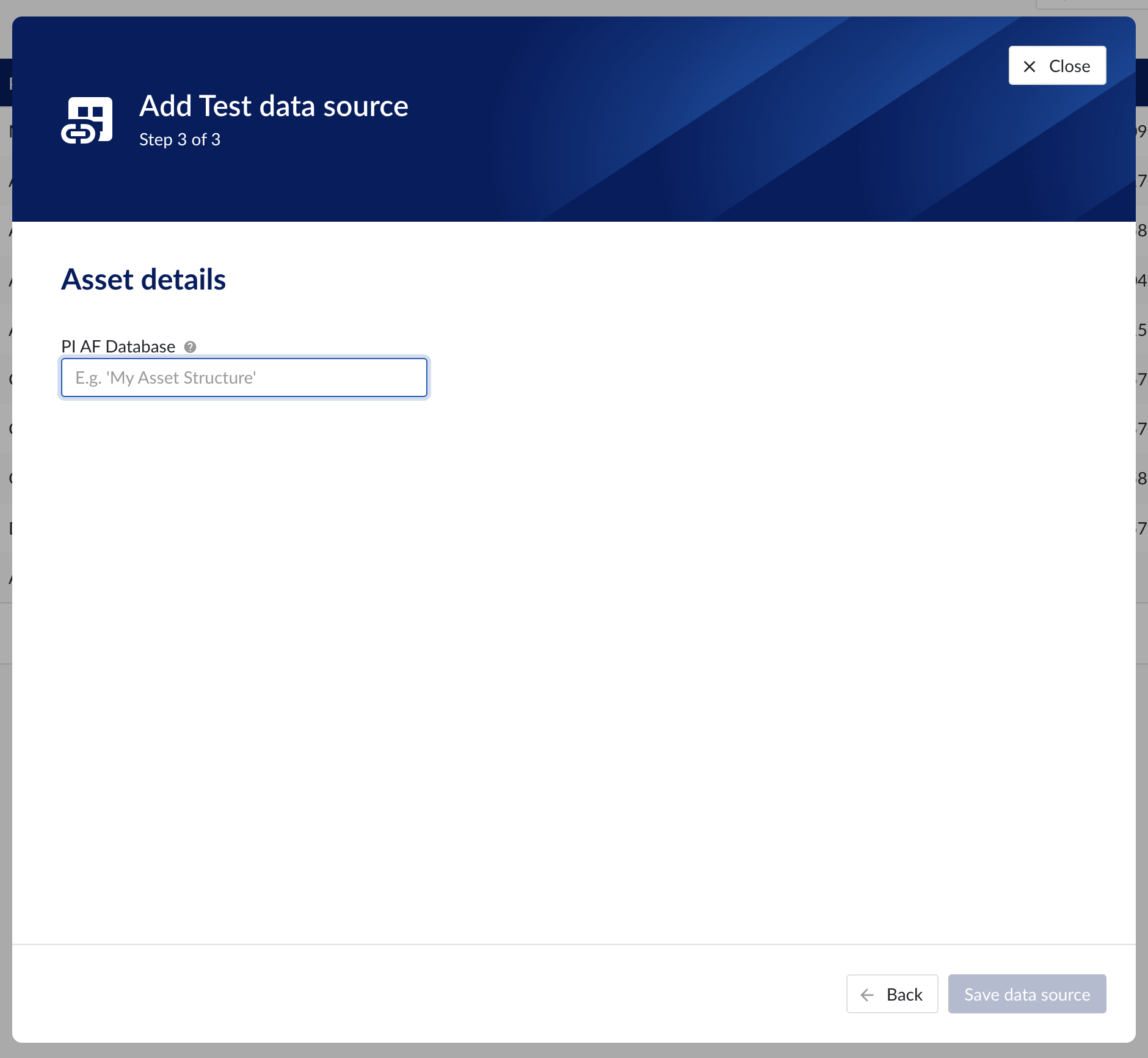

  6. Fill out 'Connection details'  step.
  7. Fill out 'Asset details' step and click 'Save data source' button.

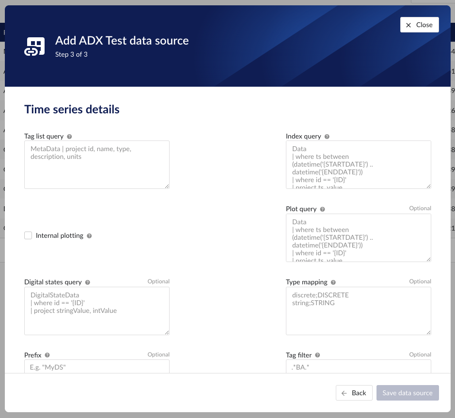

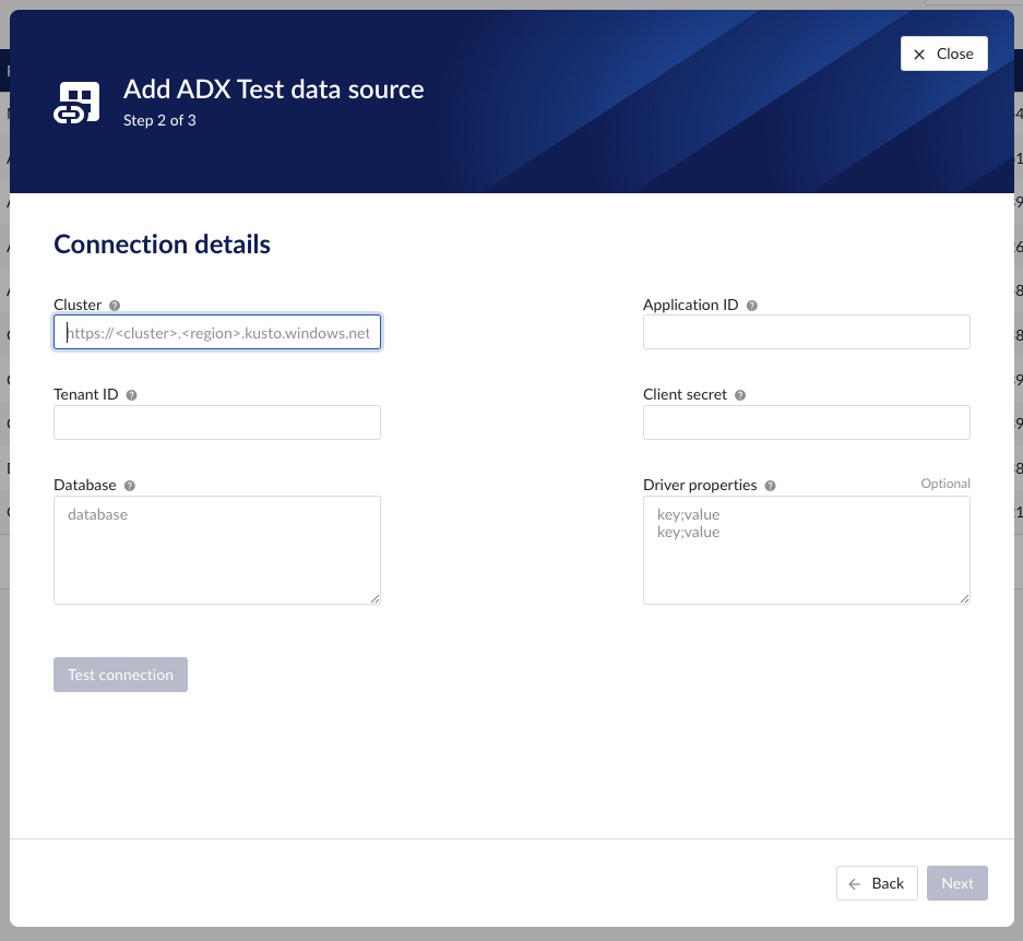

Fill out 'Data source details' on the first step of the datasource creation wizard: type name of data source, select “Microsoft Azure Data Explorer” from the Provider dropdown.  Time series capability will be checked by default.

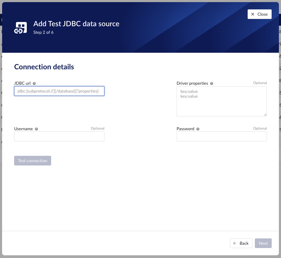

Fill out additional properties, grouped in following sections:

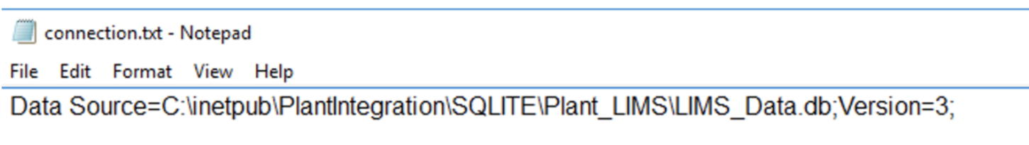

  • Connection details – lists properties related to the configuration of the connection that will be established with Microsoft Azure Data Explorer.
  • Time series details – lists properties relevant for the time series data.
  • “Provider” - select the option Microsoft Azure Data Explorer from the dropdown.
  • “Capabilities” - the only capability supported is the Time series capability. It will be selected by default.
  • "Cluster" - to be mapped with value of the cluster URI. https://<cluster>.<region>.kusto.windows.net
  • "Application ID" - a mandatory application id. In Azure a new application “TrendMiner” needs to be registered. After completion of this registration the application id will be available. For more info please refer to Azure Active Directory application registration or consult with the Azure Data Explorer documentation.
  • "Tenant ID" - a mandatory tenant id. In Azure a new application "TrendMiner"needs to be registered. After completion of this registration the tenant id is available.
  • "Client secret" - after registration of the TrendMiner application in Azure a client id and a secret need to be generated in order to get application access. The client secret for this access needs to be entered here.
  • "Database" – to be mapped with the name of the ADX database holding the time series data to be pulled.
  • "Driver properties" - additional  optional driver specific properties can be configured here as key;value, where key is the name of driver specific property and value the desired value for this property.

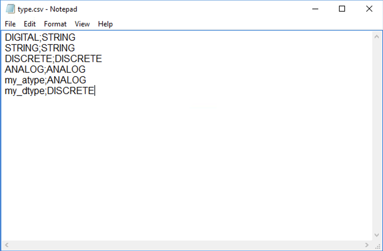

  • “Index query” - a query used by TrendMiner to ingest timeseries data for a specific tag. The query is expected to return a ts (timestamp) and a value. The following variables are available to be used in the WHERE clause of this query. The variables will be substituted at query execution with values. There should not be any NULL values returned by the SELECT statement so including "IS NOT NULL" in the WHERE clause is strongly recommended.
  • “Internal plotting” - if this option is selected TrendMiner will use interpolation if needed to plot the timeseries on the chart on specific time ranges. If this value is not selected and no plot query was provided, TrendMiner will plot directly from the index.
  • “Plot query” – a query used by TrendMiner to plot timeseries data for a specific tag. The query is expected to return a ts (timestamp) and a value. The following variables are available to be used in the WHERE clause of this query. The variables will be substituted at query execution with values. There should not be any NULL values returned by the SELECT statement so including "IS NOT NULL" in the WHERE clause is strongly recommended.
    • {STARTDATE}. TrendMiner will plot data per intervals of time. This denotes the start of such an interval.
    • {ENDDATE}. TrendMiner will plot data per intervals of time. This denotes the end of such an interval.
    1. customTypeA;ANALOG
    2. customTypeB;DIGITAL
    3. customTypeC;DISCRETE
    4. customTypeD;STRING

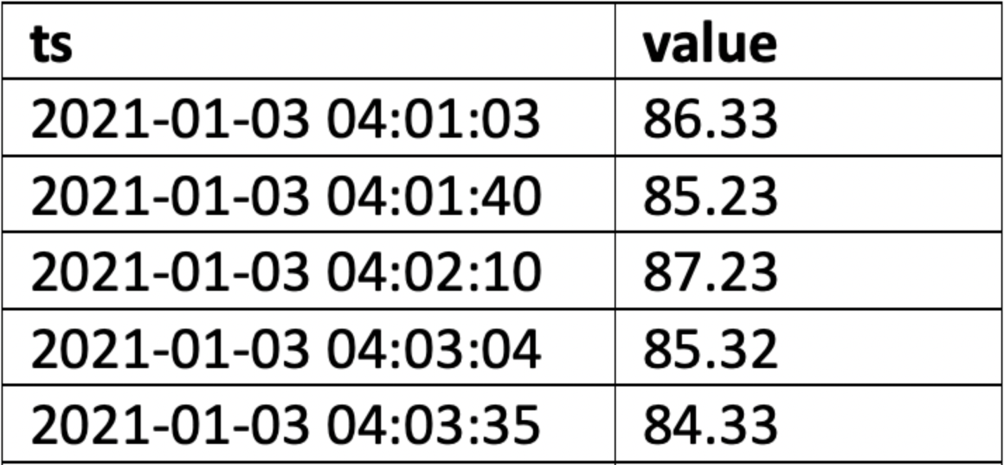

The index query this simple example selects the data based on the parameters {ID}, {STARTDATE}, and {ENDDATE}. TrendMiner will fill in these variables when sending the query to ADX. Note that this query does not perform any analytics optimization or interpolation. It will simply return all rows that match the conditions. Due to the data schema (the value was defined as string type), this query works for ANALOG, DIGITAL, and STRING tags.
Data
| where ts between (datetime('{STARTDATE}') .. datetime('{ENDDATE}'))
| where id == '{ID}'
| project ts, value| order by ts asc
The plot query will be the same as the index query in this simple example. Once again, all rows that match the conditions will be returned without any further processing.

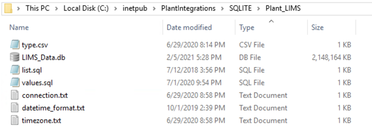

  1. First step is to browse to the Plant Integration folder you have created during installation. This folder will most likely reside inside the inetpub folder on the c drive of your connector server, which is the default location:
    c:/inetpub/PlantIntegrations
  2. Create a folder (not case sensitive) that will host all your ODBC/OLEDB/SQLite configuration files. All configuration files for ODBC connections will go into the ODBC folder, for OLEDB connections into the OLEDB folder and so on.
  3. Create a subfolder for each data source you want to configure inside the correct ODBC/OLEDB/SQLite folder, depending on which connection type you are using. In the following example we will configure an ODBC data source called “Plant_LIMS”, so we create the "Plant_LIMS" subfolder in the recently created "ODBC" folder.
Create Configuration files
  • Create the following configuration files needed to configure the generic data sources.
    For ODBC/OLEDB:
    For SQLite:
    File name and type
    Description
    Required / Optional
    sqlite.db (only for SQLite)
    Required
    connection.txt
    Required
    list.sql
    Required
    values.sql
    Required
    values-STRING.sql
    Query select statement that returns the timestamps and values for a given string tag. Only include if necessary. If any string tags are not in the same database, you could use the query here or decide to join with your values.sql query.
    Optional
    type.csv
    Required
    datetime_format.txt
    Optional
    timezone.txt
    Optional
Connection.txt file
ODBC example:
OLEDB example:
SQLite example:

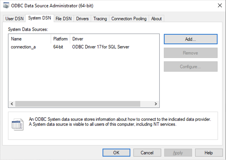

  1. Set up a new System Data Source using the corresponding SQL Server driver.
  2. Once the System Data Source is configured, create a “connection.txt” file and make reference to the System Data Source as shown below.
https://docs.microsoft.com/en-us/sql/integration-services/import-export-data/connect-to-an-odbc-data-source-sql-server-import-and-export-wizard?view=sql-server-ver15#odbc_connstring

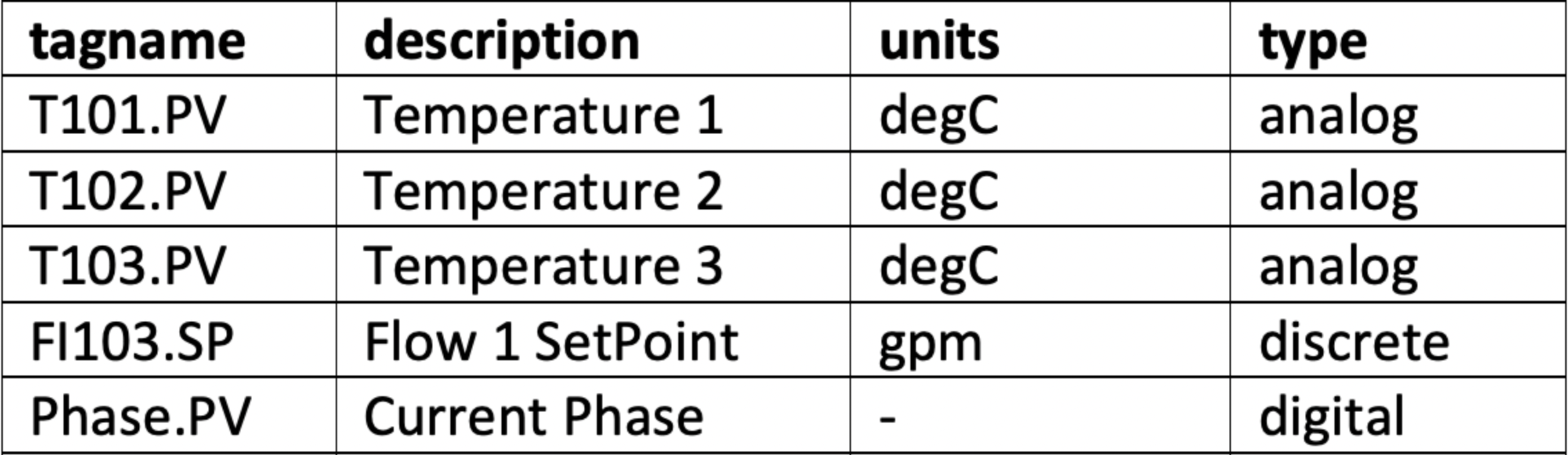

list.sql query
SELECT
    tagname, description, units, "analog" as type
FROM Table_1

type.csv mapping
In the type.csv file, create one line per data type, with the output of the list.sql types as the first value, followed by a semicolon (";"), followed by one of the supported datatypes in TrendMiner. The example below ensures the results are returned in the right case, and a DIGITAL result is explicitly returned as a STRING result.
Without timezone (UTC)
MM/dd/yyy HH:mm
DDMMYYY HH:mm:ss

  • The “Host” name will be the name of the folder previously created containing all the configuration files as in the example below. The data source name is free to choose.
  • TrendMiner will consider the username and password provided in the “connection.txt” file and not the one provided through the interface. You do not need to provide the username and password here.

To add an AWS IoT SiteWise data source, in ConfigHub go to Data in the left side menu, then Data sources, choose + Add data source.
Fill out 'Data source details' on the first step of the datasource creation wizard: type name of data source, select “AWS IoT SiteWise” from the Provider dropdown.
  1. Connection details – lists properties related to the configuration of the connection that will be established with AWS IoT SiteWise

Asset capability
With this capability enabled the datasource can pull assets from AWS IoT SiteWise to be synced into a TrendMiner asset structure.
Following properties need to be populated:

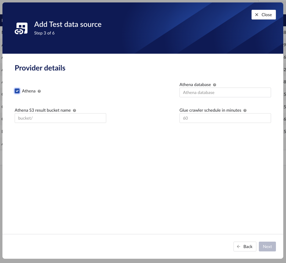

  • “Athena”
    • if the Athena option is not enabled, the provider will ingest hot tier data only, using the AWS IoT SiteWise REST API.
    • if the Athena option is enabled the provider will ingest also cold tier data using Athena queries.
  • “Athena database” - the name of the Athena database. For more information, please consult the AWS documentation.
  • “Athena S3 result bucket name” - Athena query results are stored after execution in a S3 result bucket. Specify here the name of the bucket. For more information, please consult the AWS documentation.
  • “Glue crawler schedule in minutes” - value of Glue crawler interval in minutes. For more information, please consult AWS documentation.

Context capability
With this capability enabled the datasource can sync Alarms from IoT SiteWise into TrendMiner context items.

  • "Region" – enter the availability zone region within AWS cloud in which the AWS IoT SiteWise instance is configured. For more information, please consult the AWS documentation.
  • "AWS access key" – enter the access key to authenticate. The AWS access key as generated in AWS IAM. For more information, please consult the AWS documentation.
  • "AWS Secret" – enter the secret to authenticate. The AWS secret as generated in AWS IAM. For more information, please consult the AWS documentation.

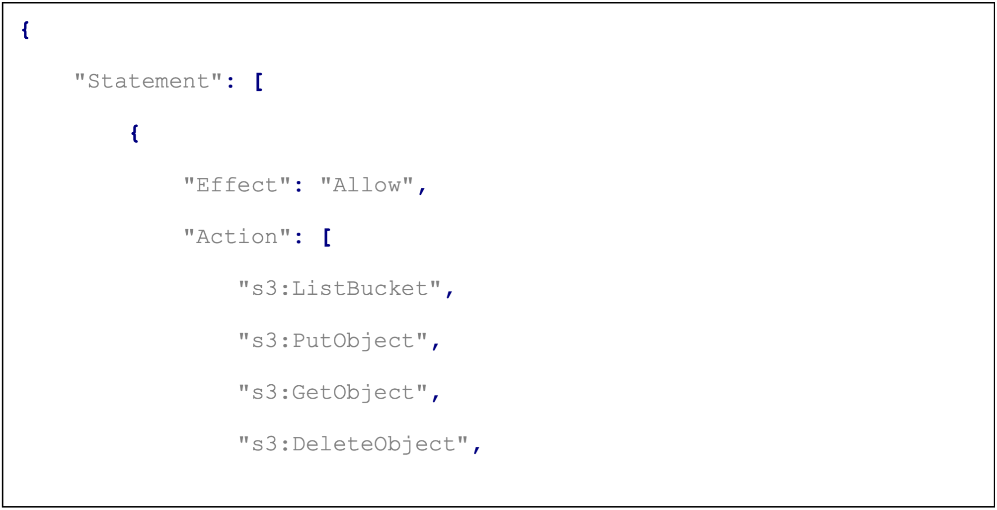

    • The creation of the role needs the following policies. Pay attention at the bucket name: "arn:aws:s3:::trendminer"
    • Refer to the AWS documentation on configuring storage settings.

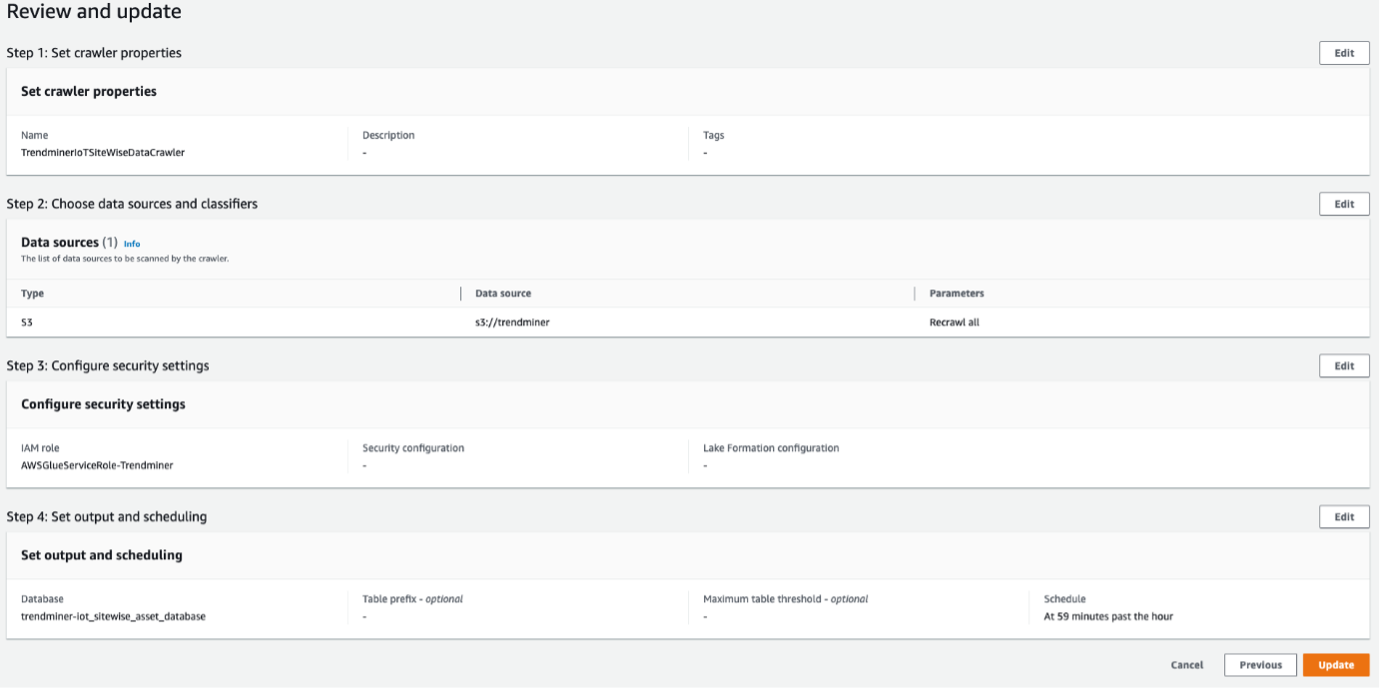

  4. Configuring a crawler:
    • Example configuration.
    • Once the configuration is done, you need to manually Run the crawler. This process might take several minutes, so you should wait until the state becomes Ready.
    • You can refer to the AWS Documentation on creating a Glue crawler.

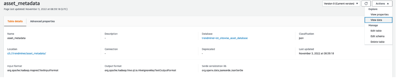

  5. Once your crawler status is Ready, you can query your data:
    • In the navigation pane Data Catalog → Databases → Tables → asset_metadata table of your database and click on the Table data link (more information on how crawlers work - here).
    • Select the table and continue.
    • A confirmation pop-up appears. By clicking Proceed you will be automatically redirected to AWS Athena.

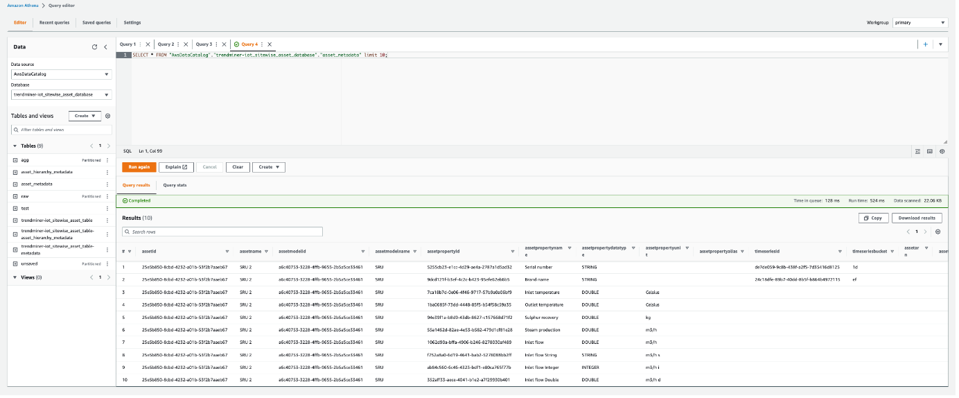

  6. Once your crawler runs successfully, you are redirected to AWS Athena:
    • Provide a configuration about the Query result location.
    • Provide your S3 bucket location.
    • A query can be executed now.
    • Refer to the AWS Documentation on how to query data with Athena.

Asset capability

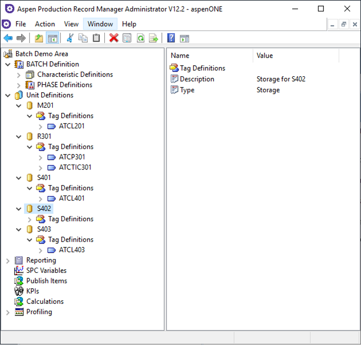

Our provider for Aspen Production Record Manager implements the asset capability and uses data from the area definition to populate the asset hierarchy in TrendMiner. The root node of the asset hierarchy is the area itself. The children nodes of an area node are created using “Unit Definitions". The “Tag Definitions“ are the children of the unit nodes, and the leaf nodes of the asset hierarchy. The asset hierarchy has a fixed depth of two or three.
Area, Unit and Tag Definitions in Aspen Production Record Manager Administrator
Asset hierarchy in TrendMiner

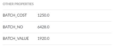

The provider generates Context Item properties based on the numeric Characteristics that are available on the subbatches of Aspen Production Record Manager. Only the numeric characteristics are included as Context Item properties, this is by design.
Since numeric characteristics are decimal values in Aspen Production Record Manager, Context Items properties are also formatted decimal numbers.
Context item properties
The Start Time, Duration and End Time Characteristics are available as Events. The existence of characteristics and the level on which they are defined is completely dependent on the configuration of the Subbatch Definition implemented on the customer environment.

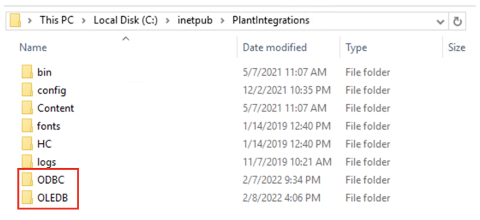

AtBatch21ApplicationInterface
Plant Integrations must be configured to run under an identity that has access to Aspen Production Record Manager. This user must be a member of the 'Distributed COM Users ’group on Aspen Production Record Manager server.

In ConfigHub go to Data in the left side menu, then Data sources, choose + Add data source. Fill out 'Data source details' on the first step of datasource creation wizard: type the name of a data source, select “Aspen Production Record Manager (via SDK)" from Provider dropdown, then select the configured connector from Connect via dropdown.
Connection details
To establish a connection 2 optional properties to be filled in:
Property
Description
Username
Optional convenience field to enter the username used to establish a database connection. As an alternative this information can be entered through the driver properties.
Password
Optional convenience field to enter the password used to establish a database connection. As an alternative this information can be entered through the driver properties.
Connection details step in datasource creation wizard

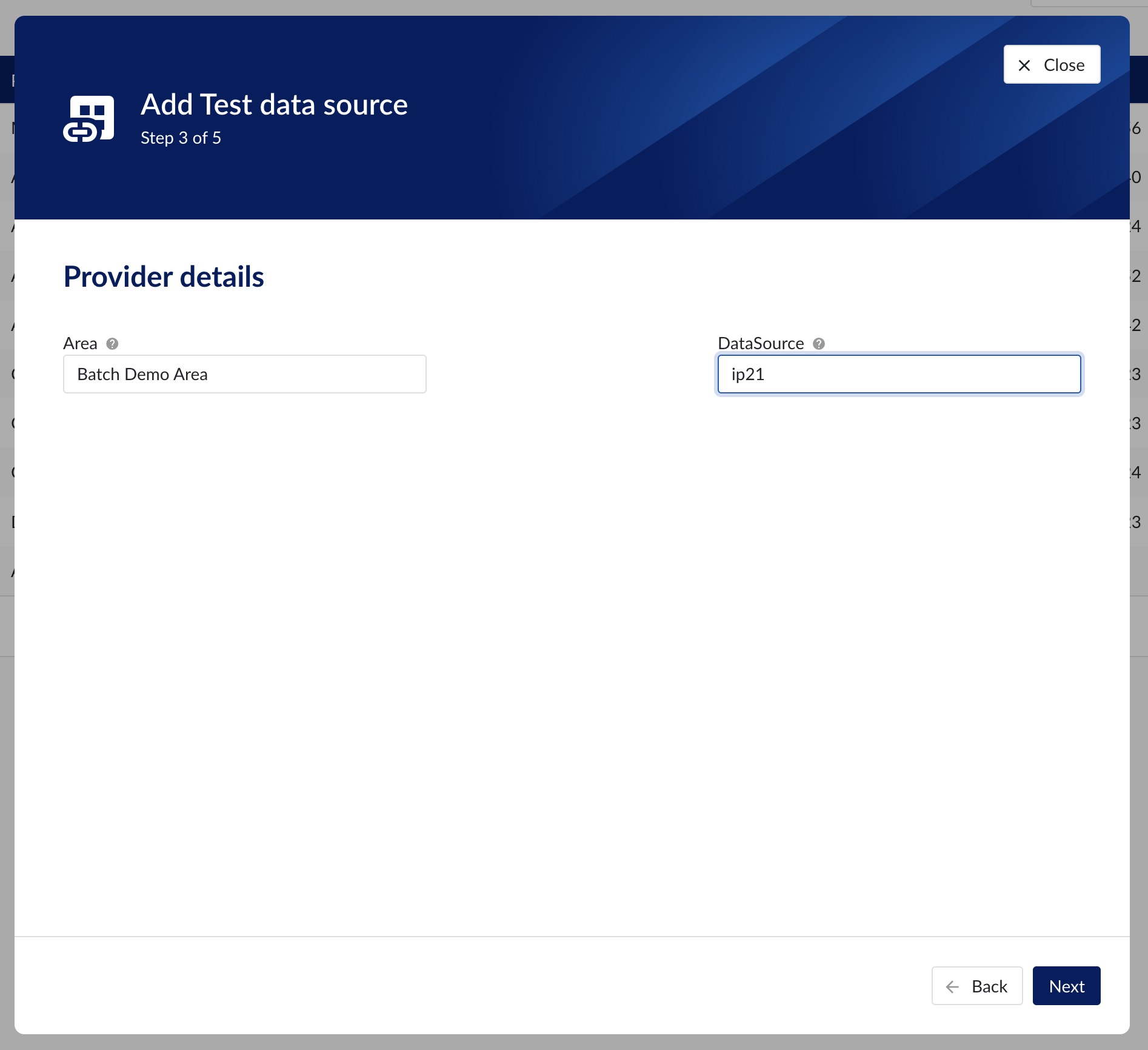

Provider details
The APRM provider implements both assets and context capability. These capabilities have two required provider properties to be filled in:
Property
Description
Area
The name of the area inside the specified DataSource where the provider reads its data.
DataSource
The data source used by this provider. The AspenTech Production Record Manager can store multiple data sources on one server instance.
Provider details step in datasource creation wizard

How to set up a Generic JDBC data source?
Creating Generic JDBC provider
To integrate with and ingest data from a database that supports JDBC, a datasource of provider type Generic JDBC can be added and configured in ConfigHub.
To add a Generic JDBC data source, in ConfigHub go to Data in the left side menu, then Data sources, choose + Add data source. Fill out 'Data source details' on the first step of the datasource creation wizard: type the name of the data source, select “Generic JDBC” from the Provider dropdown. Selecting the capabilities for the data source with the given checkboxes will open additional properties to enter, grouped in following sections:
  • Provider details - lists properties shared by multiple capabilities
Following properties need to be populated to establish the connection to the JDBC provider:
  • "Provider" - select the option "Generic JDBC" from the dropdown.
  • "Capabilities" - the Generic JDBC provider supports the Time series, Asset and Context capabilities.
  • "JDBC url" - a mandatory JDBC url to establish a connection to.
  • "Driver properties" - additional  optional driver specific properties can be configured here as key;value, where key is the name of driver specific property and value the desired value for this property. Please consult the documentation of the specific JDBC driver for more information.
  • "Username" - optional convenience field to enter the username used to establish a database connection. As an alternative this information can be entered through the driver properties.
  • "Password" - optional convenience field to enter the password used to establish a database connection. As an alternative this information can be entered through the driver properties.

Following properties need to be entered to enable time series capability:

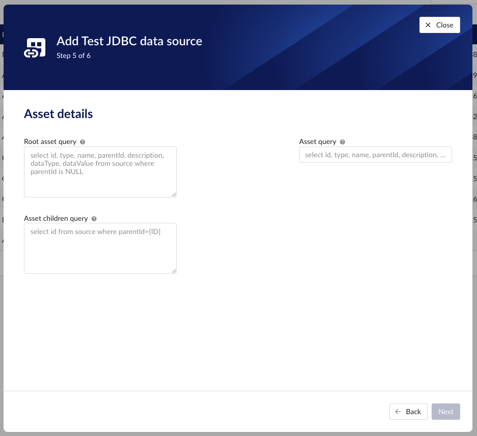

  • "Root asset query" - this query is responsible for returning all top level elements from the asset tree structure. It will be used to traverse further down the tree using to queries below. The order of the columns in the result needs to be:
    • id. Required, unique identifier for this asset record.
    • type. Required, TrendMiner can handle asset of type ASSET or ATTRIBUTE. This column must be one of these two values.
    • name. Required, name for this asset record.
    • description. Optional, description for this asset record.
    • data type. Optional, TrendMiner can ingest 4 different types of data in case the asset is of type ATTRIBUTE. This column will impact on how the data value column will be interpreted:
      • STRING data value is interpreted as text
      • STRING_ARRAY comma delimited string
      • NUMERIC
      • DATA_REFERENCE
    • data value. Optional, this column will either be interpreted as text (STRING), a collection of text (STRING_ARRAY), a number (NUMERIC), or a reference to a tag (DATA_REFERENCE).
  • "Asset query" - this query returns details for a specific asset record. The following variables are available to be used in the where clause of this query. The variables will be substituted at query execution with values:
    • {ID}. The id as the unique asset identification.
      • NUMERIC
      • DATA_REFERENCE
  • "Asset children query" - this query returns the ids of the direct descendants of the asset. The id passed is the parent, the records returned are its child nodes.  The following variables are available to be used in the where clause of this query. The variables will be substituted at query execution with values:
Following properties need to be entered to enable context capability:
  • "Events query" - this query is responsible for returning events from the source database. Context items will be generated based on these events. {AFTER} and {BEFORE} placeholders can be used in the query. They will be replaced with values received in the API call. Additional Event fields query will be executed to populate custom field values for a specific event. The order of the columns in the result needs to be:
    • id. Required, unique identifier for this event record.
    • name. Required, name for this event record.
    • type. Required, event type id. Full information about event type will be fetched in Type by id query.
    • occurred_at. Required, timestamp when the event has occurred.
    • modified_at. Required,  timestamp when the event was modified.
    • components. Required, list of component (asset) ids separated by the Delimiter (',' by default).
    • state. Optional, state for this event record.
    • description. Optional, description for this event record.
    • keywords. Optional, list of keywords separated by the Delimiter (',' by default).
  • "Event by id query" - this query is responsible for returning a specific event from the source database. {ID} placeholder can be used in the query. It will be replaced with the value received in the API call.  Additional Event fields query will be executed to populate custom field values for specific event. The order of the columns in the result needs to be:
    • occured_at. Required, timestamp when the event has occurred.
  • "Types query" - this query is responsible for returning a list of possible event types from the source database. The order of the columns in the result needs to be:
    • color. Optional, color for this event type record. It will be used in the Gantt chart view of the ContextHub.
    • startstate. Optional, name of the start state.
    • endstate. Optional, name of the end state.
    • states. Optional, list of possible states separated by the Delimiter (',' by default).
    • fields. Optional, list of custom field definition ids for this event record separated by the Delimiter (',' by default).
  • "Type by id query" - this query is responsible for returning an event type from the source database. {ID} placeholder can be used in the query. It will be replaced with the value received in the API call. The order of the columns in the result needs to be:
    • name. Required, unique identifier for this event record.
  • "Fields query" - this query is responsible for returning a list of possible custom fields from the source database. The order of the columns in the result needs to be:
    • id. Required, unique identifier for this field record.
    • name. Required, name for this field record.
    • type. Required, possible values:
      • STRING
      • NUMERIC
      • ENUMERATION
    • placeholder. Optional, placeholder will be displayed in the ContextHub event creation form.
    • options. Optional, if type is ENUMERATION this value is required. A list of possible values separated by the Delimiter (',' by default).
  • "Field by id query" - this query is responsible for returning a custom field from the source database. {ID} placeholder can be used in the query. It will be replaced with the value received in the API call.  The order of the columns in the result needs to be:
      • STRING
      • NUMERIC
      • ENUMERATION
  • "Event fields query" - this query is responsible for returning custom field values for specific event. {ID} placeholder can be used in the query. It represents an event id and will be replaced with the value received in the API call.  The order of the columns in the result needs to be:
    • fieldId. Required, unique identifier of custom field definition (provided in the Fields query).
    • value. Required, field value.
  • "Events Sort column" - column name that will be used for sorting and paging of the events. If value is not  set, "id” column will be used by default.
  • "Events sort column DataType"  - the data type of Events sort column. Possible values are: Text, Numeric, DateTime. If value is not set, 'Text' value will be used by default.
  • "Events id column DataType"  - the data type of Events id column (used in Event by id query). Possible values are: Text, Numeric, DateTime. If value is not set, 'Text' value will be used by default.

Index query
select ts, value from source where id={ID} and ts between TO_TIMESTAMP({STARTDATE}, 'YYYY/MM/DD HH24:MI:SS') and TO_TIMESTAMP({ENDDATE}, 'YYYY/MM/DD HH24:MI:SS') and value IS NOT NULL order by ts asc
