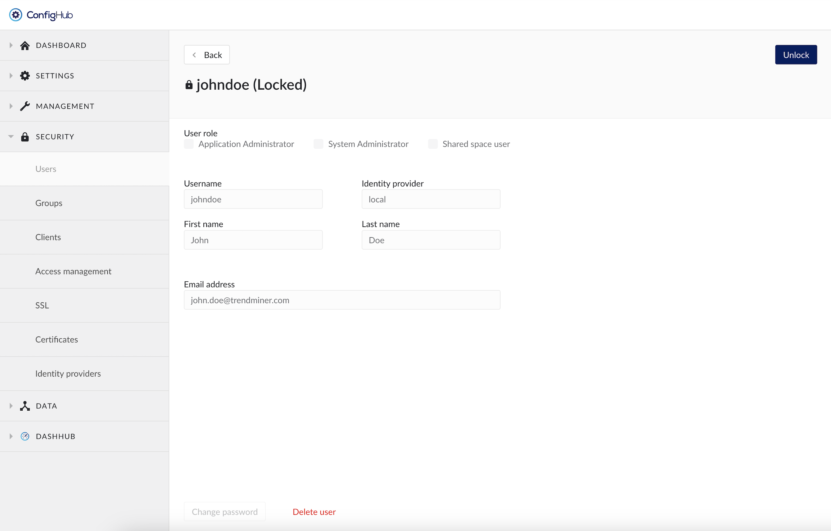

Unlock user account
A user account is automatically locked after 10 login attempts using the wrong password. The user itself will not be able to see the difference between entering a wrong password or the access being denied because of a locked account. In both cases a generic error message is shown on the login page: "Invalid username, password or locked account". This is by design for security reasons.
Only users with the system administrator role can access ConfigHub and look up the user account to check if the account is indeed locked. A locked account can be recognised as follows:
A little lock icon in front and the word "Locked" behind the username
An "Unlock" button in the top right
No option to edit the user details or change the password as long as the account is locked
To unlock a user account simply click the "Unlock" button on the top right.
