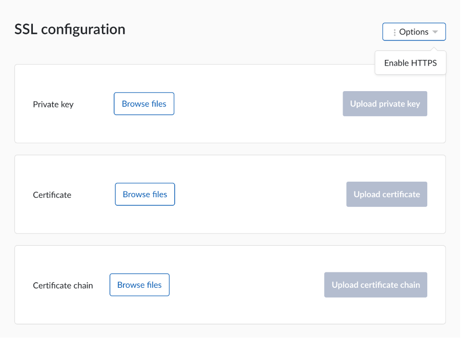

How to enable SSL in TrendMiner?
Private key
Certificate
Certificate chain
Typically, your IT department will be able to provide these. A (temporary) solution to create a certificate is offered in the next section, but make sure to align with your IT department first.

Once these prerequisites are fulfilled, browse to the Edge Manager > Security > SSL menu to upload them. After uploading, HTTPS can be enabled via the "Options" menu on the top right.
