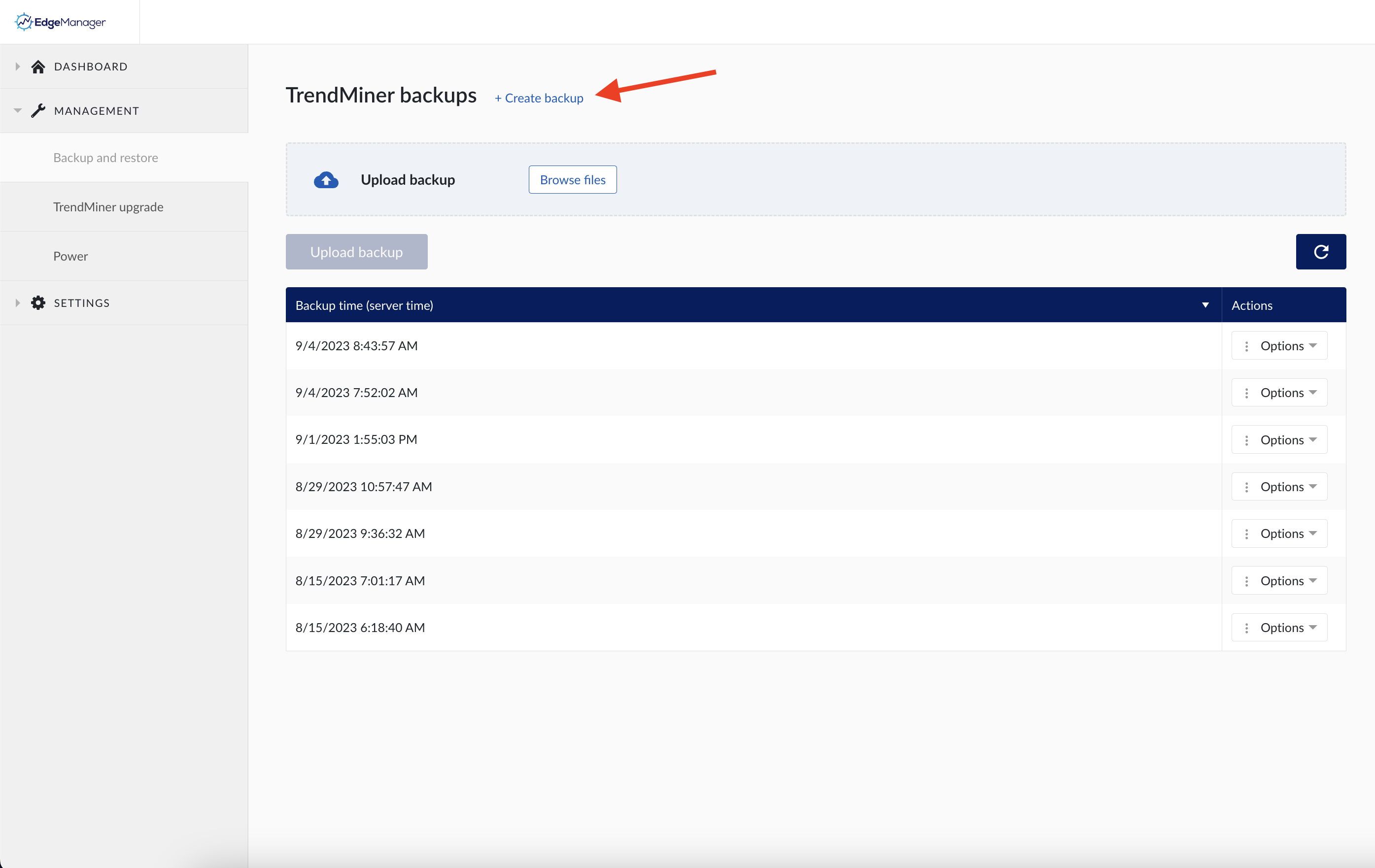

During a TrendMiner upgrade a backup is automatically created. This backup process can take a significant amount of time that adds to the overall downtime. To reduce this, the admin can take a manual backup first before launching an upgrade and choose to disable the automatic backup creation during the upgrade.
edge_manager_create_backup

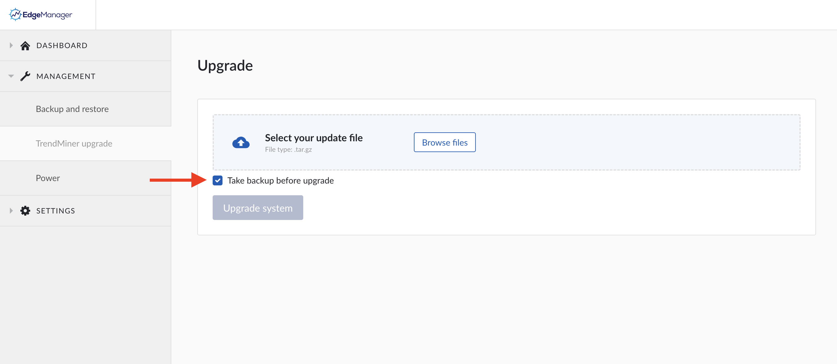

Uncheck the "Take backup before upgrade" checkbox when upgrading TrendMiner:
edge_manager_take_backup_before_upgrade-2023.R3.0
